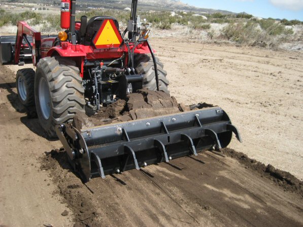

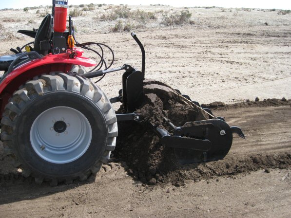

So in your opinion, a tractor that is 68" wide, weighs in at 4000+lbs with a loader, without ballast, should only use a 60" BB? You can stop a tractor in it's tracks with just about any box blade if the conditions are right and you don't pay attention. I have a Mahindra 3215HST, so smaller than the 3020series tractors, actually about the size of the 3000e series tractors and it handles an 800lb, 66" wide box with no problems at all. But then maybe it is just my conditions?? :confused3:
I still think that I nice medium duty 60" BB would be the way to go for a 2000 R series machine. I know of people that have 48" units and are not happy with them, just to small.
Just my :2cents:
