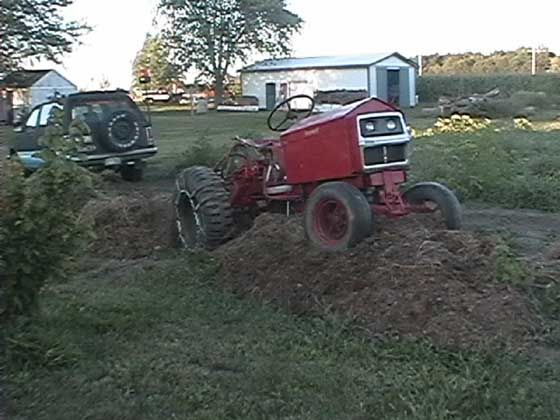

If you mean mine...
It started life out as a rear blade and when I get round to finishing the wings,it will be again..back and forth as I please.Not shown is the way I made it tilt...That comes in REAL handy when cuttin' swales!!
As far as dimensions....LOL!!
I don't even know if I own a measurin' stick..Really all you need to do is make it a cloupla inches wider than your tractor...I'm not sure how wide the tractor is either...6 feets??
Here's a shot of the time I got her gaught up in a pile of manure I was spreading...

Those tires look like they came off of my 6x6 duece. Where did ya get the chains?
Mike
   / Box Blade #8
Those are indeed from a 6 X 6!!
Fella sold me the pair on wheels for $40.
The bar chains are just some 1/2 x 1 bar,bent and welded to 3/16 chain.
