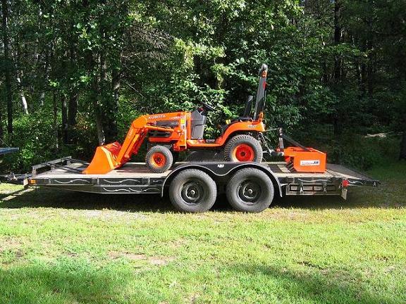

I've been real happy with my "cheapy" King Kutter. It has enough, but not too much, weight for my small tractor. Scarfers work good and quality was adequate for what it does.
