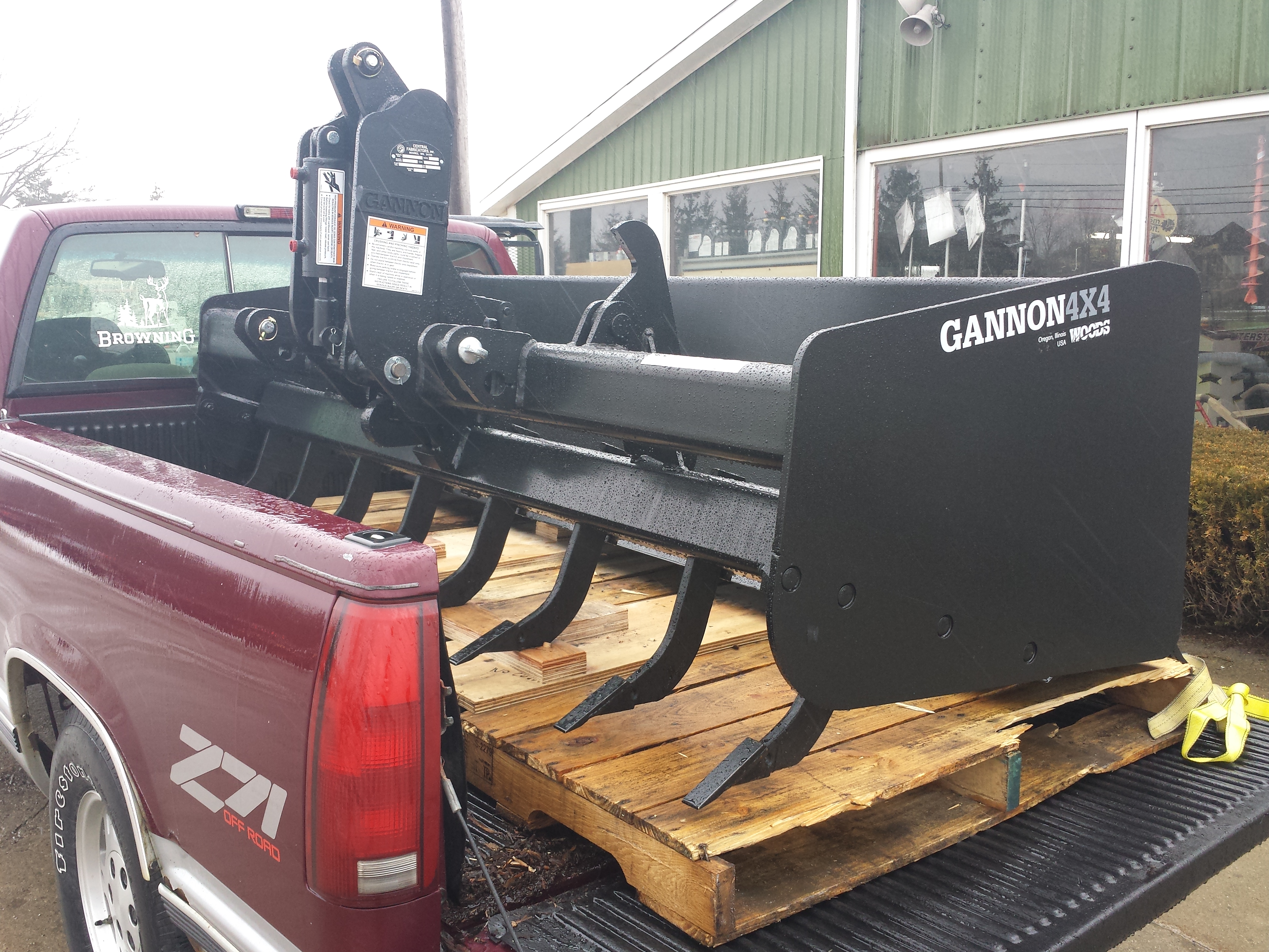

   / Box blade #7
You can always lift every other scarfier shank one notch and double your point load. My 88" gannon hsd is industrial grade weighs 1300lbs and wont pierce a clay road bed with all the shanks down

   / Box blade #9
Dave - its hard to tell whats bigger - your box blade or the pickup. That is one massive unit. I know what you mean about a road bed when it dries out and becomes concrete. I've got one section of driveway where wind blown volcanic ash has combined with the road material and its a real bugger later in the summer.
