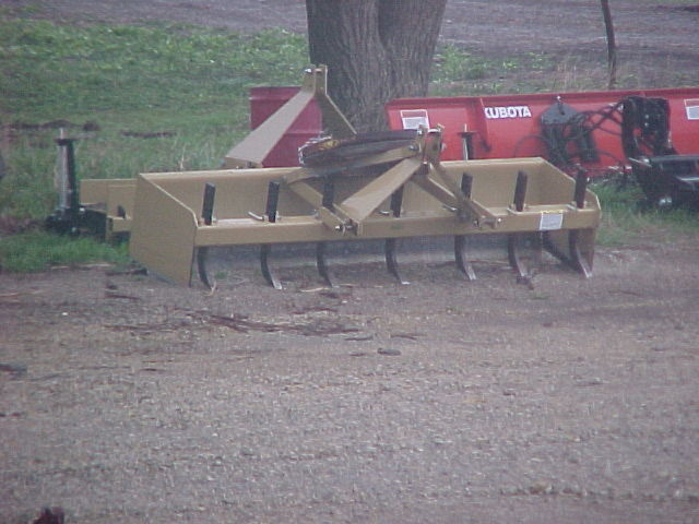

I used rear wheel tractor (ag) weights. Chained them to the center. It is raining so I do have a lond distance pic, look hard.

   / Box Blade weights #7
Jerry, Could you tell a difference when you added weight?
The angle of the shanks or cutting edge should pull the scraper in regardless of weight.
Chuck
   / Box Blade weights #8
It made all the difference in the work. In hard packed soil and with our high density of rocks it didn't want to cut any without the weight.
