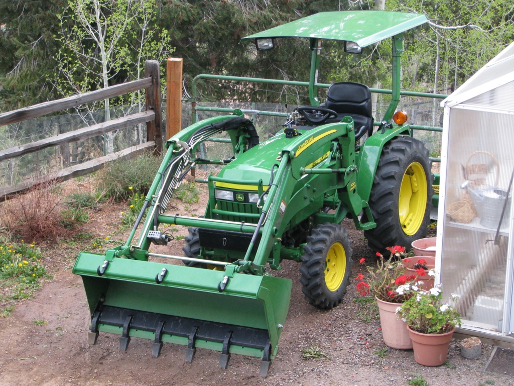

I have a toothbar that I rarely use because it doesn't do much in the granite where I live and I need to remove the cutting edge to put it on. I have tied it to the back of my box blade and it makes a remarkable difference. Here is a picture of it on the bucket, I don't have one of it on the BB. I don't know how much it weights but it is all I can lift.

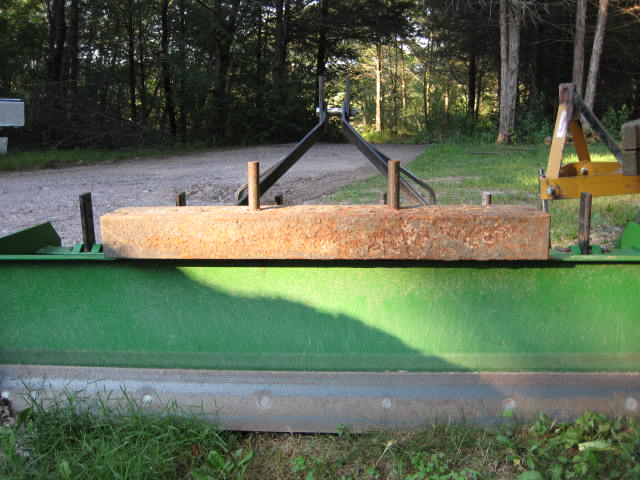

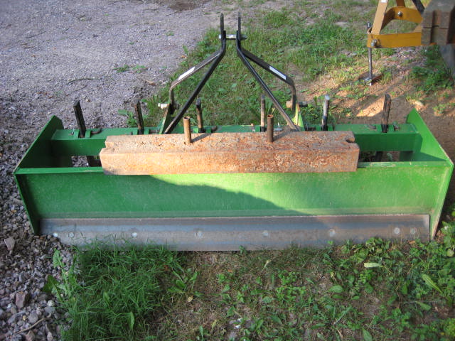

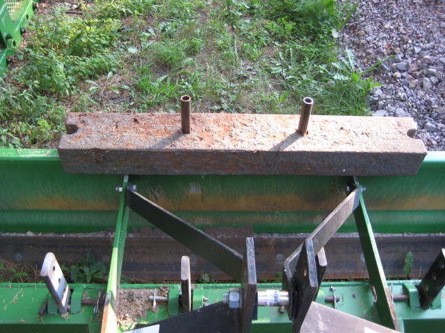

Have a 54 inch box blade. Added a 54 inch long piece of I-beam. Drilled two holes in the top, drilled matching holes in the top rear frame of the BB, hung the I-beam on it and dropped two bolts through the holes. Don't know for sure how much the I-beam weighs. I'm guessing 150 lbs or so since the wife and I can pick it up and move it around with some difficulty. I have tried the BB both with and without the added weight. Works much better with the weight, but I have to be careful lowing the 3pt. With the added weight, it drops real fast if I'm not careful.

I have some old elevator weights that have been laying around for years and now have a use for them. about 275# I saw what I thought was another great idea on another post, on here somewhere. They used weight from a weight set. If you can find someones old cast iron weights at a garage sale and stack them on your BB
