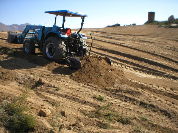

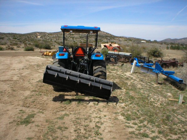

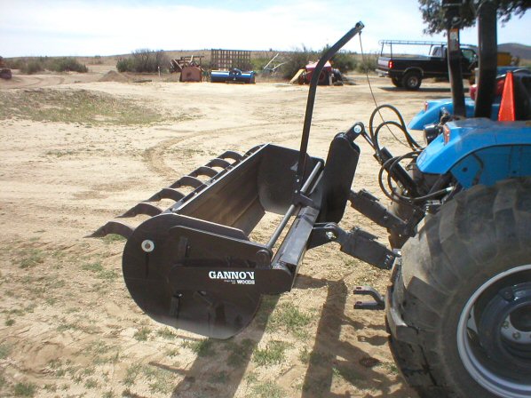

The roll over box blades are very useful as others have said. I have several of them, and am quite happy with them. I think that they were originally designed to be able to do all that they can do without the use of hydraulics. The roll over design has been around long before rear remotes were as common as they are today. With today's use of hydraulics to lower rippers and "TnT" to adjust the box blade, I'm not real sure that there is any real advantage to having a roll over anymore. Yes the roll over will push a larger load backwards, but at the same time because of that ability you cannot back fill as close to a wall when needed. The roll over box blades are built similar in strength and weight to heavy duty box blades, but there are box blades that are by far stronger and heaver than the roll over box blades and you pay for that.
Just how I see things regarding this subject. Oh, here are a few pics, sorry no video. ;)
