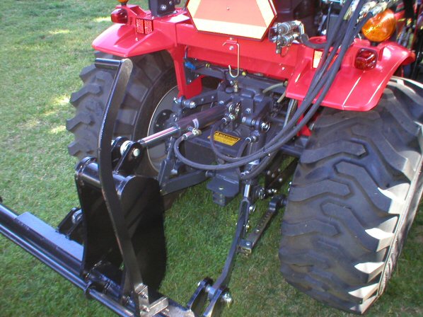

Top and Tilt is replacing the the top adjustable link and side adjustable link of the 3PH with a Hydraulic Cylinders. Read this thread and it will clear it up for you.
http://www.tractorbynet.com/forums/owning-operating/162185-how-many-tnt-owners.html
   / Box Blade Uses #9
There is a lot of good info here-thanks to those that responded to my questions. From a link given, I can't seem to find what the term top& tilt means or how it works. Do the box blades not come with an adjustment for offsetting?
Top and Tilt ( "TnT" ) are hydraulic cylinders used for the top link and a side link of the 3pt hitch. (usually the right side link) These links that come from the factory are manually adjusted and therefore sort of a pain. By replacing them with hydraulics, they are easily adjusted and can make for a better grading job just because you adjust easily as needed. Once you have operated an implement that benefits from these, you will be hard pressed to go back to the manual adjusted ones.
As far as offsetting, I have only seen this on rear blades and landscape rakes. No box blades as far as I know of.
