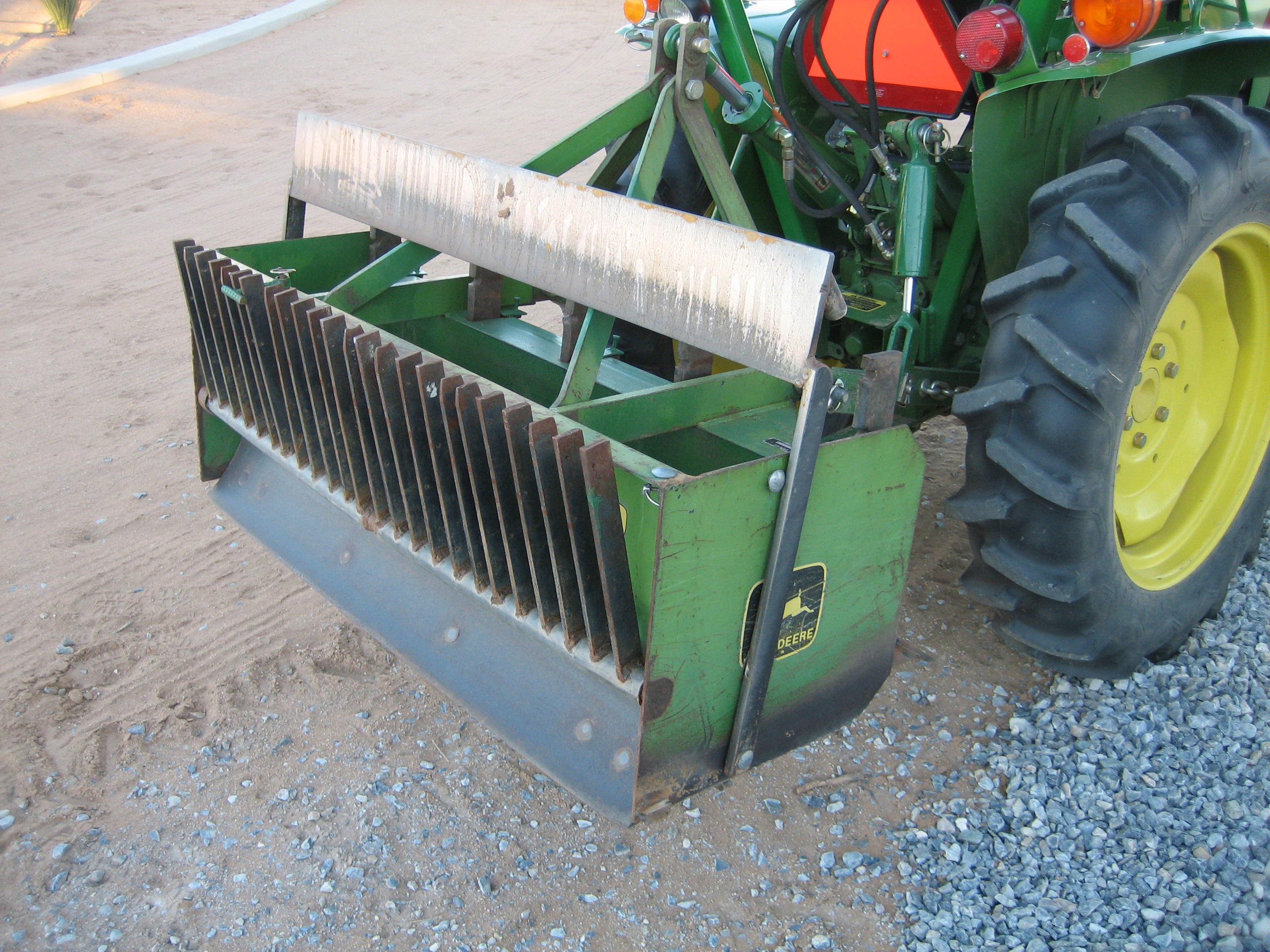

Does anyone have a cure for box blade slober. That is what I call it when you are trying to finish grade and leave a small trail of dirt on each side of blade with minimal dirt in the box. :confused: Currently I just go over it with the box tilted back to take care of each row and that is time and money.:mad: Maybe just a piece of chin link fence will cure it.

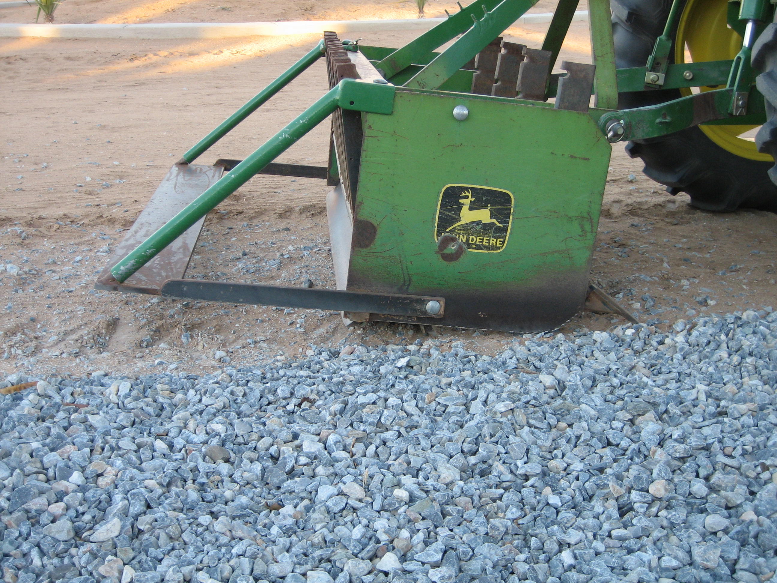

Don't know if you can see or not but the front and rear blade are about an inch below the box. That works good for cutting but try to finish then it just slobbers all over. Of course the soil here is like sand when dry hence the sand flost attachment on the back of box. If I didn't have that then nothing would be smooth. It folds up out of the way when not needed. I was thinking about attaching something to the float on both sides so I could fold them in when not needed.

I think I see your issue. The added float is at a non-optimal angle. The box in smoothing mode should be nose high, but just a touch. Your picture where the "float" is touching, shows the box tipped too sharply up in the front. Go over to a flat smooth level driveway. Now lower the box down so the back blade (no the float) is just touching the ground. Adjust the top link so the nose of the box is just 3/4" higher than the back.
You may need to adjust the float to work with the box in that configuration. I do like your float idea. If you're interested, here's some suggestions for improvements.
Make the top bars into springs to push the float down.
or
Remove the top bars, make the float heavier and allow it to just freely drag behind. You can put a hook or pin to hold it up.
good luck!
jb

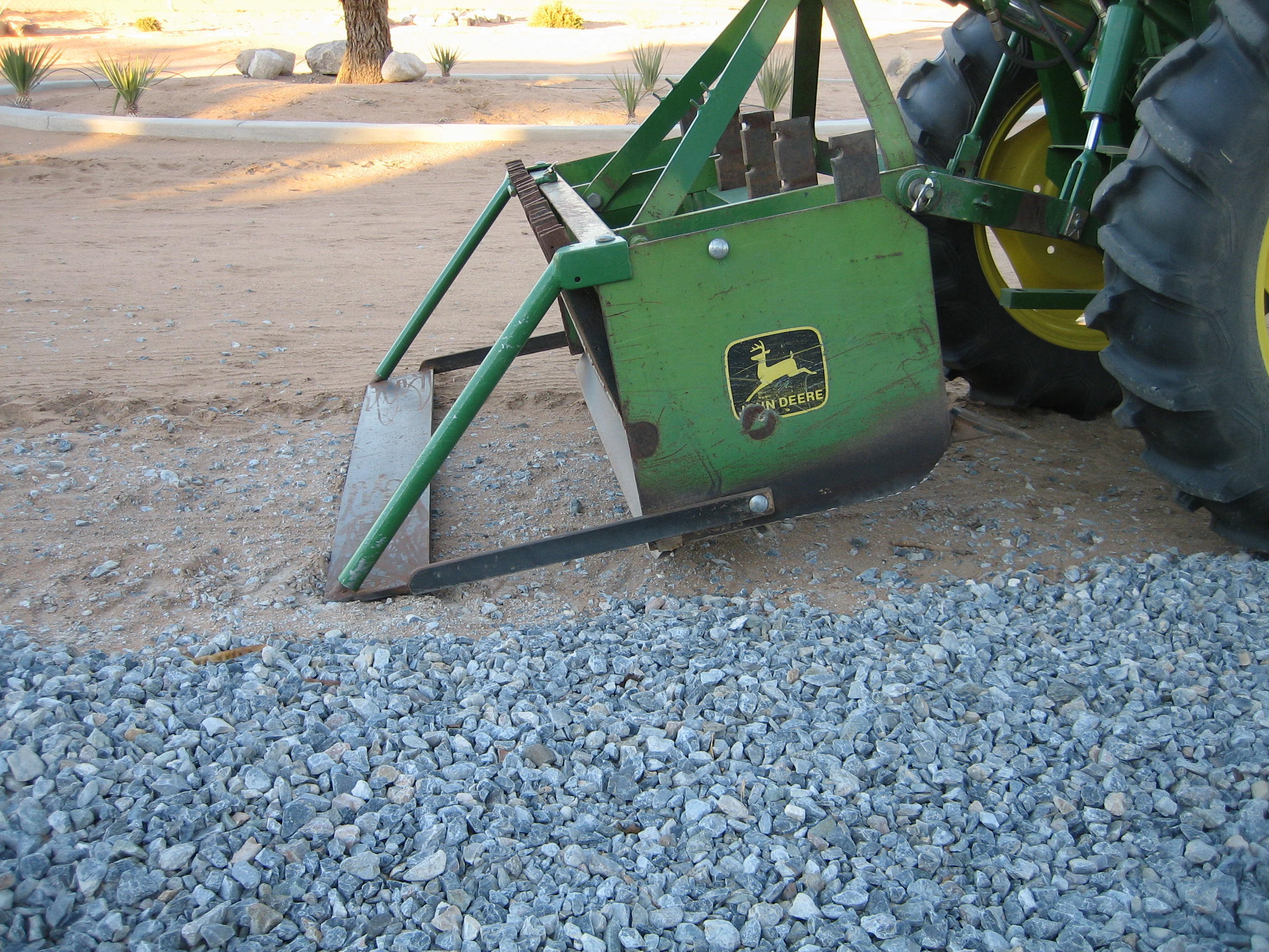

John, the picture above were taken some time ago and they were only to show the extremes of my T&T. I have done everything about adjusting it but it still slobbers especially when it is dry. When I have a full box or when I am finish grading I am at neutral blade position or a slight bit up on the front blade. This leaves the sides of the box about 1 inch off the ground which = slobber, even if the box is not full. To resolve this I think I will make some adjustable side plate extensions. The float is rigid to the box so that I can finsh grade in very dry soft soil. If it wasn't there the box would bury itself even tilted back as far as it could go on the back blade.
Attached is a picture of the float in storage position.

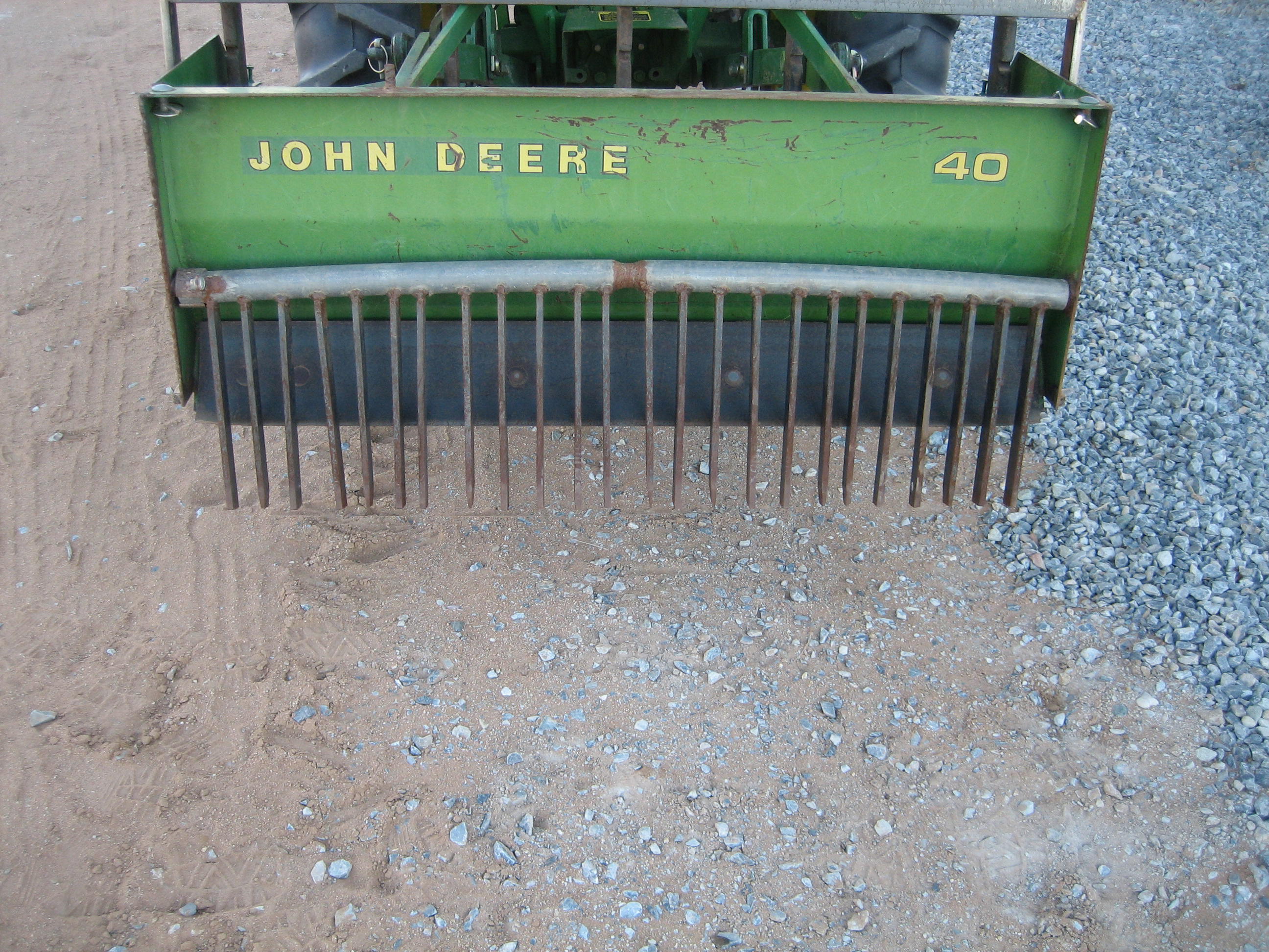

What are the verticle rods on the back of the box? Is that a mod to make it a mulch fork?

John, Think of it as guage wheels. It works on the same principle. I just didn't have any wheels and I needed more surface area in the sand.
Those vertical things are attached to a common shaft and I use it for grubing shall brush and moving things that I don't want the dirt to go with it. The picture below shows the rake in the operational position. It can also be put inside the box blade if you get a sore neck looking back and also has a swing up storage position. :D Both these tools add weight to the box for better performance and are operational in less that 30 seconds.
