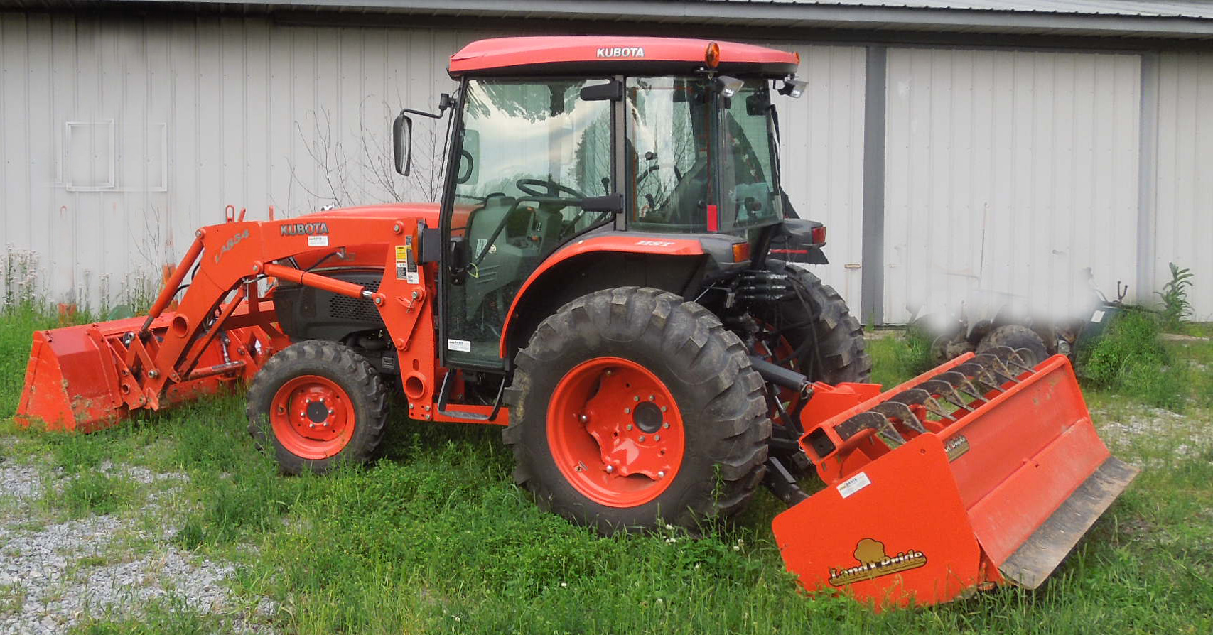

I agree, I use a Land Pride HR3584 on my Kubota L5740 HSTC as well as M8540 and it works well with both. I'd prefer one a bit bigger and heavier on the M8540, but $$$$$
Prior to buying the HR3584, I used a BB2584.

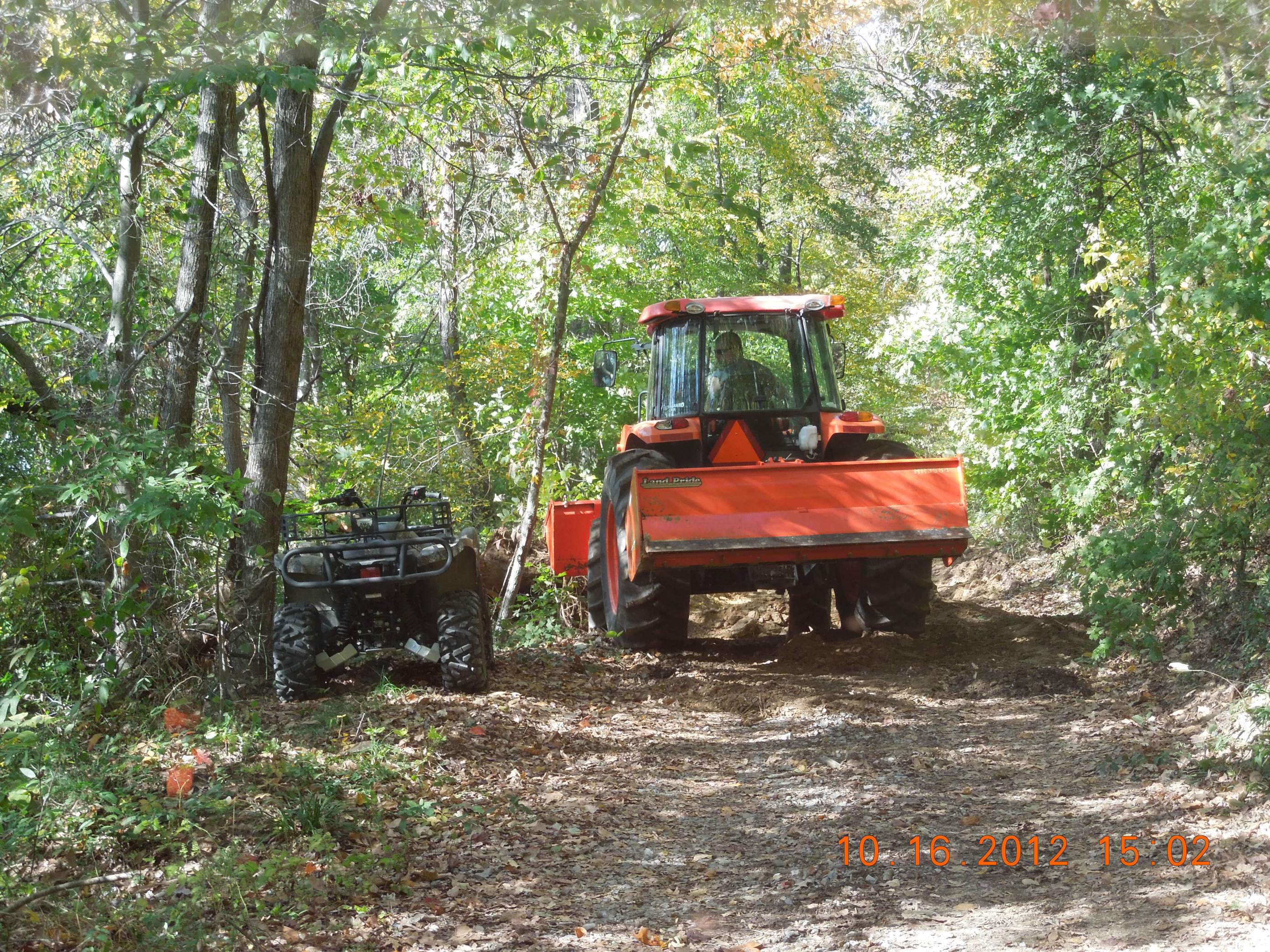

I like a regular box scraper, but some prefer a roll over box scraper. I have no experience with the roll over.

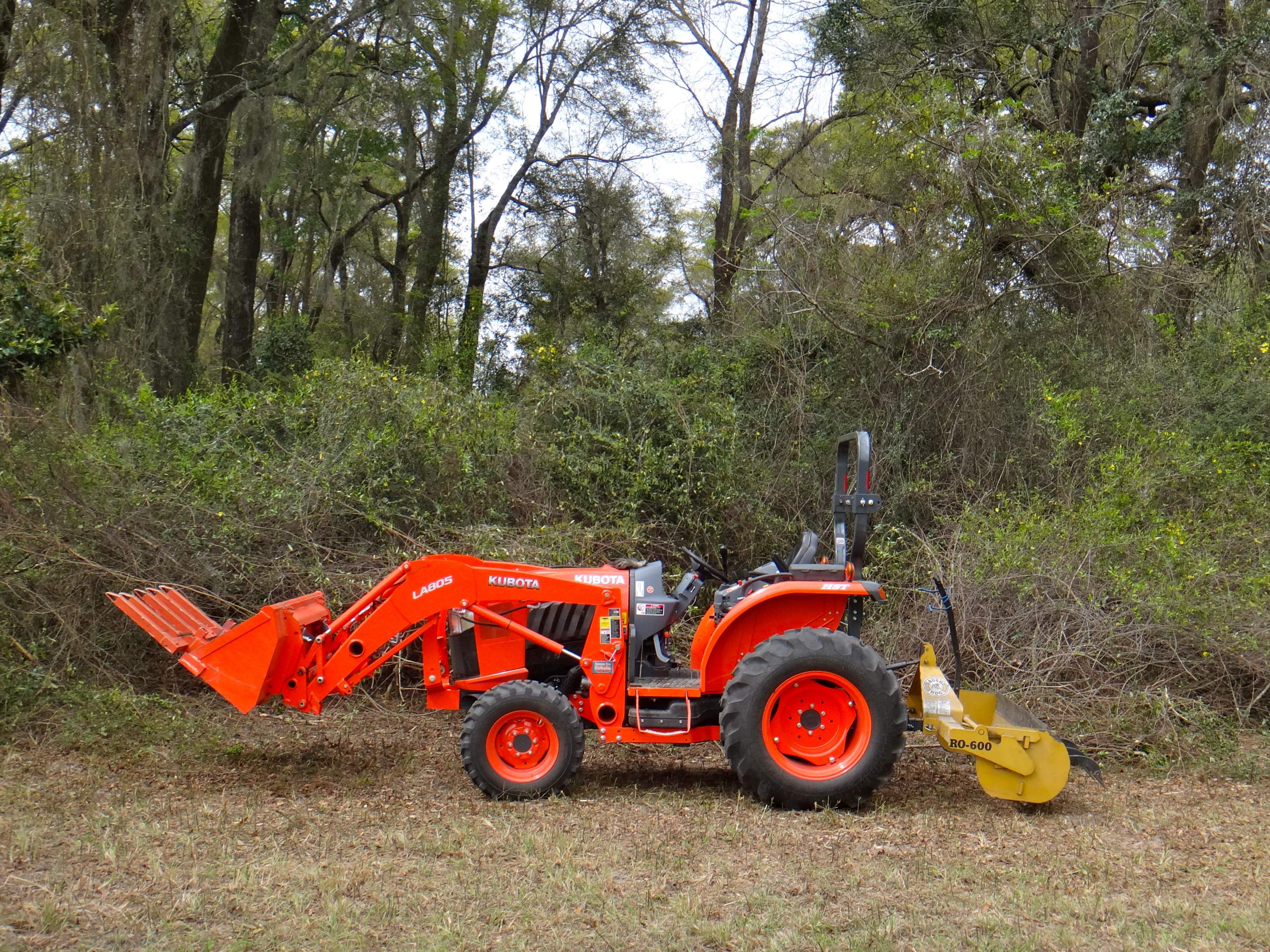

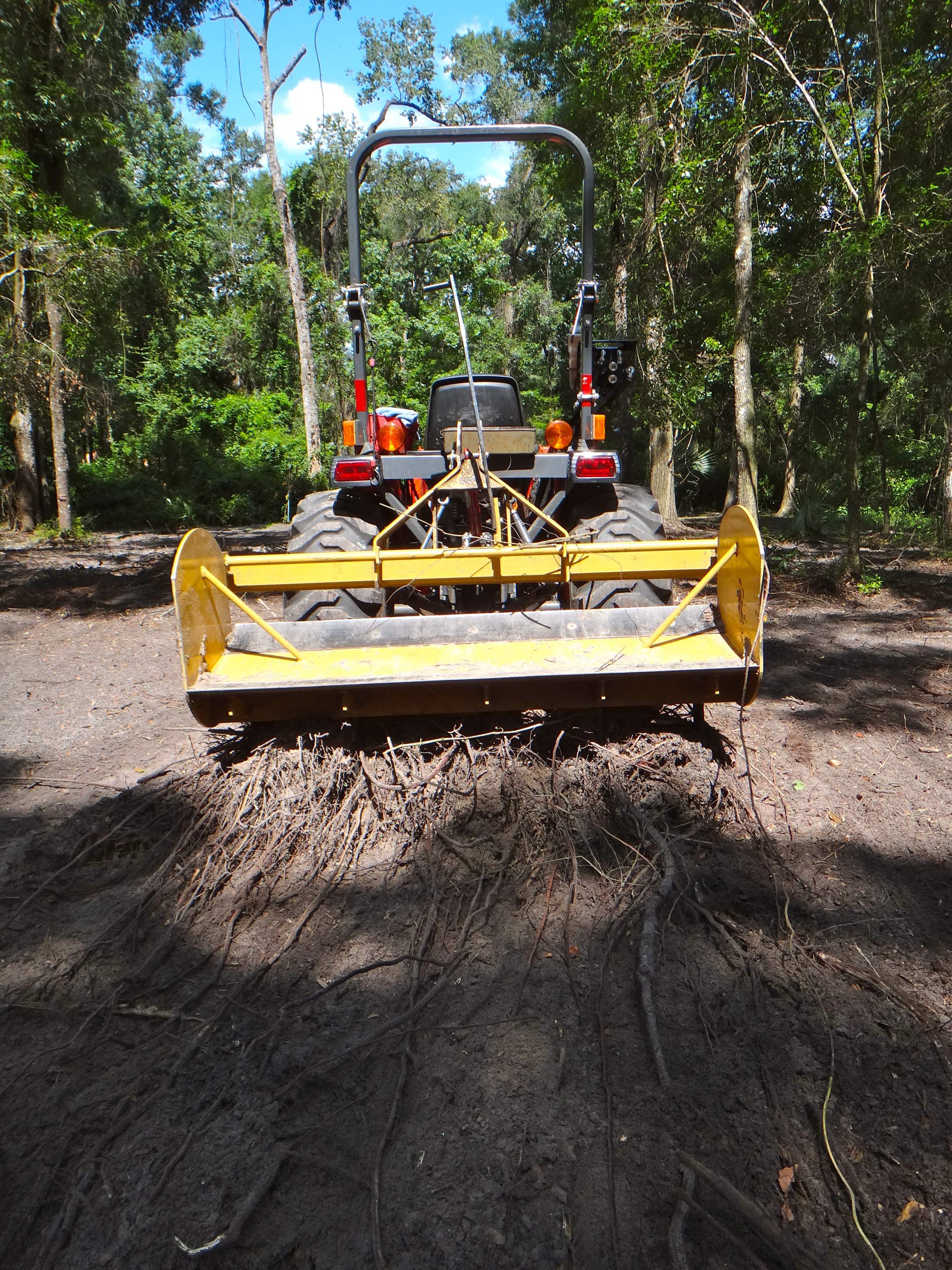

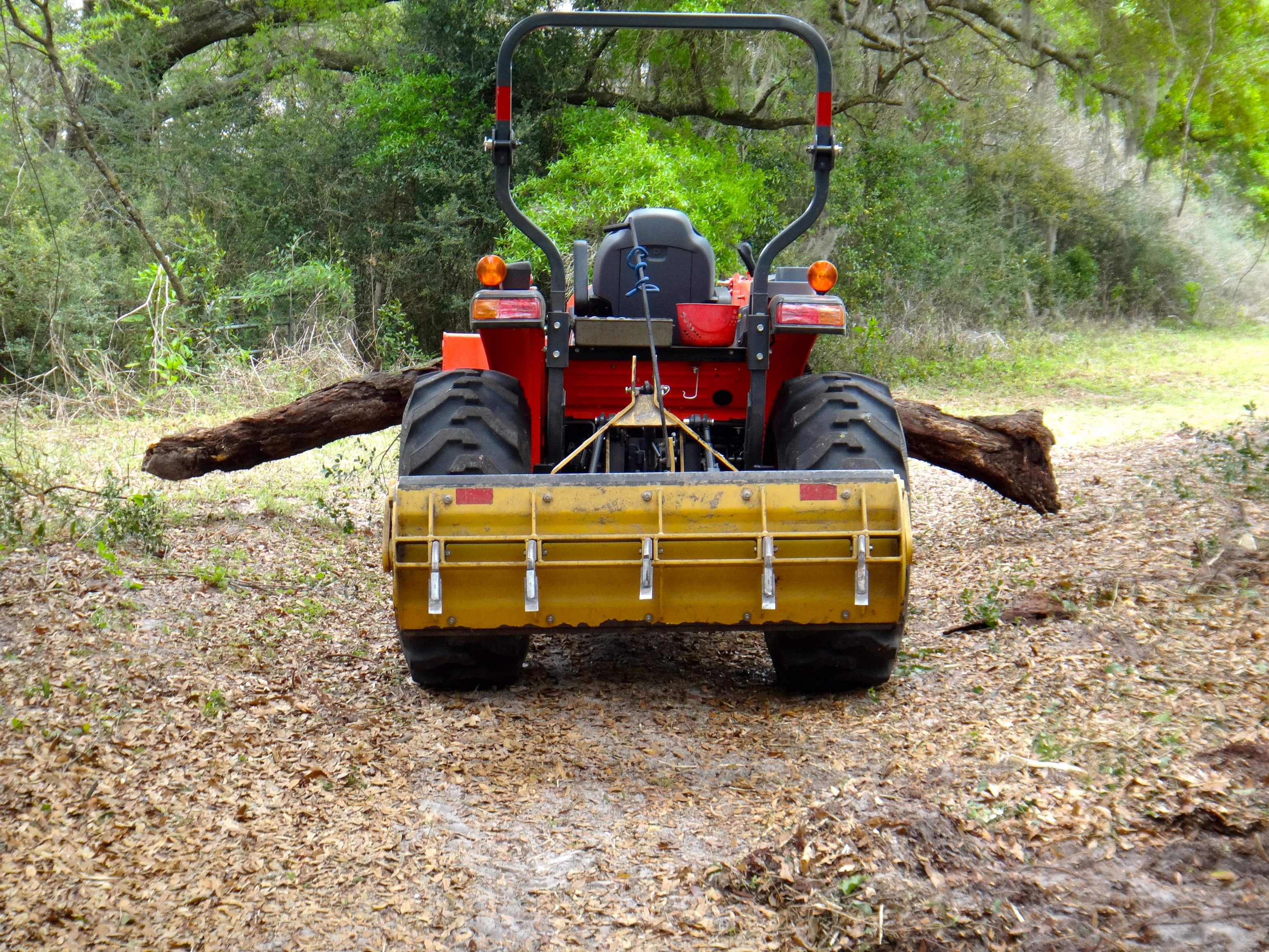

The advantages of a Rollover Box Blade are quick access to scraping, scarifiers, smoothing and pushing functions without rear remote hydraulics. Because of mechanics involved, ROBBs are pretty heavy per foot of width, an advantage. ROBBs make excellent counterbalances. Downside: more expensive than "standard" Box Blades and, in use, can only be tilted a small amount due to weight.
Draft Control 3-Pt. option is useful in operation of all forms of Box Blades.
My 60" ROBB is Bush Hog brand.
Why don't you check your Owner's Manual for peace of mind. I'll bet it recommends an outside tire width Box Blade.
If money is a major factor consider a Rear/Angle Blade or a heavy Landscape Rake for personal road maintenance. They have some advantages over Box Blades for road maintenance. I use an Everything Attachments (ETA) Landscape Rake which is very fine.
Eagleline is a ROBB builder in Sweetwater, Tennessee.
