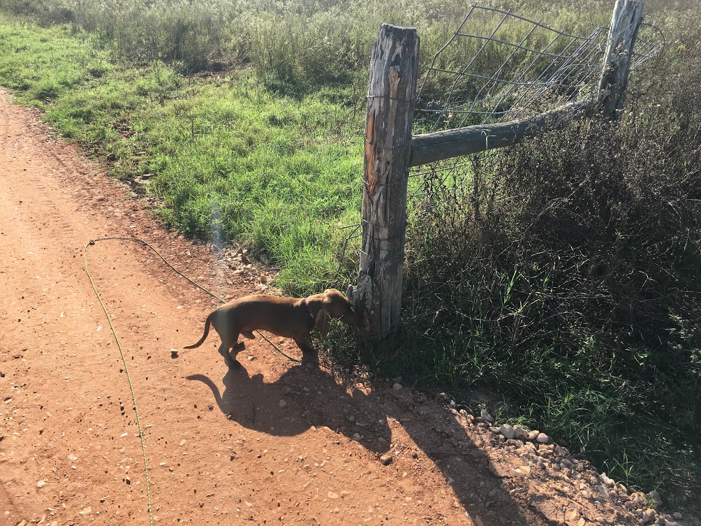

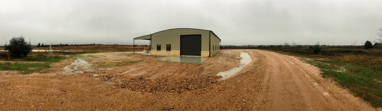

Looking for your thoughts on which tool would be best for maintaining the driveway/road type in the photos below - It's about 800' long.
The red dirt / rock mix is made up of both fines and some larger rocks some up to about 2-3" diameter.
Appreciate your feedback as I am in the market for one or the other attachments to maintain the road.

NEITHER ONE!
You need a rear blade,.... preferably with a tail wheel!
A box blade is primarily for moving material from one point to another, and cannot be angled.
A land plane will give you a nice even surface that will be flat,..... and water will puddle (as in your pix).
You need a CROWN on that driveway, and ditches on Both sides.
You have a nice water catchment area on one side, but almost none on the other.
Think...CROWN...CROWN...CROWN.....!!!
ONLY a blade can give you (and maintain), the crown that you need!
You will need to develop some experience using a blade, but you will get/maintain the VERY best end result!

I will agree - a heavy rear blade on that tractor of the OP's can be a very good and universal implement. The other fact - efficient use of a rear blade has a MUCH longer learning curve and can make a new, inexperienced operator pretty darn frustrated. If a heavy duty rear blade is purchased - then the hydraulic top link becomes even more important. I say hydraulic top link rather than rear tail wheel because the top link can be used on most any ground engagement implement. Tail wheel is a one implement addition.
Weight is your friend if using a rear blade. I have a Rhino 950 - 8' - 1000#. I would recommend a blade this size or the next step up - Rhino 1540 - 8' - 1750#. Be prepared for $$$ shock............

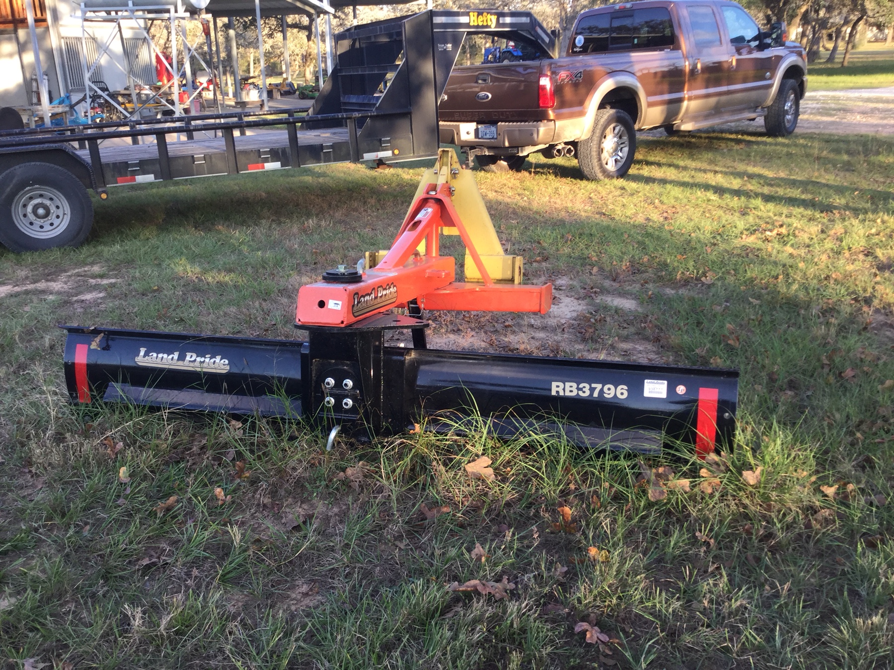

I agree on a rear blade for getting your road built. I’ve got a Land Pride RB3796 that I can run on my 55 HP and my 96 HP tractors.
You could easily run a heavier RBT 45xx Series Blade on your tractor.
RBT45 Series Rear Blades | Land Pride
Hydraulic top link is almost a must have. Look at Fit-Rite Hydraulics for Top and side links.
Fit Rite Hydraulics - fitritehydraulics.com
Gauge wheels are ok, but IMHO, skid shoes are simpler and way less cost.
Once you get your road constructed, a land plane will be excellent for maintenance of it.
