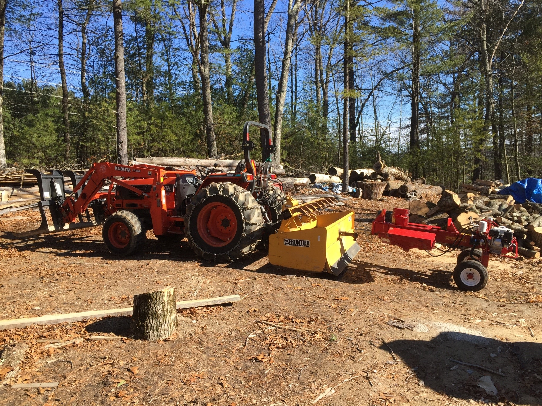

   / Box Blade mods #3
I use my Gannon box for ballast as well as dirt work, future plans are to add some racks to allow additional weight, either suitcase or blocks.

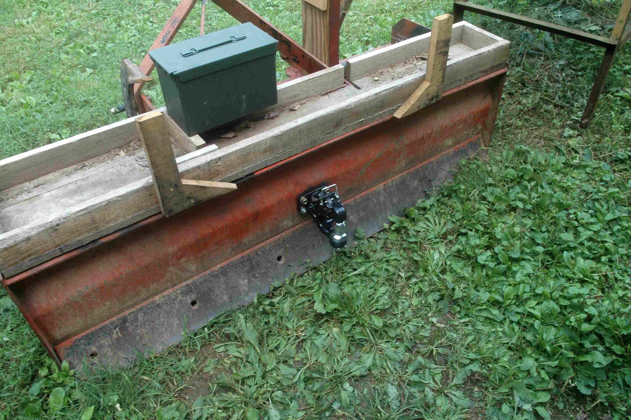

   / Box Blade mods #4
I had some oak that I built into a box to sit on top of mine to carry a pole saw, chains, gas, etc. Later I bolted on a hitch because I also need to move my trailer from time to time and didn't want to have to remove the blade just for that.
The two vertical upright pieces of wood are to wrap chain around.
There is also a chain saw holder, but the pic isn't very good of it.

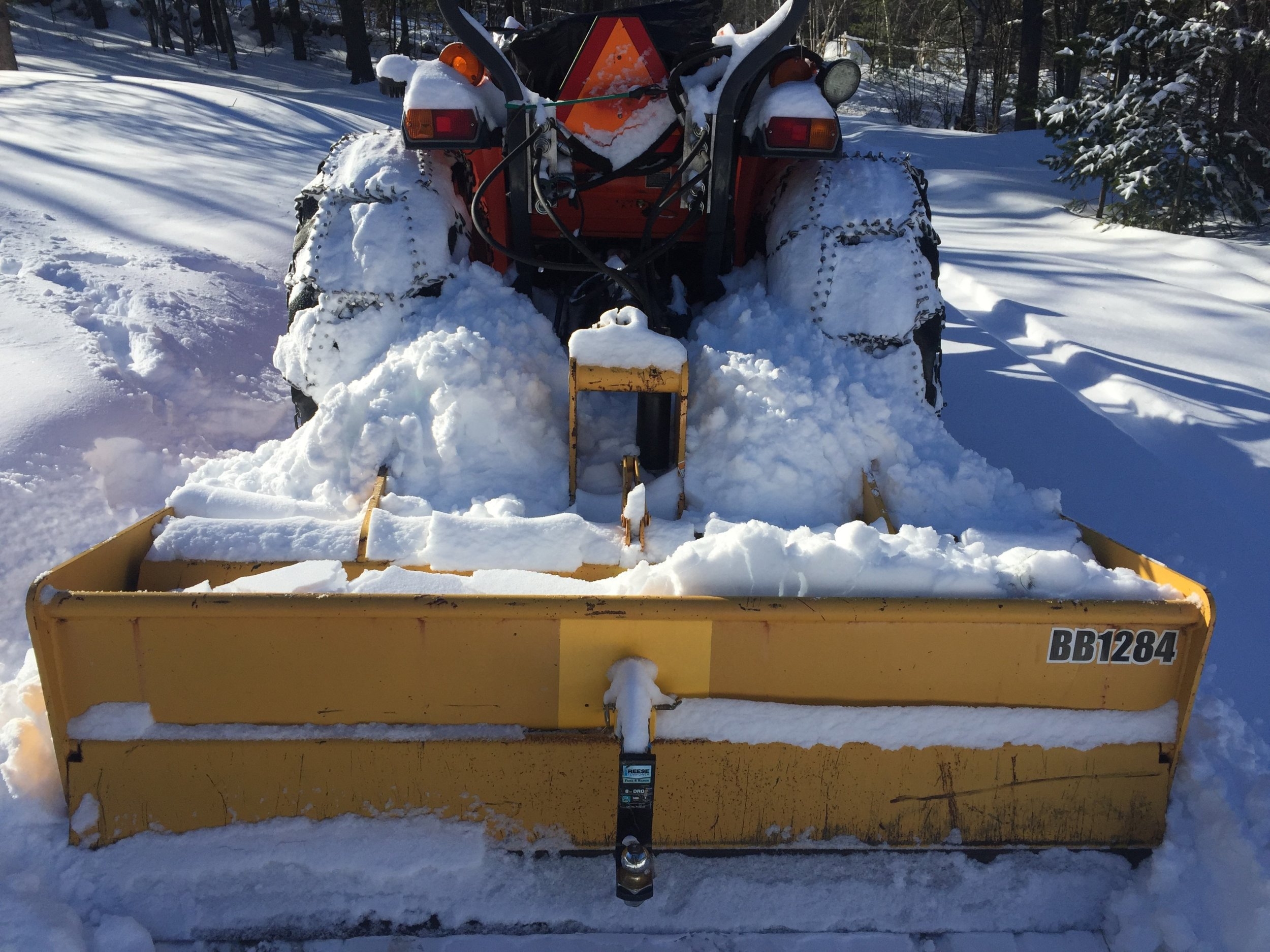

   / Box Blade mods #5
I have a 6' box blade. I used some 2" black iron flat steel to make a grid over the outer parts of the blade so that I could put 4x8x16 solid blocks on each side on top) of it. It can add up to 200 pds of needed. Two hundred pounds is a little heavy so I usually add about 100. The box blade by itself weighs about 400.

   / Box Blade mods #10
Generally, I prefer metal for these kinds of modifications, but I needed something quickly and had the sawmill cut oak wood which is about 1" thick. Besides being faster to put together than metal, I also noticed that I needed more space and also needed a better way of dealing with wrapping the chain. It was pretty easy to make additional modifications once I saw what needed improvement.
Don't be afraid to do a working mockup in wood to carry tools if you want to try something before commiting yourself to fabricating it in metal.
