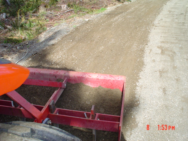

I have a KK XB 48" BB I use with a SCUT. probably the same one you saw at TSC. It is a great implement to have. I am currently using it to regreade about 1/4 acre or more. The rippers are very good for removing grass, weeds, roots, etc. Once that is done, I remove them and use the blade portion to do the finish grade. I also have a 5ft RB, however it has sat idle since I purchased that BB. The only tip I would provide is that the top link retarcted will give you a more aggressive cut on the front blade while a more feathering effect if it is extended. By one, you'll see what I mean.
   / Box blade instructions #5
You can do crowning and grading to a degree with a box blade if you have top and tilt. However JoeinTX is right in that it is easier to get the general shape with a back blade. But a box blade will do the best finish work on that road once that shape has been achieved. A box blade has a set of scarifier teeth on the front to rip up an area. I use it to rip up my roadway before grading which I do with the box blade.
I had a hard time learning to use the box blade until I read a thread here that brought it all together.
Most box blades have two blades. One faces forward and the other back. To level an area such as a new lawn, you would set the box blade so the front blade is just slightly higher than the back one. Now go over the area slowly. It will take some time and patience but the area will be very level when you are done.
What is happening here is the front blade is taking a little off the high spots, carrying it in the "box" and dropping it in the low spots. While this is going on the rear blade is smoothing out the area you just dragged. You can't take large bites when smoothing or you will end up making it worse. Also, and here was what was gving me trouble, you must not chase the area by raising and lowering the box blade. Have patience and let it do it's thing and it will come out great.

The teeth can be adjusted 2 ways. You can angle the front of the BB unit down (with the top link) and you get more engagement with the teeth than the blade. Mine can be angled enough that only the teeth engage, kind of like a plow. Titlt the front of the BB up and you get less, or no tooth engagement. Second, most BBs allow you to adjust the tooth height and/or remove the teeth altogether.

I usually start by setting a height when it is still rough. And try not to take off too much at a time. When you have the area fairly smooth you can let the box blade float. But remember you don't want to remove a lot so there would be very little difference in the height of the front and back blades. About 1/2" would be correct.
