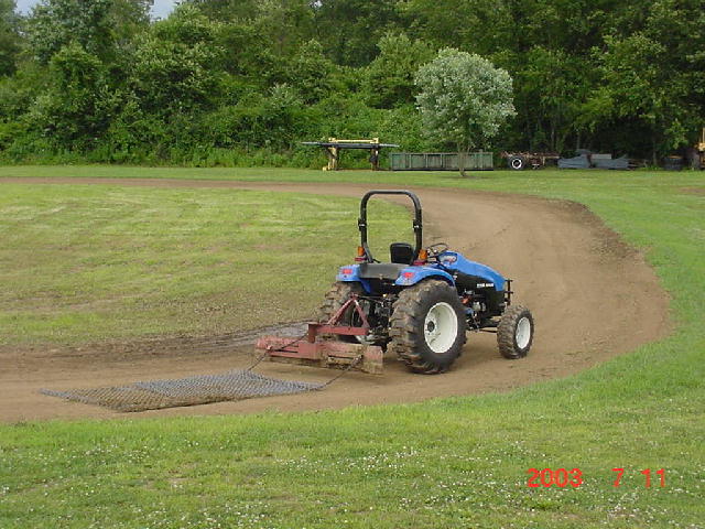

I have a '03 TC40D and bought a new 72" box blade for it this past spring. With the rippers down when building a track out back of the shop for my kids, the 72" was all the TC40 wanted. This was ripping established sod in 6" of top soil with sand composition base under the top soil. Several times it was enough to stall the tractor in low turtle 4wd. If your just spreading gravel, or leveling the dirt without rippers, you could get away with the 84"............Tom Attachment shows finishing the track with a 84" (GRADER) blade and a homemade chainlink leveling drag.........Track was made by making MANY laps with the box blade and scarifiers first...........

Mark, I've stopped my TC45D many times with my 5' boxblade when the scrarifiers hit the right kind of material (roots and rocks mainly). My 66" blade has no scarifiers, so it has never stalled me except when I was in deep sugar sand pulling a box full of sand.
I think you could go with an 84" blade and just not put all the scarifiers down if it ends up being too much for your tractor. Having a 7 ' swath is very tempting. /forums/images/graemlins/cool.gif
