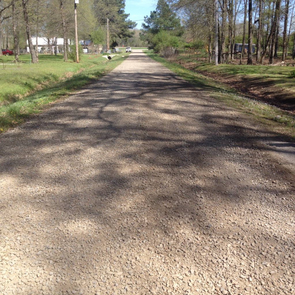

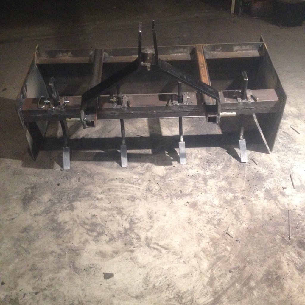

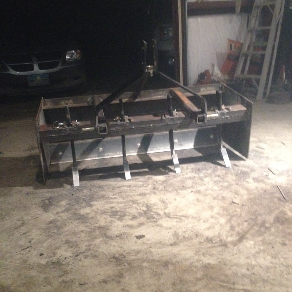

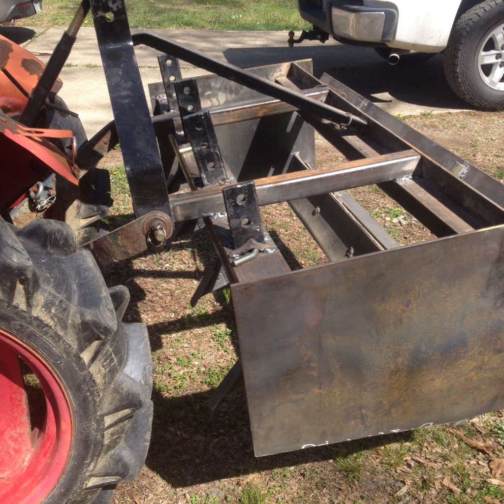

When I built mine, I ended up spending close to the same as what it would cost to buy one. Rippers you can buy for pretty reasonable through agrisupply. I bought a cutting edge from king kutter.
One thing I did on mine was make a tailgate that flipped up just above the cutting edge. It basically turned it into a land plane. It made it handy if you just wanted to knock down and chew up wash boards without dragging a bunch of material.
