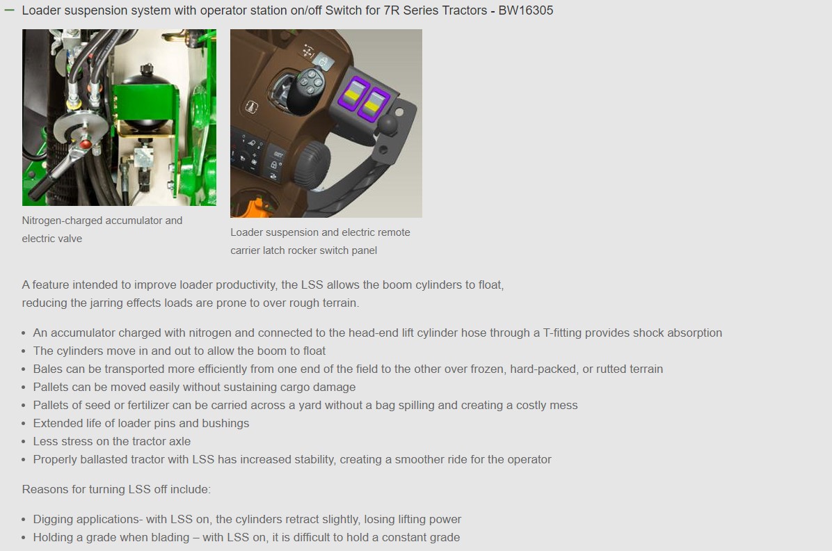

The thread title made me think that there are times it would be handy to have a "bouncy" 3PH. This would be in the form of a small accumulator plumbed into the 3PH circuit with a on/off valve. The accumulator would provide cushioning when roading a tractor with an attachment mounted on the 3PH. It would be a similar setup to those used on FEL's to provide load cushioning when running on a rough path.
Anyone heard of such a thing?
   / Bouncy 3 point hitch #8
I totally agree with you. Every time I road the tractor with either the tiller or the brush mower on the back, that idea come to my mind. Specially on roads full of potholes.
The main problem I see is that different implements will have different weights, so the accumulator pressure would need to constantly be adjusted. Accumulators for loaders are usually filled with nitrogen and are set to a certain pressure that will handle the loader weight with an empty bucket.
   / Bouncy 3 point hitch #9
This is the system Deere uses on some of its front end loaders:
Adding an accumulator to the 3PH would be interesting in that the 3PH linkage would try to bring the implement back up to the top of the stroke on its own after the accumulator let it drop down to cushion the load. Finding a place to tee the accumulator into the 3PH plumbing might be a challenge as most of the plumbing is internal.
