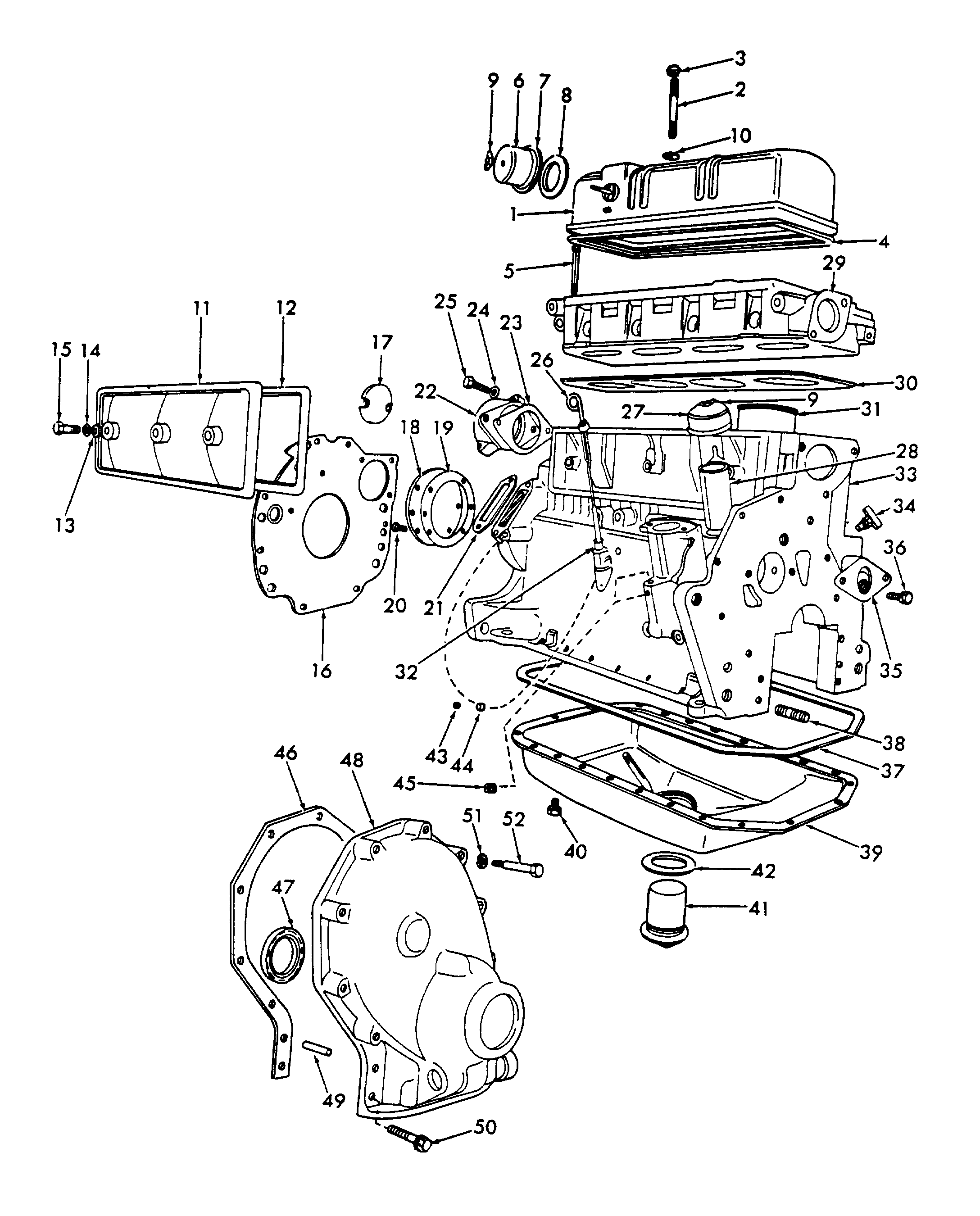

Welcome to TBN. I often use Messick's for parts. It is easy to look up parts, price, and availability. If it is an 850 here is the parts page. My local dealer is an 88 mile round trip so I order from Messick's if my local dealer doesn't have what I need in stock. I end up paying for shipping either way if it has to be ordered .
I use NH fluids and filters. I don't put that many hours on a tractor each year so I don't have to change them that often. The little extra I pay for NH brand fluids and filters is worth it not having to hassle with matching off brand filter numbers or fluid compatibility. Messick's parts department or your local NH dealer can help with filters or fluids.
