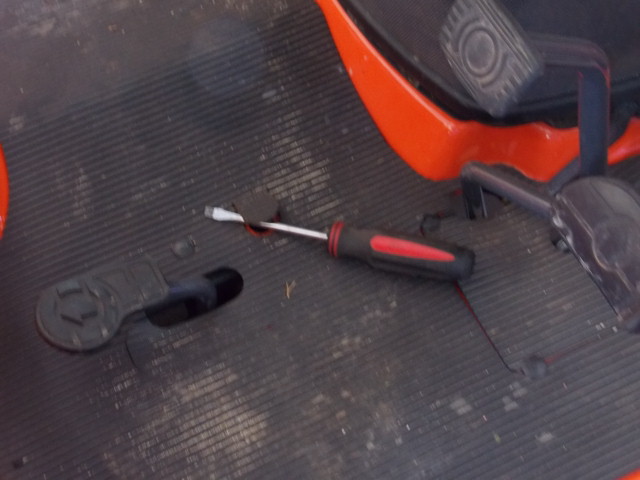

Good luck with the new tractor. I would advise you to check the fluids and tire air pressures. Even though the tires are loaded, you still have to maintain air in them. Make sure all the grease fittings are hit. And if your tractor is similar to my BX-25, be sure to hit the zerk for hst peddle. It's located under the floor mat; there's a little cut out that lifts up to access it. I would always kept an extra set of filters on hand, especially for the fuel and oil because we all know--ice cream happens. Have fun.
what kinda filters do u recommend? kubota brand only or other after-market ones are ok?
the zerk underneath the peddle was the first one i hit! lol
still the peddle seems to be releasing slowly after going forward,any idea?... reverse functions is great!

Look under the tractor just above the hydraulic filter. You will see a spring with a threaded rod on the bottom. That is the return spring for the HST pedal and needs to be adjusted as the spring weakens. You will need a 12mm open end wrench 12mm socket, 6 inch extension and ratchet. Loosen the top nut, turn the bottom nut to adjust then tighten the top nut. Don't go more that 1 turn at a time. According to my manual the tractor should stop in 3 ft when going forward in high.
The top nut is hard to turn because of the fan blade in the way, I held it with the wrench and backed the bottom nut off 1/2 turn, I was then able to run the top nut up with my finger tip.
After loosening, turn the bottom nut clockwise 1 turn, run the top nut back down and hold with the wrench and tighten the bottom nut.
I had to adjust 3 times on mine before it would stop in the prescribed distance but I didn't want to over do it.
