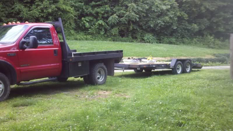

Yep. I bought a trailer today, wanted to share.
It's a 16' flatbed, with a 2' dovetail. 18' overall, plus tongue. Doesn't have the side rails that most utility trailers have, so you can side load it with a forklift in front and behind the fenders. Has stake pockets to add side rails, though.
I bought it used, the floor and tires are good. The only problem is the paint, it could use some cleaning up and a repaint. It has hideaway ramps that slide under the dovetail.
The only thing I don't quite understand is the axles. The trailer has a 2 5/16" ball, brakes on both axles, and a heavy duty frame. Judging from the ball and frame, I would expect it to have 5,200 pound axles. It has dual 3,500 pound axles. Most of the 7K GVW trailers I've looked at have a 2" ball and brakes on only one axle. It's a factory built trailer, but the tag is worn and practically unreadable.

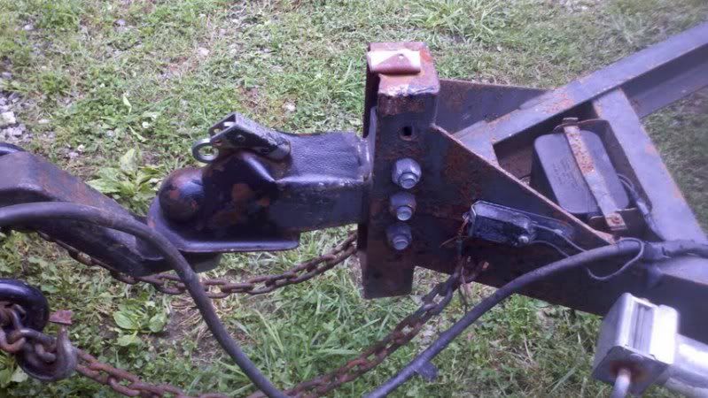

   / Bought a trailer today
First picture is of the trailer. It's mostly grey, but needs to be stripped and painted. Has some surface rust in a few spots, and needs the lenses on some lights replaced.
Second picture is a closeup of how the hitch mounts to the trailer. Never seen one like that. Looks like it was designed to be swapped or adjusted for height without too much trouble. Just a note, I plan to get new hooks for the safety chains. The way my flatbed is designed requires me to use two 7/8" shackles to run the chains through, so I plan to pick up some hooks with 'keeper tabs' that aren't bent.

Nice trailer. Very nice truck.:thumbsup:
How hard would it be to just put new safety chains on that could have a big enough hook to hook right to the shackles instead of running through and then hooking back on the chain? That looks like a nice coupler, heavy duty and easy to adjust. Having both axels brake is nice. I prefer the 2 & 5/16" balls for any tandem axel trailer so that would be a plus for me but I don't know what size ball your other trailers use.
