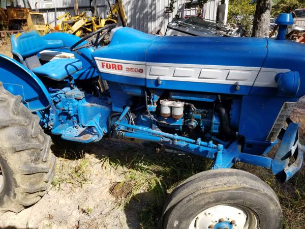

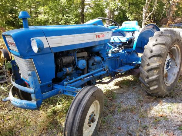

I backed up and lost all of my long post so here it goes again from the CL ad.
ALL ORIGINAL SHED KEPT
None Nicer
Vented Hood, After market Power Seering that works & lasts, Ford's gave constant trouble
With one remote double valve
Spin out wheels
Excellent Tires
Lights work
No leaks, very clean & tight
Must see to appreciate

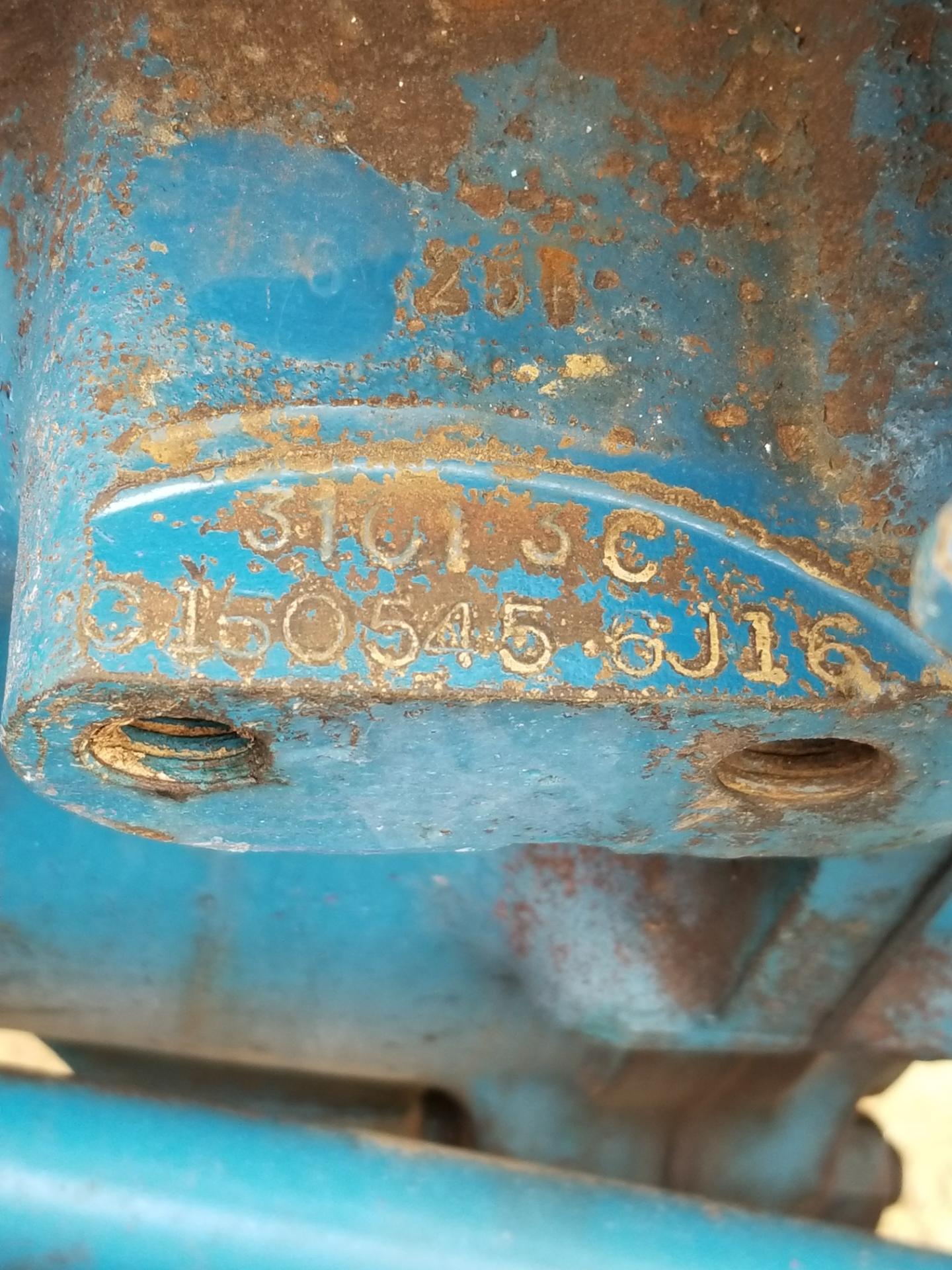

Photo of serial number.
The blue rear fenders raises a question for me. I thought they were all a gray like color. It as the canister oil filter and somewhere in the wee hours last night I read that meant 1965-1969 era.
It seems to be a heavier tractor than the gas and diesel 3000's that I looked at yesterday. They had CAT 1 hitches and our has the removeable balls to make it Cat 1 or Cat 2 on the fly which was another deal closer as we have most of the equipment setup for CAT 2 to use with the 265 MF.
Any thoughts or input in dating our NEW tractor would be appreciated. Thanks.

NICE 3000
The hood ( vents) and grille suggest a 1965-1967, 1968 and newer have the newer flat faced grille

Thanks sd455dan. The seller who is 70 years old and grew up on a farm in the region stressed the vents denoted age. I guess it being a 65-67 will cut out some guessing about the serial/production numbers. Dad bought a used gas 3 cylinder 4000 in about 1971 or 1972 and I think it had the vents and we were told it was a mid 60's model.
Do you know if blue rear fenders could have perhaps been OEM in those years?
What about the heavy lift arms that takes either Cat 1 or Cat 2 balls that clip in that I did not see on the new years of Ford 3000's that I looked at?

From the oil filter size you can tell it's a earlier 65-68.
To me that is the best series Ford Tractors built for Size to power the only weak point in my book was Brakes (2000 and 3000) the 4000 series had the best of all with the addition of wet brakes but the were a little on the heavy side.

Thanks everyone. The guy just dropped it off down at the main road and I drove it up the hill to the house. I came up the steep hill in 6th I think and it sounded good so I think the engine must have fair compression.I got a tarp over it (thankful for the down draft exhaust system) before I had to leave for the day but I think the rain is about gone for a few days. My best guess at the photo of the serial numbers is it is a 1966 or 15 years younger than me. Our daughter wanted to get it and learn how to drive it so I expect she will put her name on it in time. Later.
