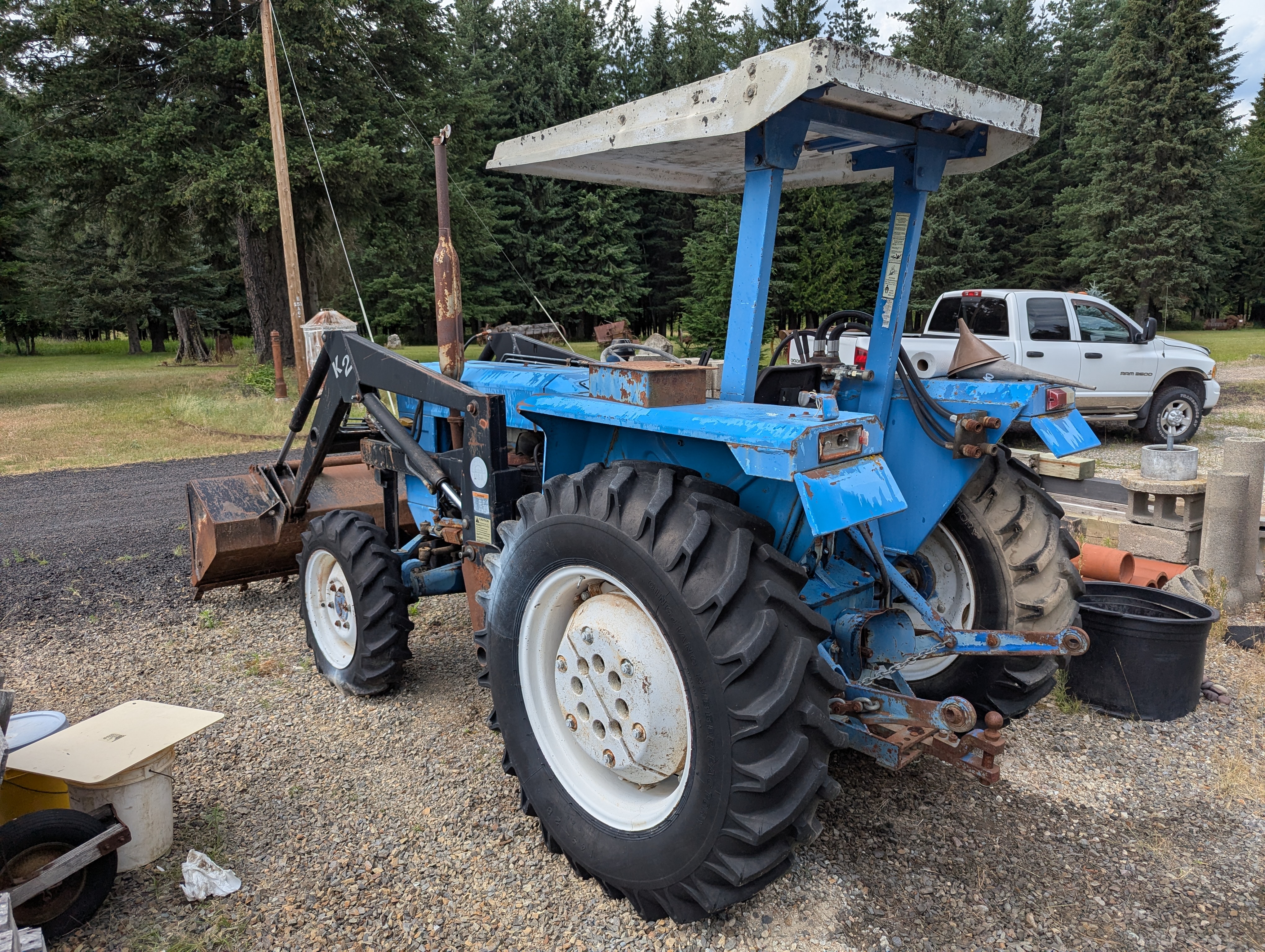

I purchased it as a parts tractor, for my existing 554 Rhino, in case I need hard to find parts. Well with fresh diesel and the included new batteries and shorting the solenoid the engine runs too well to just be a parts tractor. PTO works and also the 3 point, transmission shifts, and the two stage clutch is working correctly.
So New Plan, fix what is functionally wrong with Rhino #2 to be useable, if the original Rhino breaks use #2 until I can source what is needed to fix the original and rinse and repeat.
203 cubic inch engine runs Good.

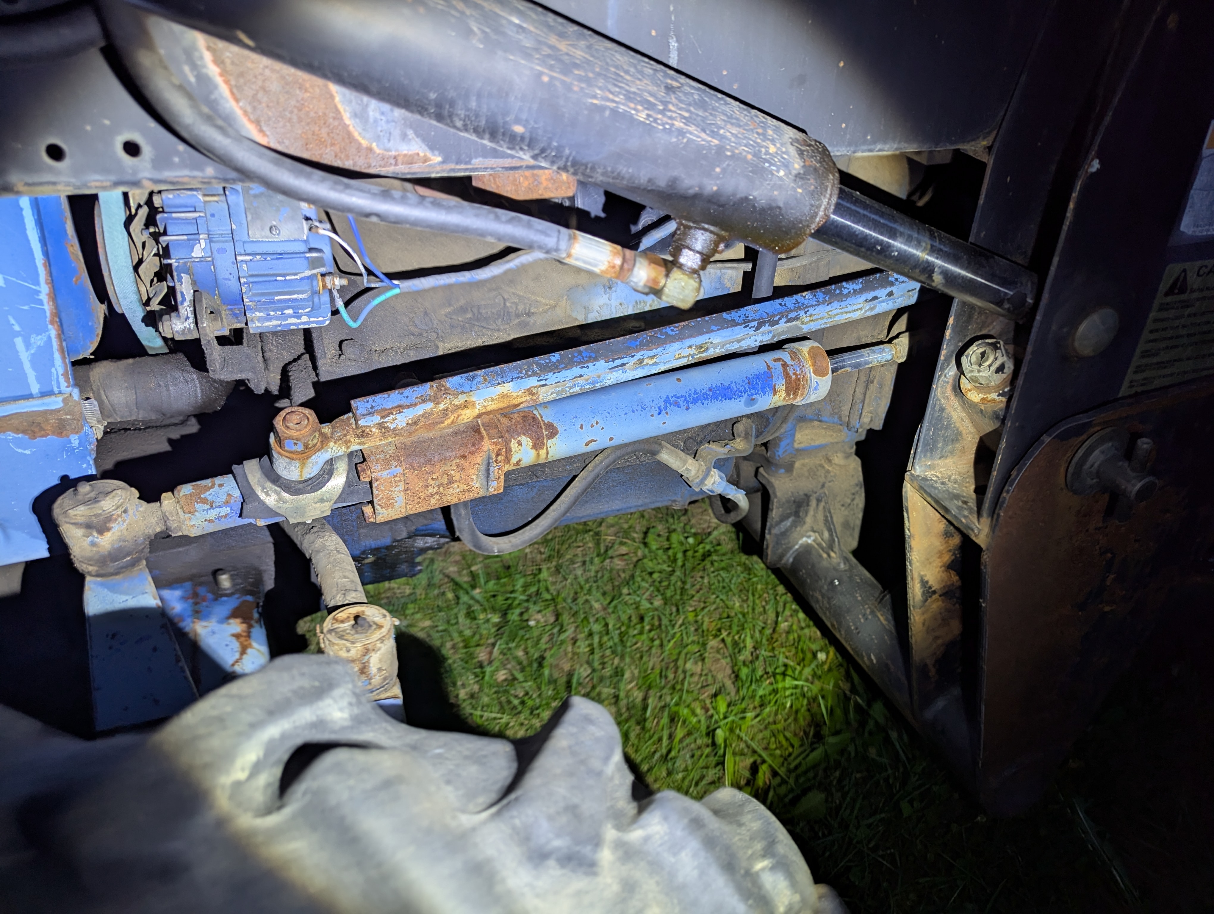

Power steering was non functional. This took some work... The system is modeled after Massey and Fords use of a manual steering box that also has a dual valve that opens assist pressure for each direction when the wheel s turned using a rod to the valve. The valve was completely rusted in the turn left position, finally got it disassembled ( had to put it in the hydraulic press to get the parts to move then back in the ultrasonic cleaner with ATF and acetone, cleaned, lubed and back together also the pressure pipe was burst in one section... MIG welded back up and purged lots of bad oil, cleaned the screen replaced fluid twice and the steering is power assisted.

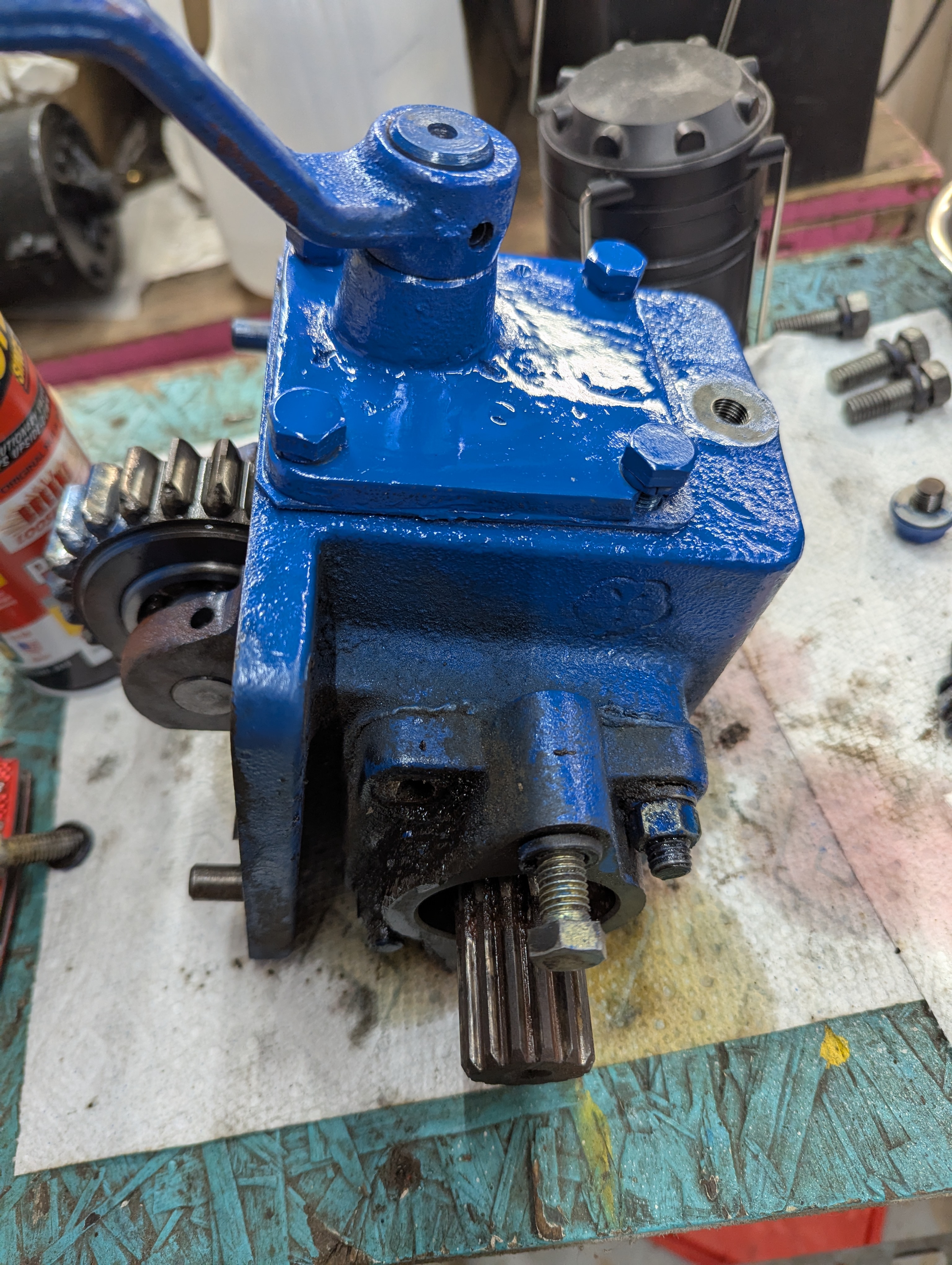

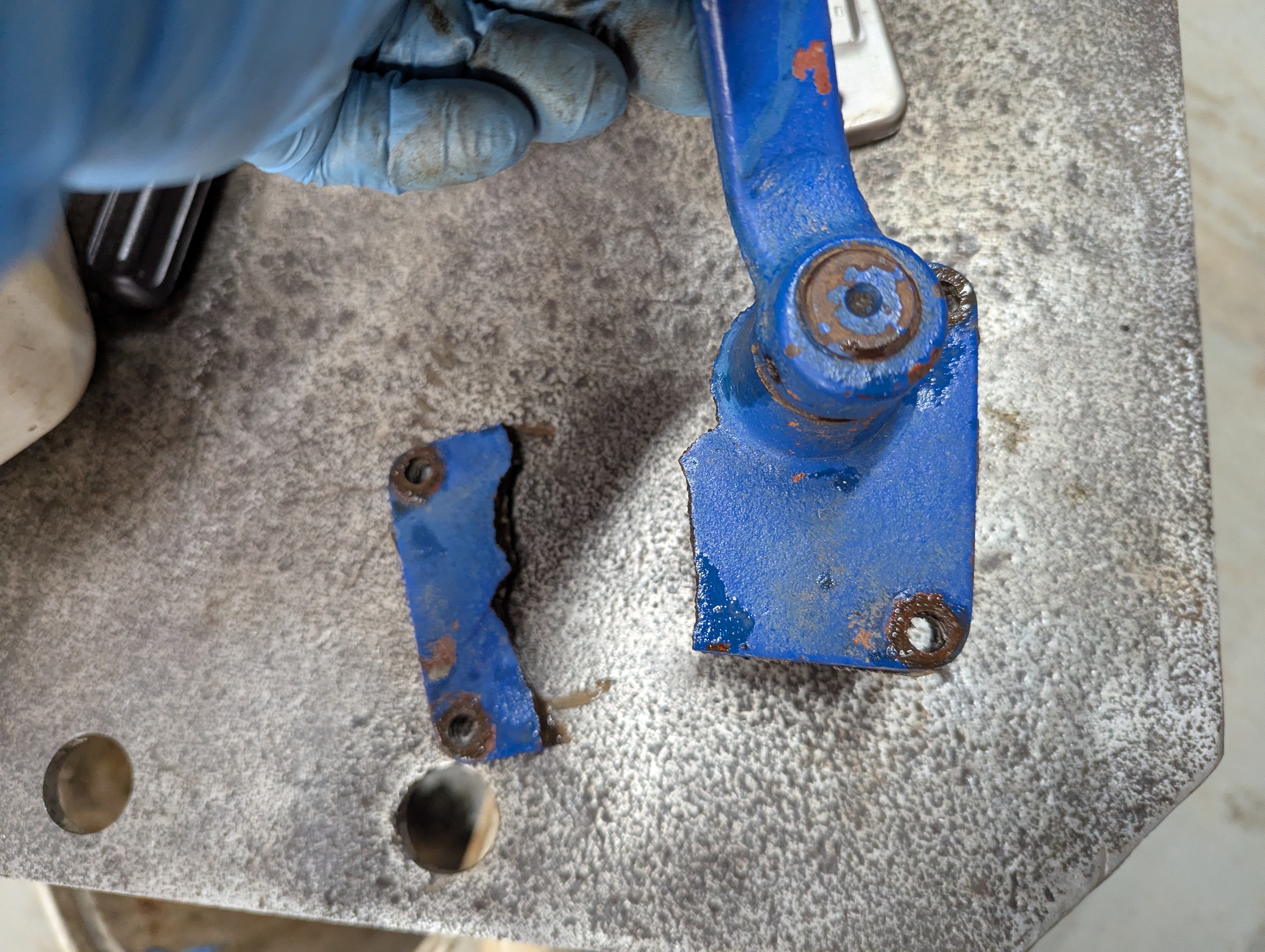

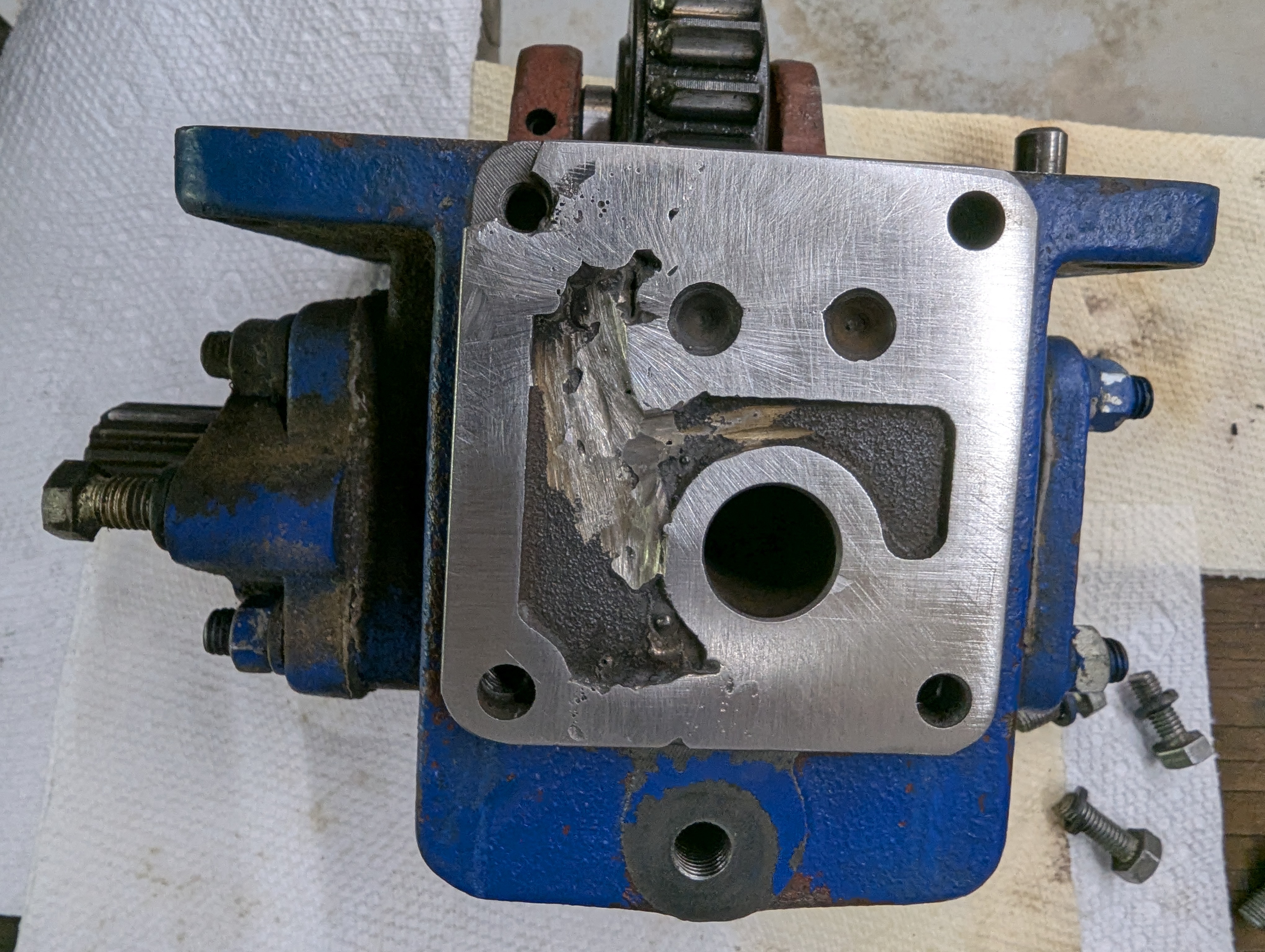

Big leak from the 4x4 transfer box . The driveshaft seals were both shot and the case cover was completely broken into two pieces due to water ingress and freezing at the lowest point.
Stick welded the cover with Hobart 55 Nickel rod and trued the cover back up. traced and made new gaskets and installed the new seals. No more leaks and shifts in and out of four nicely. 11 gallons of fresh UTF in the sump as well.

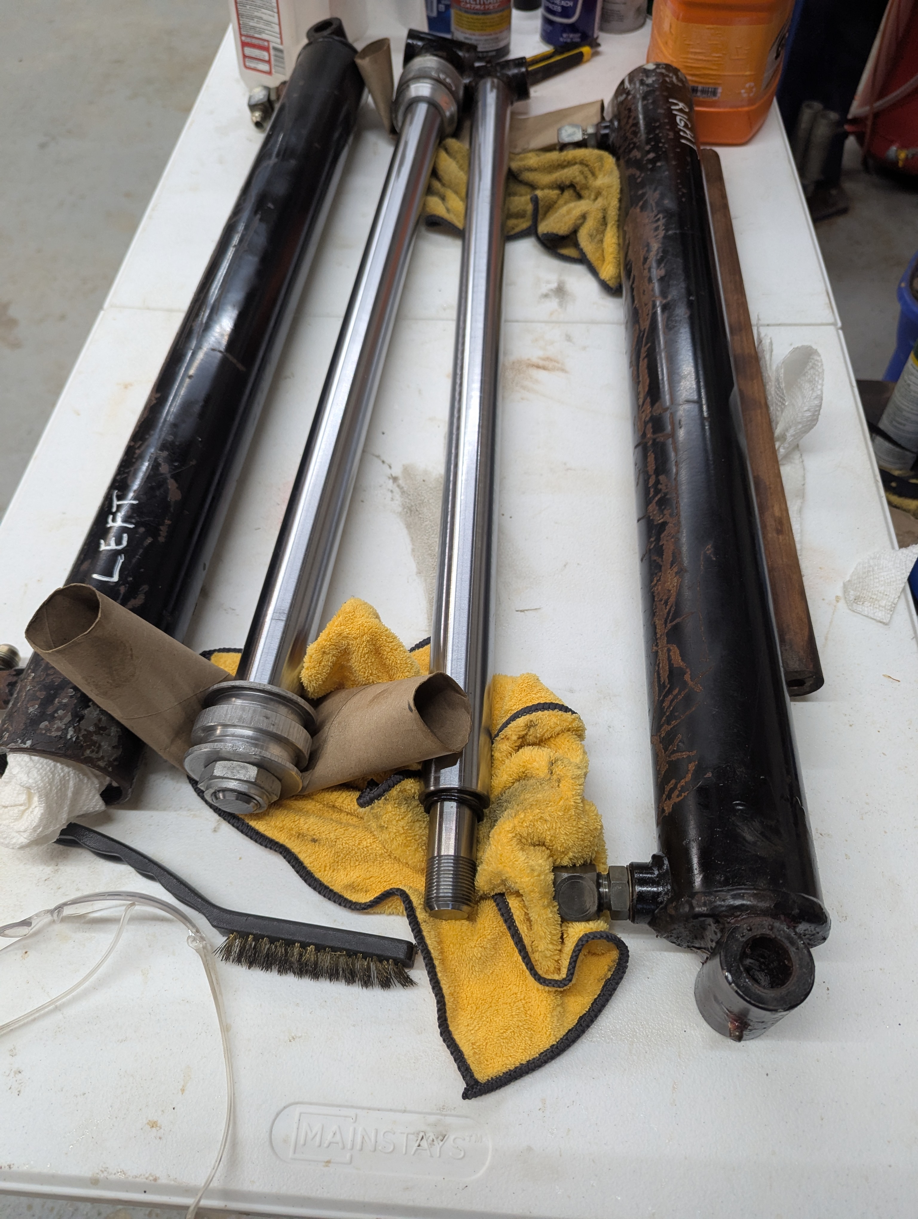

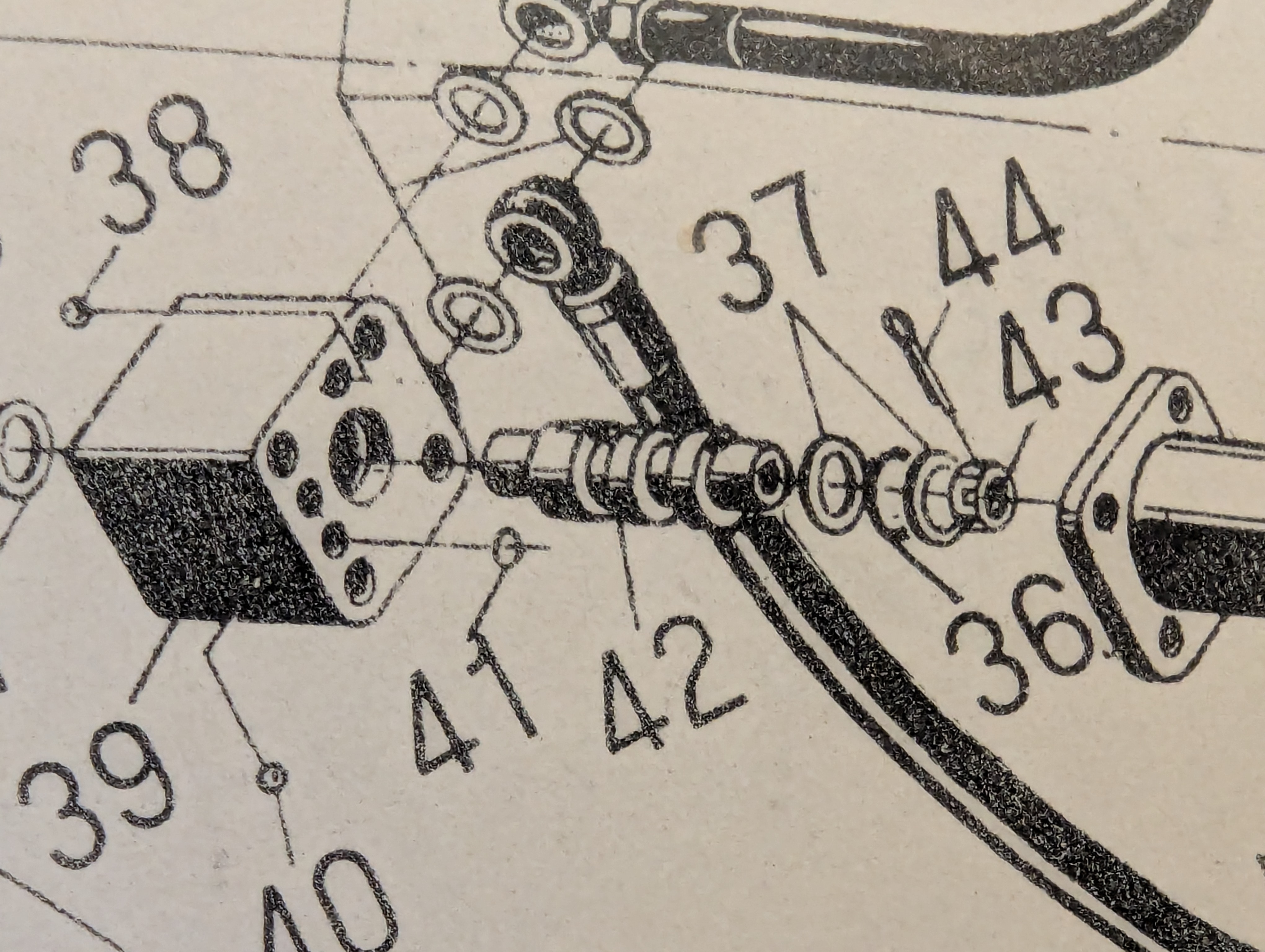

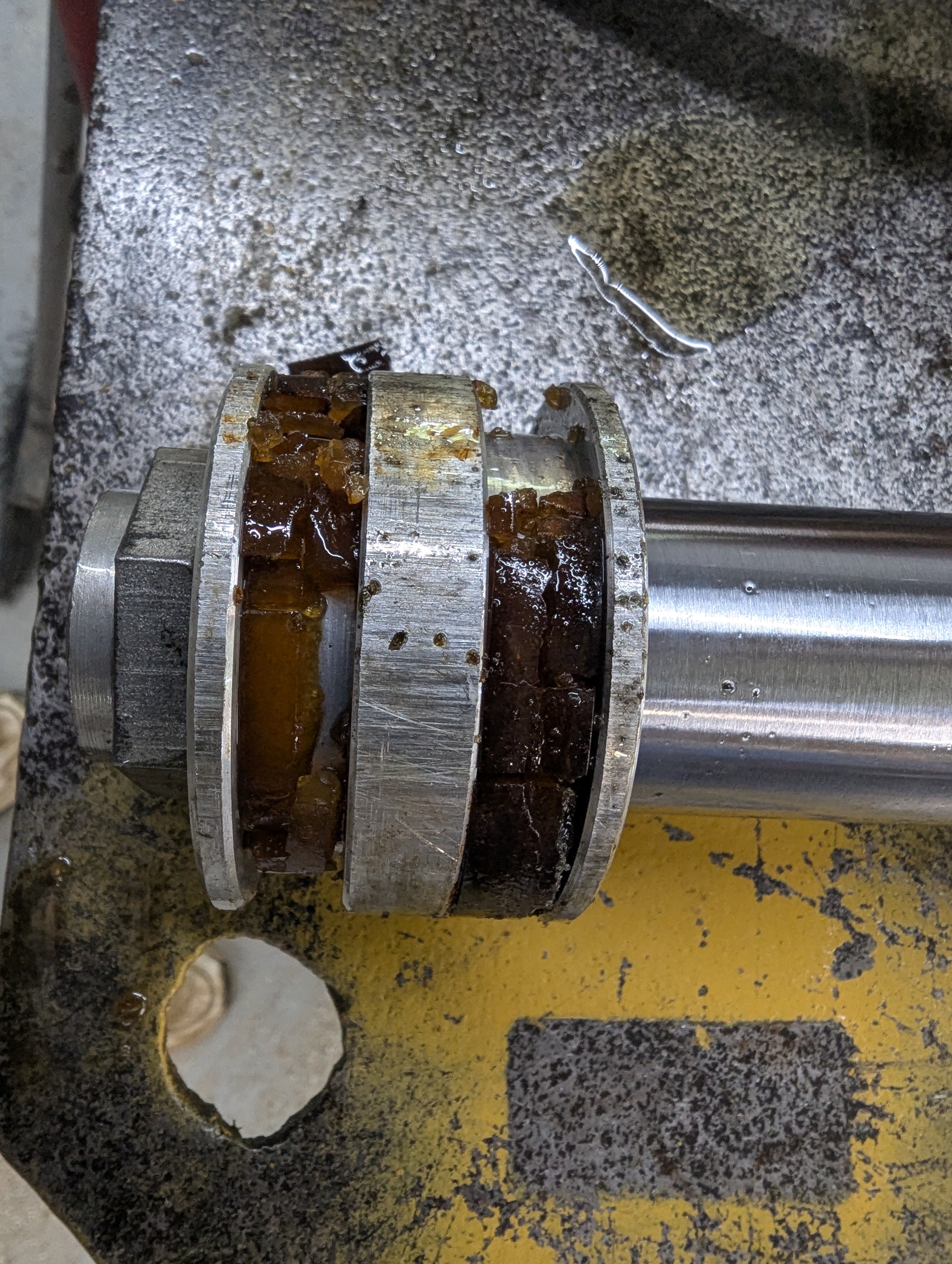

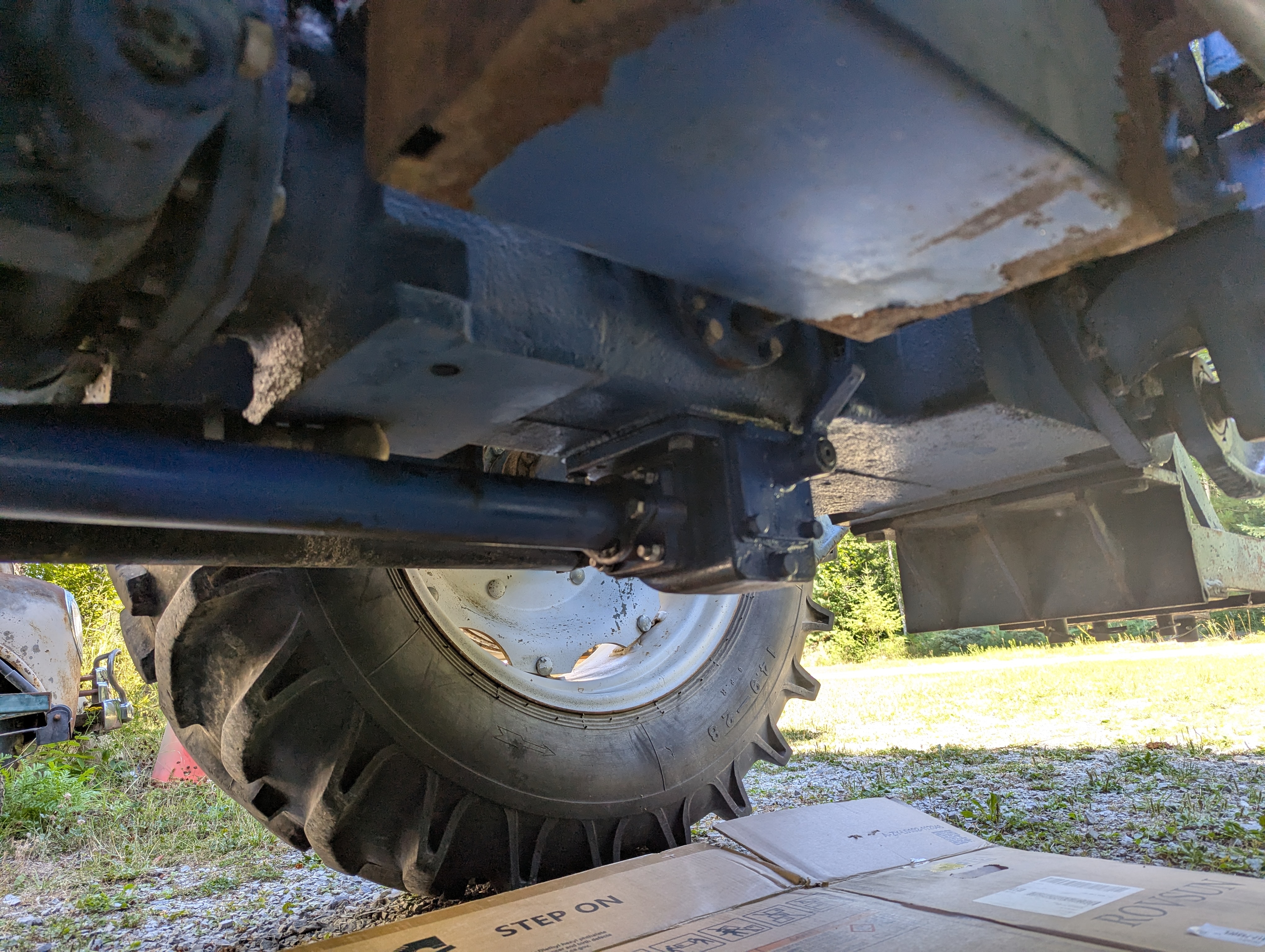

Next hydraulic woes... FEL Only lifts with the Power beyond lever pulled blocking the return to sump circuit and only relieves through the PRV . Swapped the Cross brand control valve assembly from Rhino #1 and the problem stayed. New seals ordered for the cylinders, but I did have two spare piston seal kits for the existing FEL cylinders. Got the cylinders apart and the seals were absolutely toast. Installed each set after major clean out of the two cylinders and also spun the aluminum pistons on the lathe and removed some scoring as well with some emery cloth.
Lift cylinders reinstalled and Yahoo.
The lift circuit now works and easily also lifts the front axle off the ground. As above kits ordered for the Curl cylinders. I got 3 Gland nuts off with heat, peening, air , and pipe wrench, but number four was not having it. I have pretty much Destroyed the aluminum gland nut so ordered a new one tonight. Hopefully have the cylinder parts in a week.

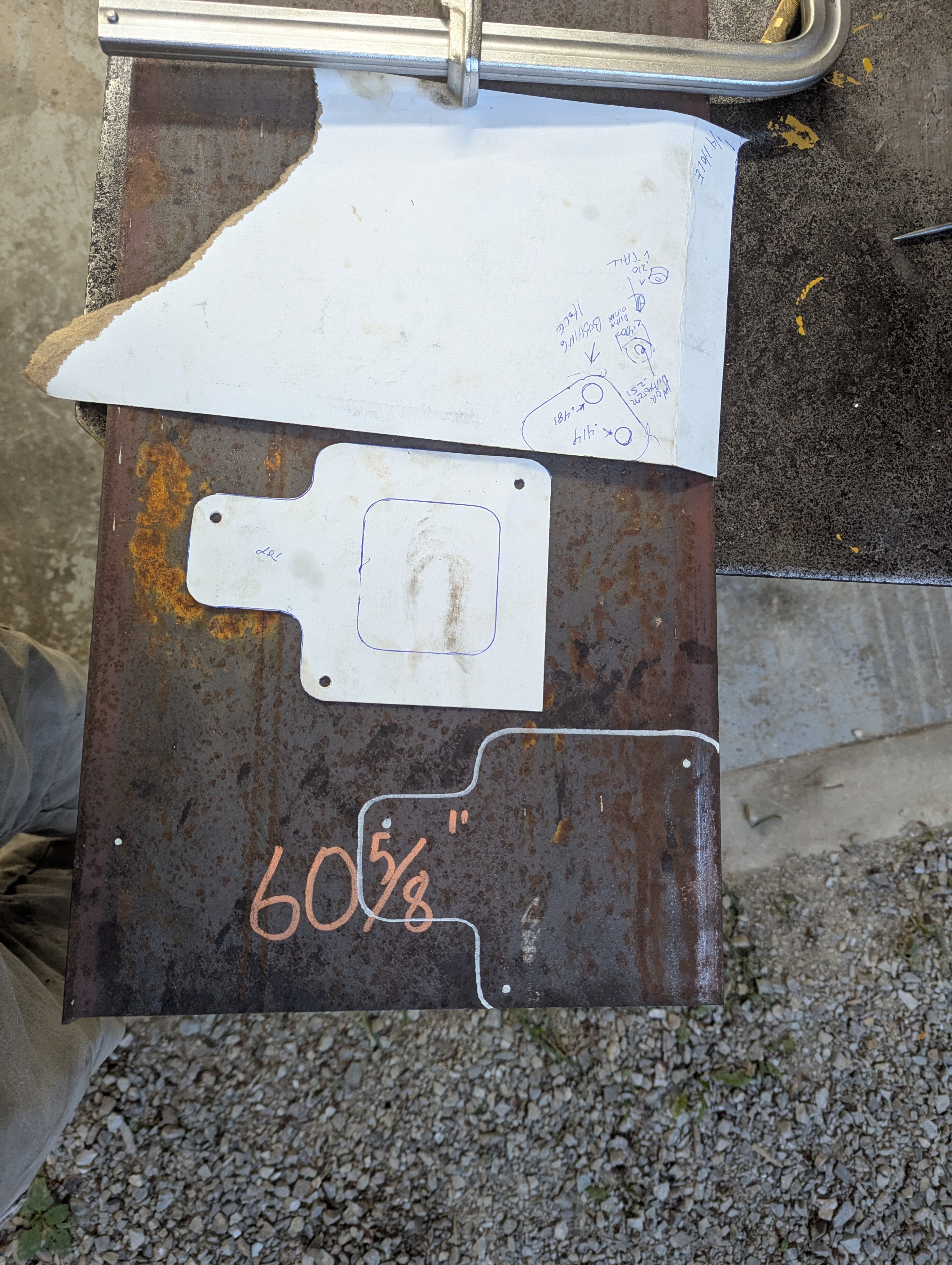

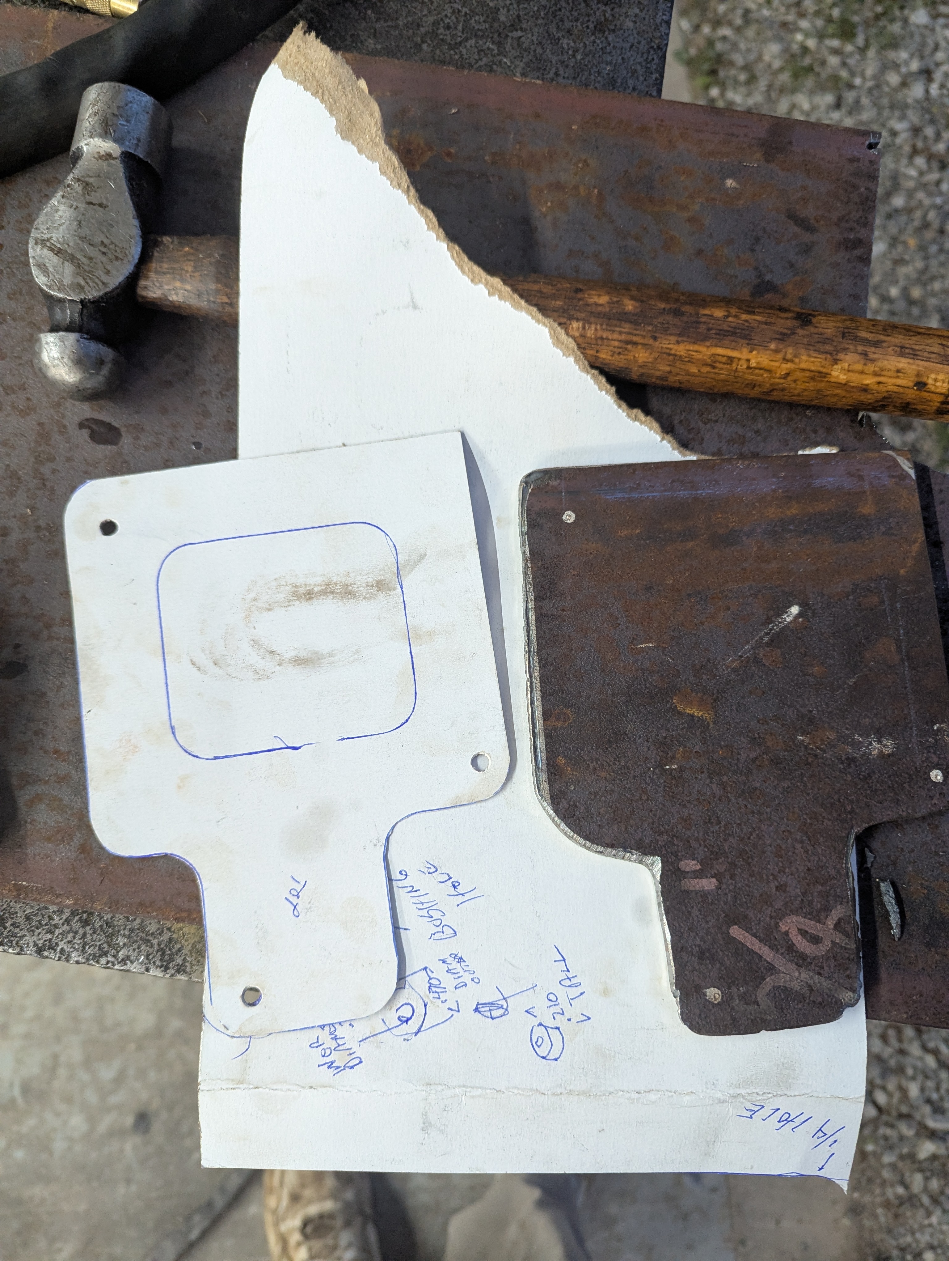

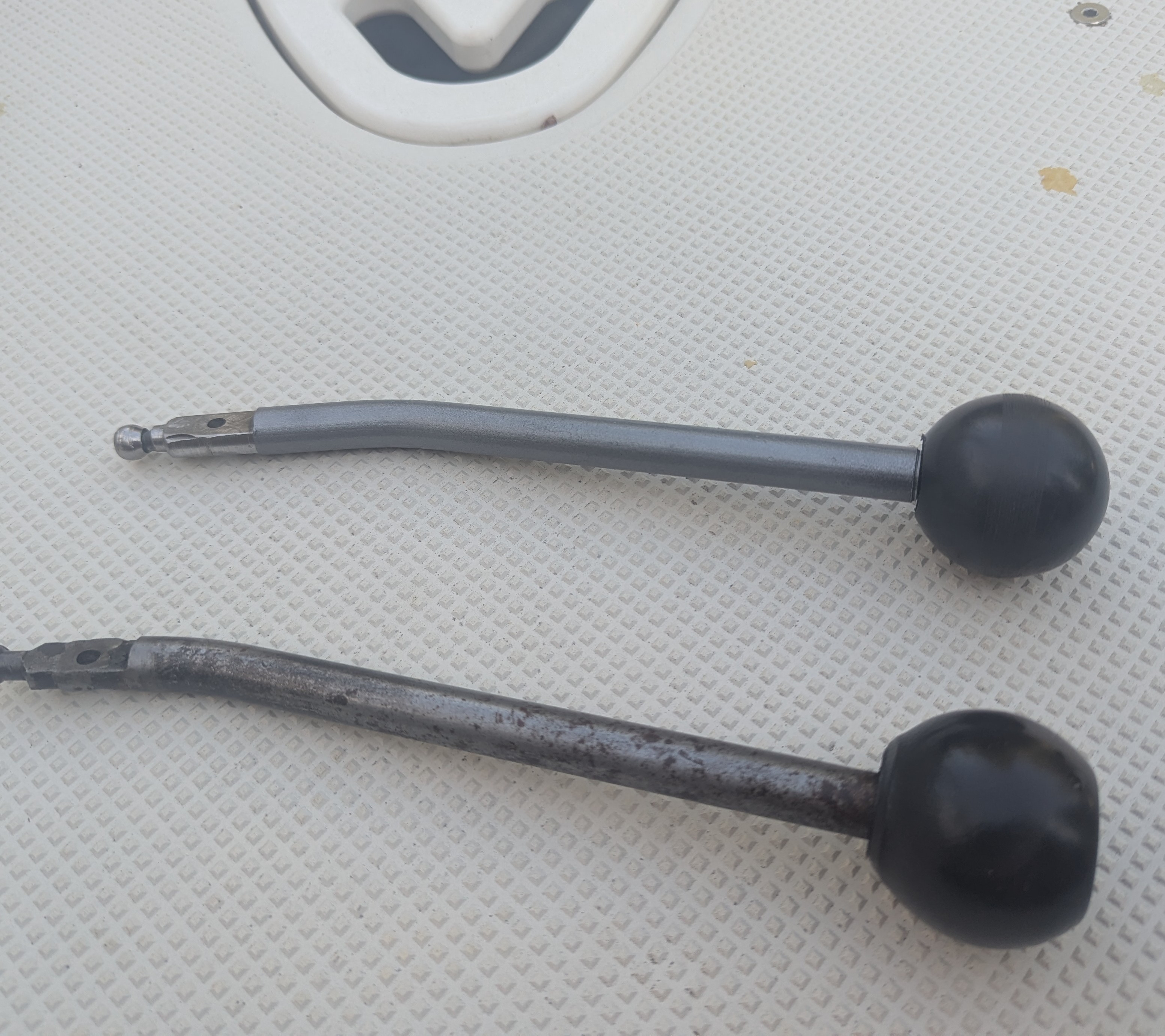

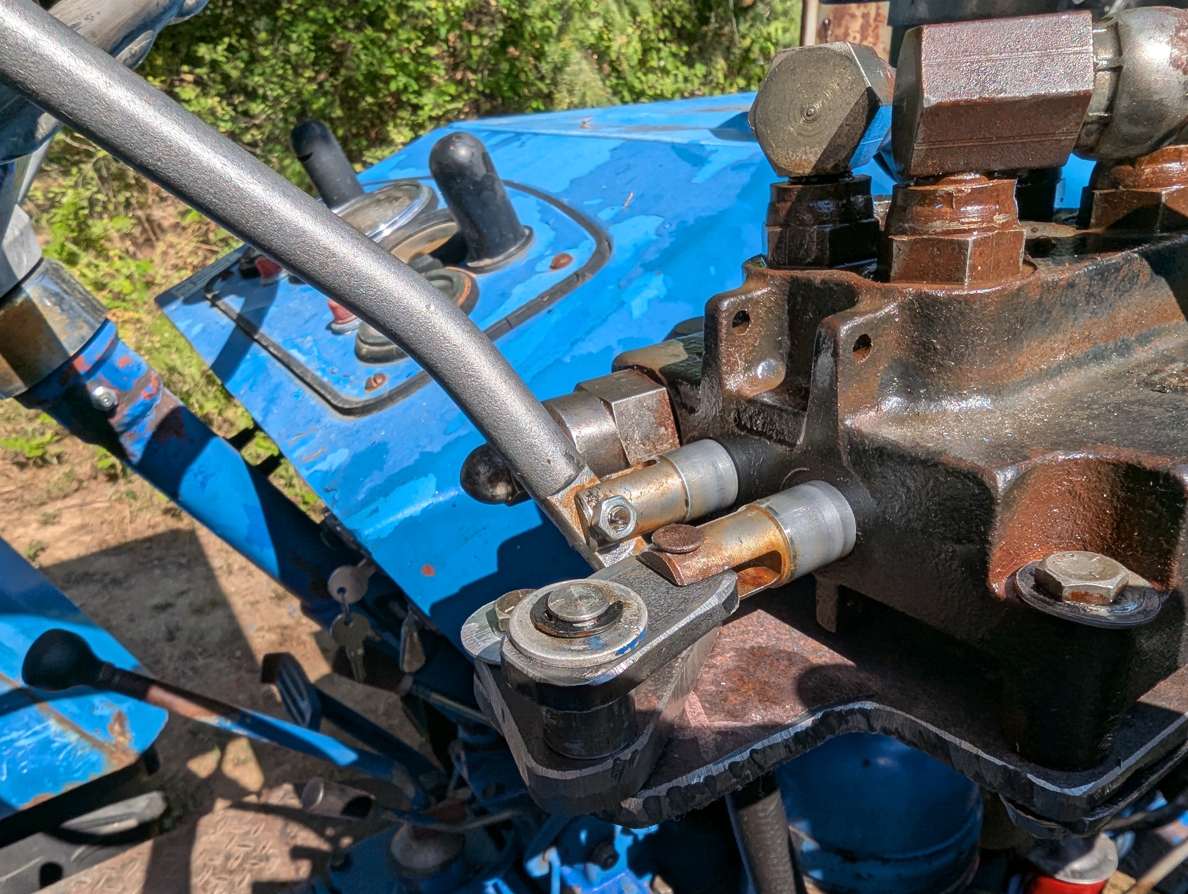

More work today curl cylinders are apart and now clean , just waiting on parts to arrive .
Also have grown to like the Joystick set up on the original tractor and am going to try and copy the basic design to modify the worn two stick handles on the second machine.
Hand plasma cut a pattern for the base tonight and the little actuator slide, out of 1/4" plate, looking through odds and ends for a control stick. ( think I kept a 5 speed shifter out of an RX7) :) only a few parts needed to build a copy and get rid of the worn out linkage for the individual sticks. Hopefully.
ps. The FEL by Koyker is very capable for this size machine and actually uses larger rods and cylinders than Kubota does up to the M series 90 HP tractors.
Probably one of the reasons been able to do things like like back dragging with the front tires off the ground and did not bend or damage parts, and lift ~3000lb on the forks on the 554 tractor over the years.
   / Bought a dirt cheap Rhino 554 as a spare parts tractor - New plan - get it into usable shape, after being parked outside for 20 years.

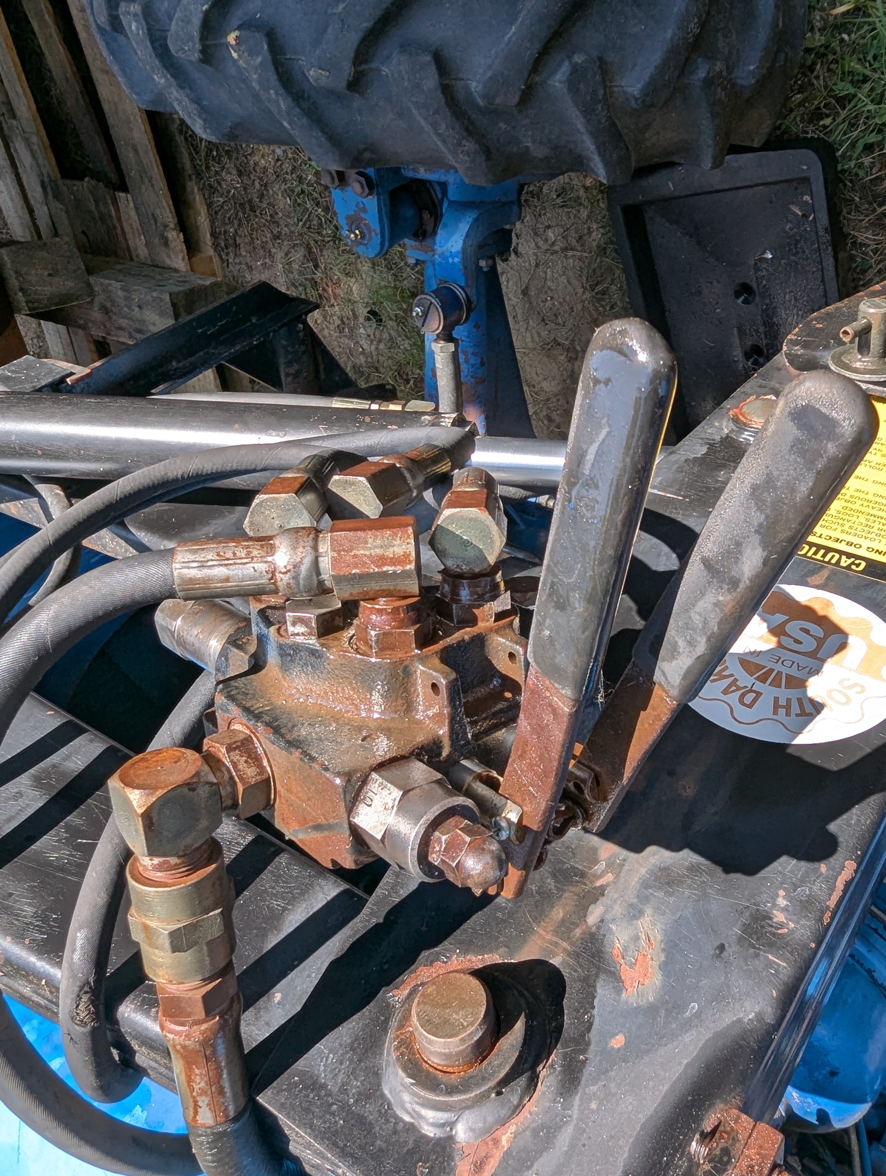

A little more progress,
Removed the repaired at on time joystick handle from the original tractor and made a similar copy but used a drilled and tapped for 1/4" course thread bolt welded into a 1/2 piece of steel rod.
Machined the sides down to fit in the Cross piston actuators and then machined the handle end to accept a 5/16 coarse threaded ball like the original.
The actuator end of the joy stick is a drilled and tapped for 1/4 threaded rod welded into the 1/2" rod to match the joystick end, using a dilled and tapped ball bearing lock tighted on should make it easy to replace if worn as well.
Need to make one more piece for the curl actuator and put a bend in the joystick. Just going to use #10 pivot bolts so they can be replaced easily when worn.
I would have bought a joy stick conversion kit from Cross but could only find them for the newer design valve blocks and the lowest price was $175 so home built it is.
