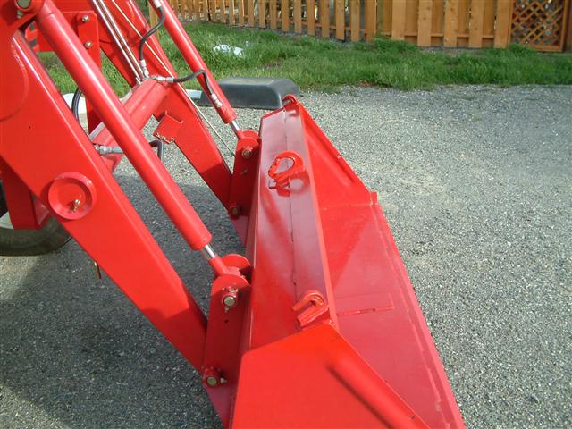

Hey Flusher, where did they weld the hooks at? i want to add hooks to mind, just wondering if there is a place not to put them and a place only to put them. thanks

On our ML266 had hooks welded on each end - side of bucket adds strength. Any where else on the top lip you have nothing below it to take the stress of the load on the hooks.

I thought about the sides, but was afaid the hooks might hang up on things, you are right about the strenght part on the sides. thanks

Like this:
Two grab hooks on the outside, one anchor hook in the middle. There's a 1/4" thick stiffener welded to the bucket then the hooks are welded to that stiffener. I bought the hooks at AW Direct
Gunnebo-Johnson Grade 80 Weld-On Anchor Hook w/ 4,400 lb. WLL - 3-3/4"H x 5"L - Mfg# 589357
