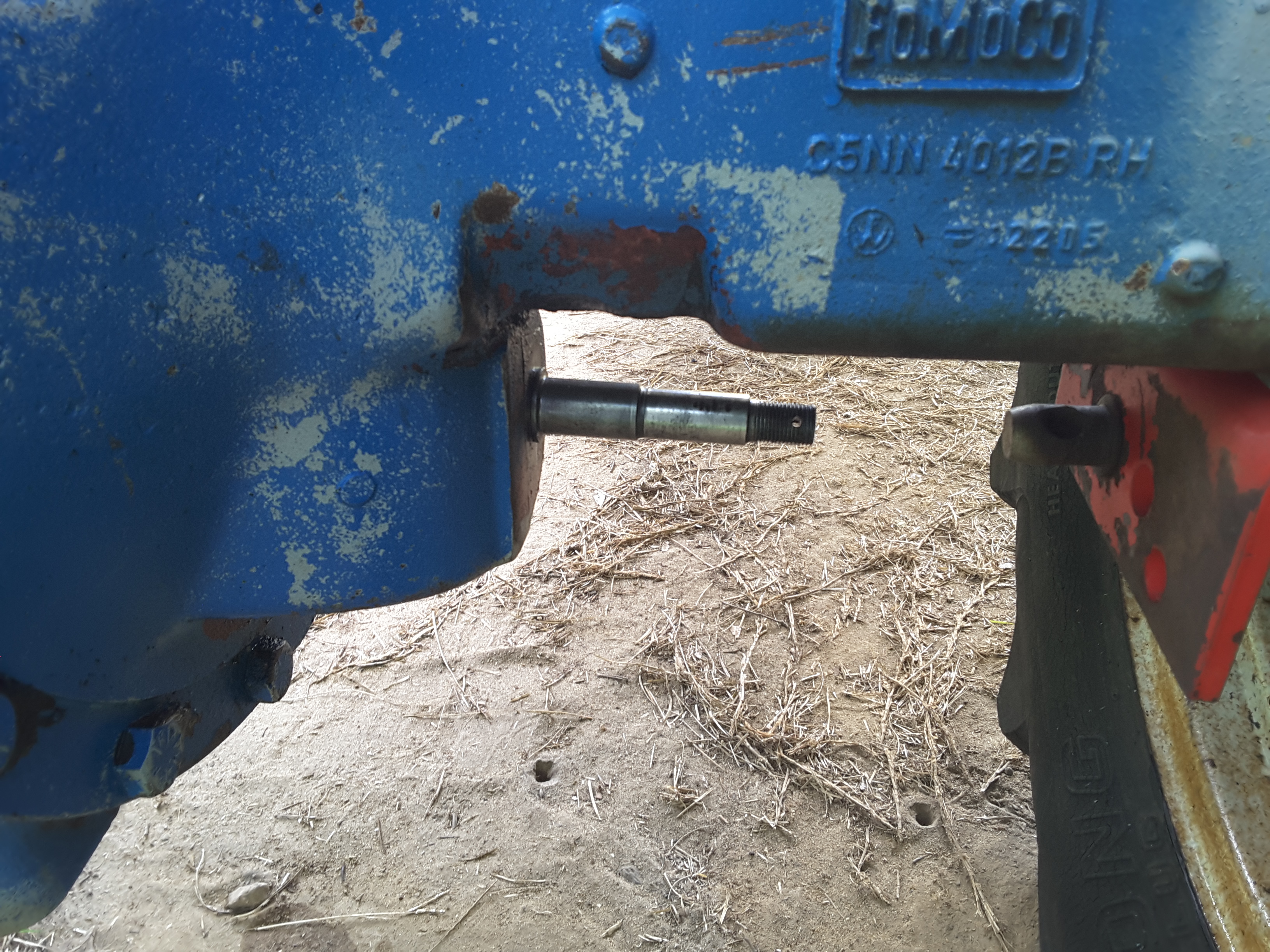

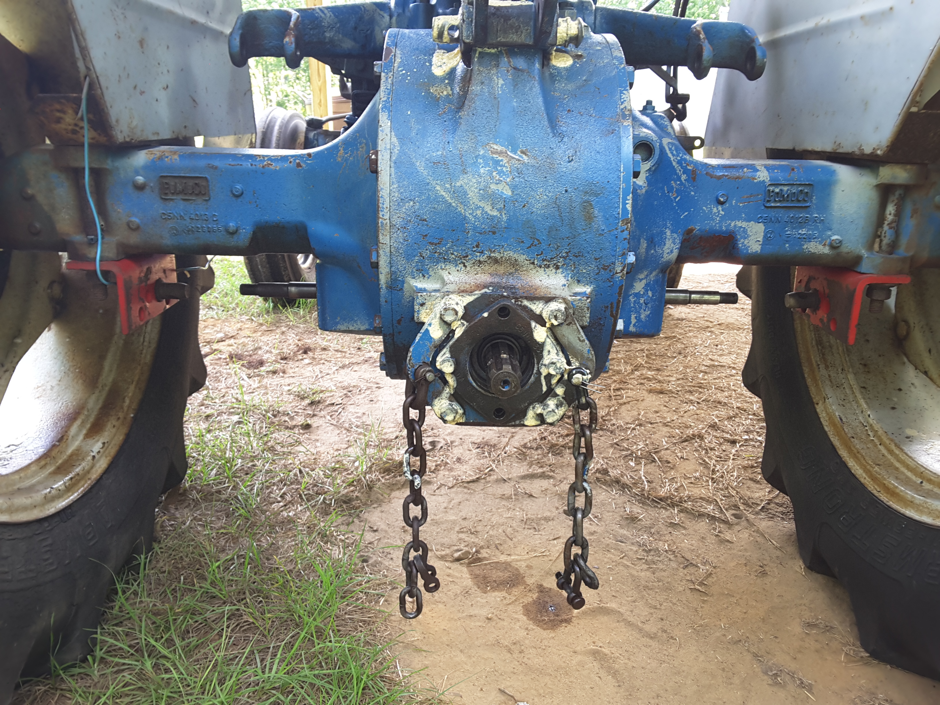

After removing 3 point to get to rear hydraulic drain plug I find shaft needs REPAIR. I can screw it in but won't tighten , but I can't get it to screw out all the way. Help please. HOW DO I remove shaft to repair or replace. 🤔 thank you. It's bottom right where lift arm attaches. Thanks.

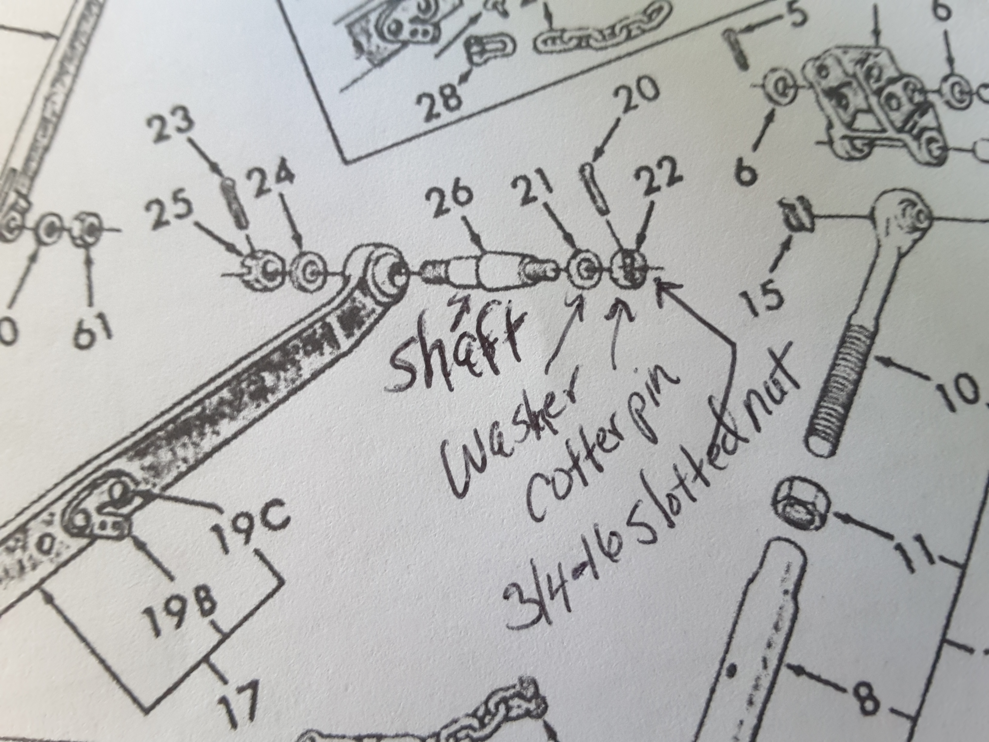

It sure looks like the axle half needs to come off.
Wheel assembly, then the fender, then any "doo dads" like brakes etc. Then un bolt the axle support housing. Look inside at the securing cotter pin and nut for the tapered seat 3 pt lift arm pivot shaft
Piece of cake! ;-) Heavy and oil intensive, but likely not too bad.

Like CalG said - that axle housing is going to be heavy. I'd let the oil drain for a good long time - less of a mess. Then it's just seeing why the inner nut won't tighten or loosen.
