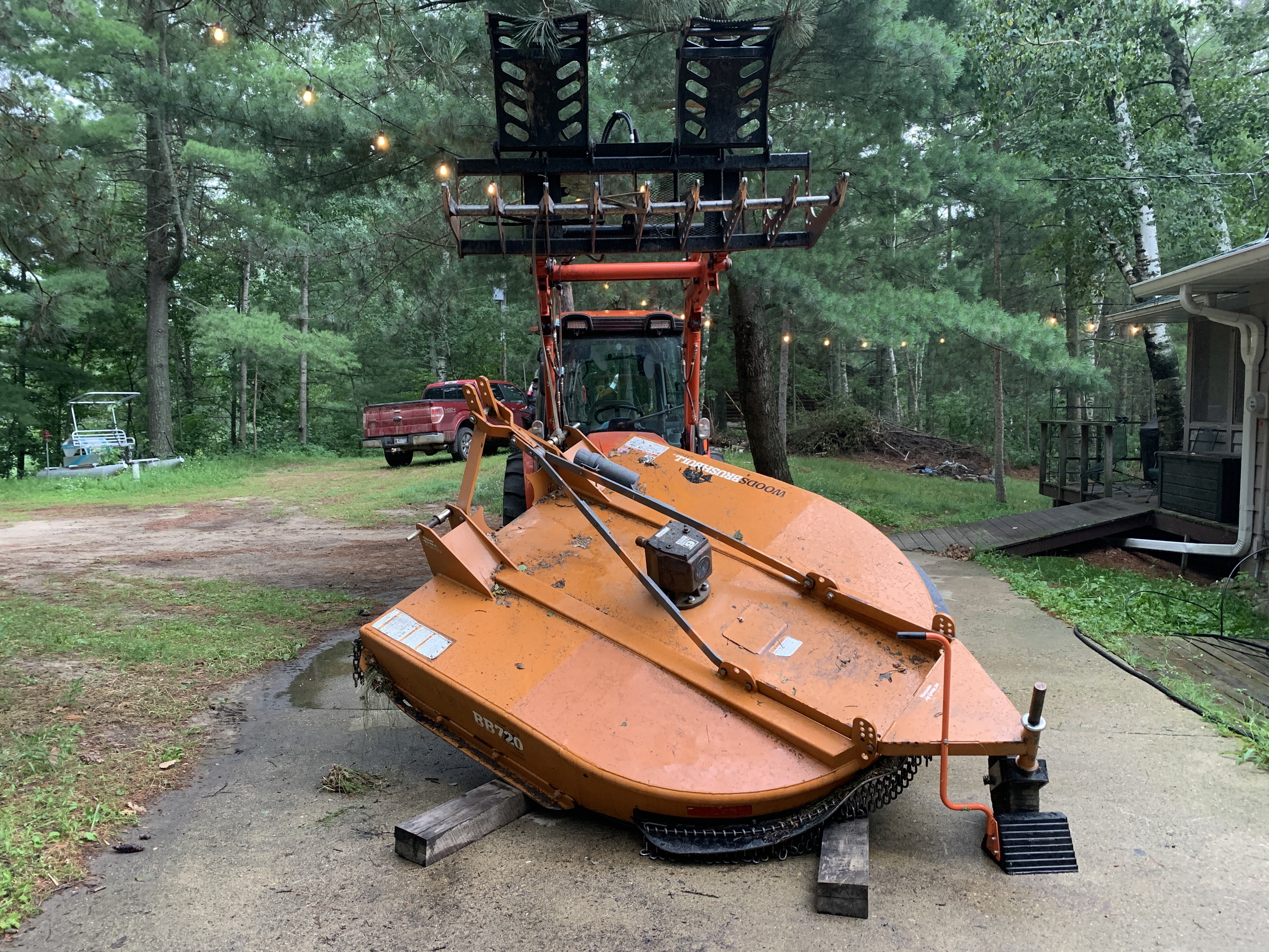

The bottom seal on my rotary cutter is so bad that even grease leaks out, and both the nut and stump jumper on the bottom of rotary cutters are notoriously hard to remove. As such, I anticipate needing enough room to use an acetylene torch, 1” impact tools, and anger under this thing while keeping it steady enough to not get squished like a bug.
Any tips from anybody with a been there, done that t-shirt? Like, is the nut left-hand or right-hand thread? (I haven't looked.)

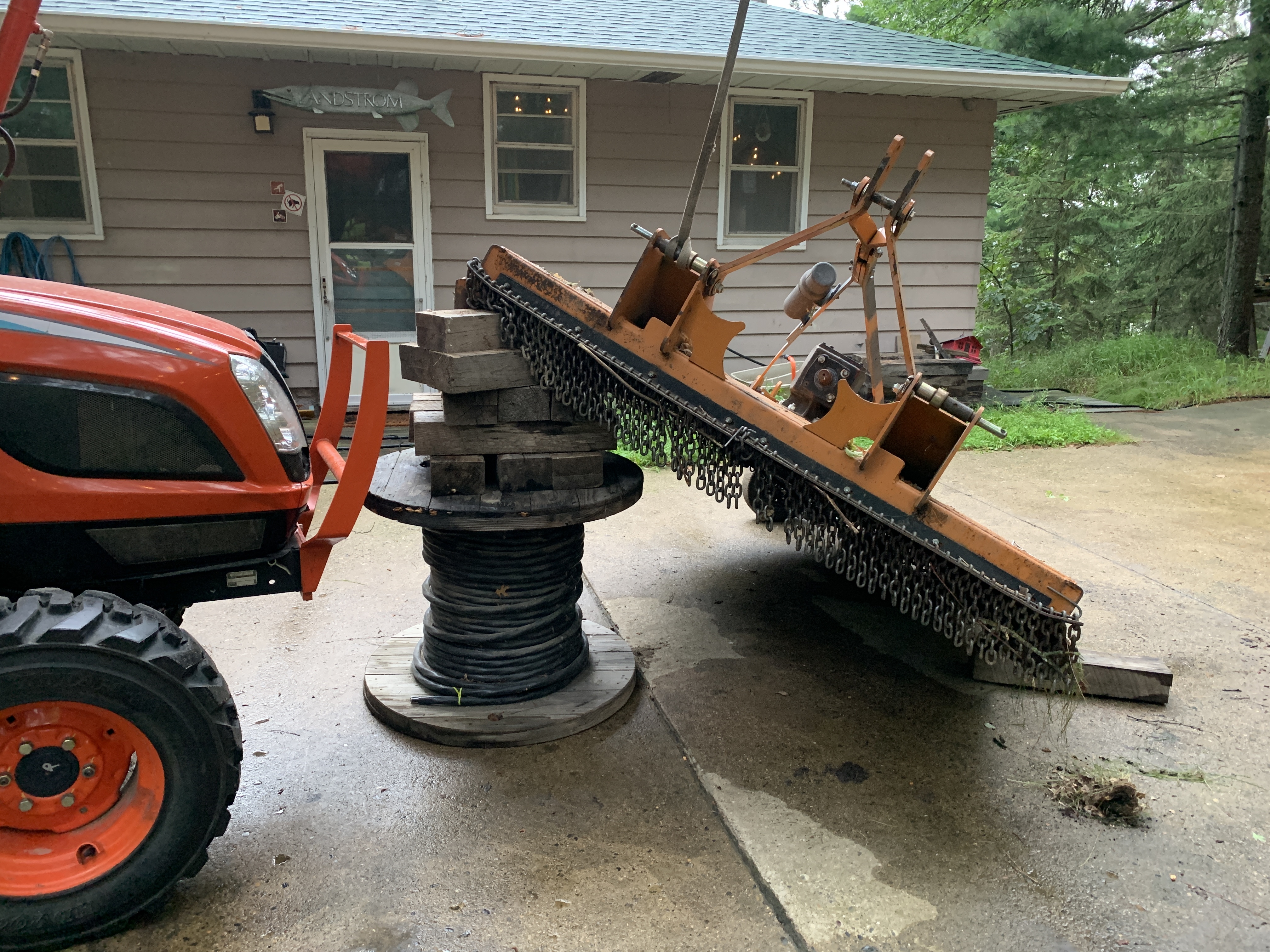

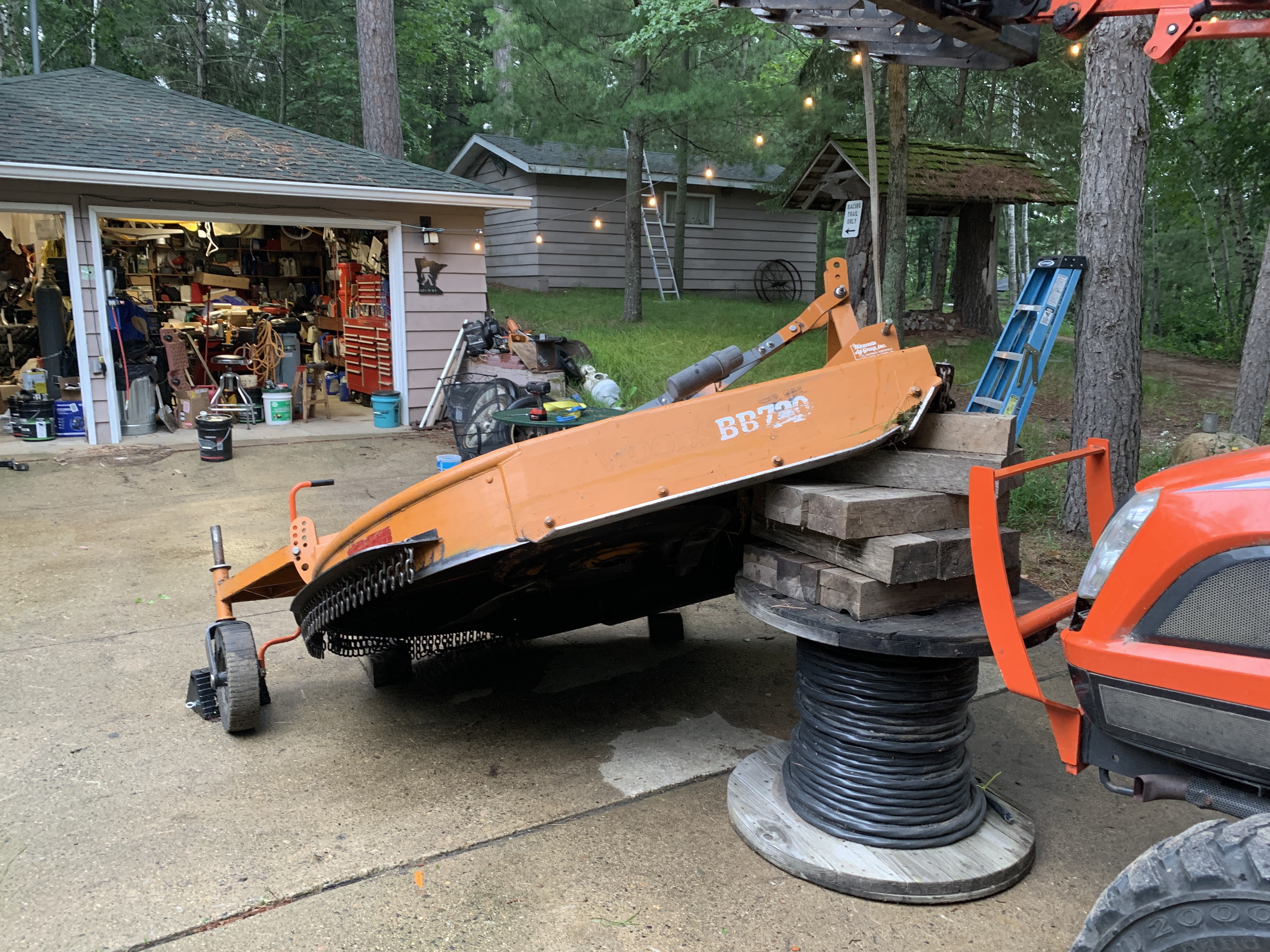

I just put this thing up on the wire spool and cribbing this evening as an experiment. The loader would be used only as a safety, but after centering the pull, I'm thinking I will bridle either one longer strap or bridle two separate straps to my loader. I do have a loader lock in, but I should make another loader lock so I can lock BOTH sides. The rotary cutter weighs just over 1200 pounds.

Is there any reason that you can't flip it over and set it on sawhorses so you can get to everything easily? I would do that, and tack weld a long bar on the stump jumper and put a cheater on the breaker bar, pull the two toward each other. If you have help, maybe an air hammer with a dull chisel on the edge of the socket to help it along.

I need to remove the gearbox so I can replace whatever is needed inside. That said, I'll find out how I need to hold the cutter from spinning when I look at it.

I’m not sure why you would attempt to work on it that way. Flip it all the way over.

Yes^^^at least stand it up on the front end with the wheel in the air. With one rotary cutter, I drilled and tapped a 1/2-13 hole on each side of the nut that holds the SJ on. That way I could use my puller to pull it off. Then, just grease up a bolt and plug the hole for next time.
