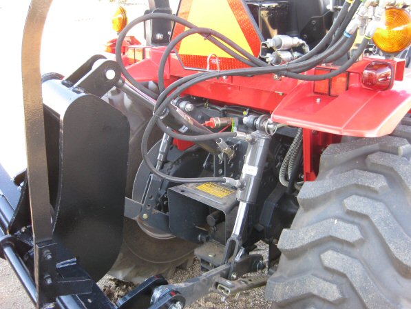

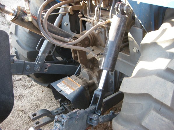

/pine, what tractor do you have? Sorry but I have forgotten and you don't have it listed with your profile. I make hydraulic top & side links for some extra $$$ and I usually try and match the diameter size of the cylinder to the diameter size of the FEL lift cylinders. Normally anything under 40hp will get a 2"cylinder, 40hp-55hp gets a 2 1/2" cylinder and 60hp and up usually gets a 3" cylinder. From what I've seen, John Deere uses 3" cylinders on all their "TnT" sets that they manufacturer, but I may be wrong with that assumption.
What have you seen the bigger cylinders on? I think that there have been a few guys on TBN that have made their own links and have used bigger cylinders for whatever reason. On my 3215 I used 2" and on my 7520 I used 3". These have worked out very well for me.

The cylinders that I use have 1 1/4" rods on the 2" cylinders and 1 1/2" rods on the 2 1/2" & 3" cylinders. These are plenty strong enough. How big are the rods on your stock OEM side links? I don't think that a rod on a hydraulic needs to be any bigger that those to have enough strength for whatever tractor & hitch that you may have.
