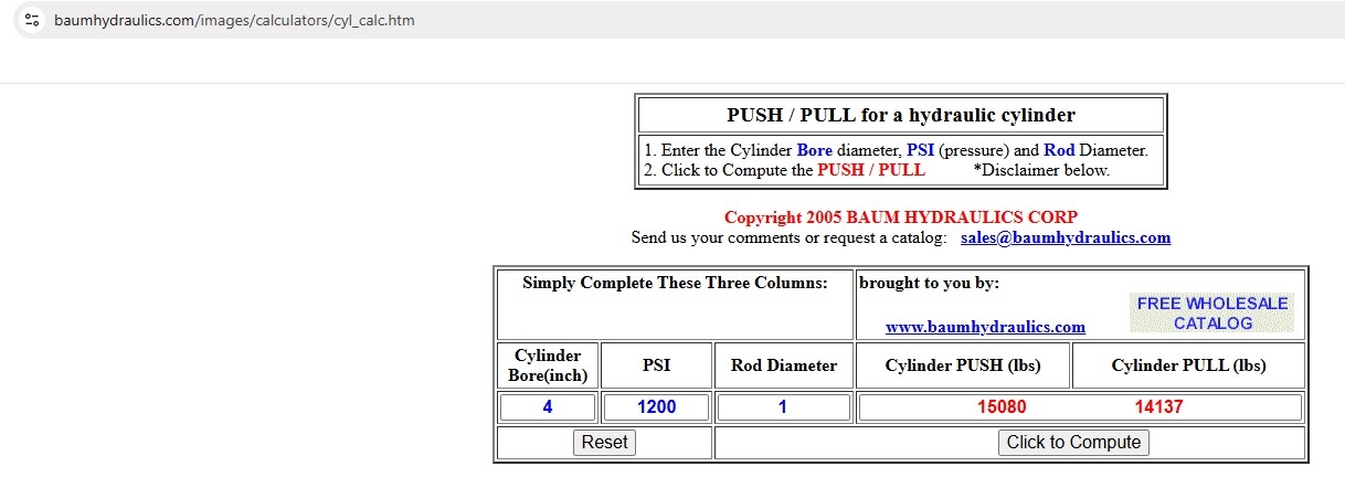

IF you tractor hydraulic pressure is only 1200 PSI and splitter cylinder id is 4 inches you are only getting about 7.5 ton ram pressure...(you only care about push pressure)...
Even increasing pressure to 2000 PSI will only give you about 12.5 ton....
Most stand alone splitters with only 6.5 hp motors can develop 22 tons... I do primarily oak wood and my 22 ton splitter has to strain on some.... Would not consider anything less in tonnage (22 ton) unless it is really softwoods....

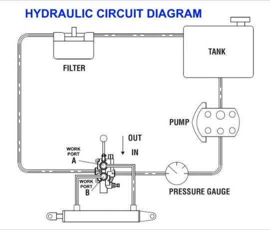

My knowledge is old and broad, not just Fords. I may not know the old JDs inside and out, but the hydraulic system in those are basic gear pumps.
One thing no one has mentioned, whenever you adjust pumps, you need to have a pressure guage to determine what pressure the relief is opening.
Your pressure may be low anyway being it is an old tractor, but it wasn't made to operate at the higher pressures that today's hydraulics ooerate.
Midifiying your splitter by adding an engine would be the best
