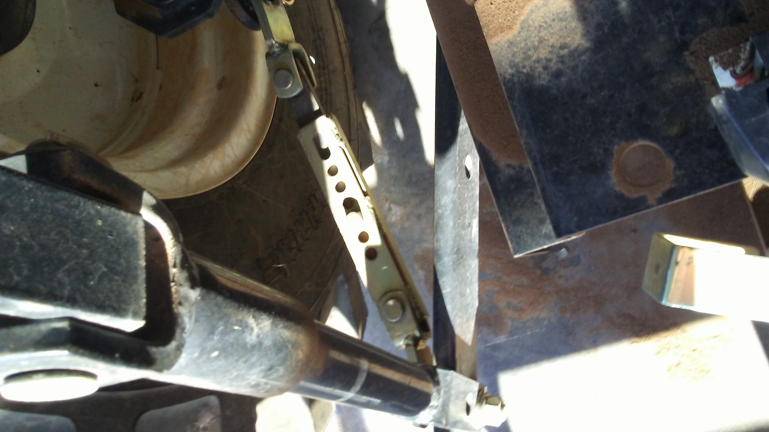

First goto your local steel shop and purchase 16" of bar stock, 1/4 x 16 for a pair of them.
Drill a 1/2in hole close to one end and attach it to the tractor, then slide the 3 point piece onto the bar and mark it for a 3/8 in hole for the bolt. I used a grade 8 bolt.
You can move it wherever you like before marking it. Multiple holes can be marked if you like. I just drilled one.
A lot cheaper than $100.
If the pictures aren't big enough I can do some more using my camera rather than my phone.

Why did you need to fix your stabilizer bar?
   / boomer 35 stabilizer fix - cheap fix
One of them broke and the other one was bent, rather than pay $200 to replace them I came up with this fix.
   / boomer 35 stabilizer fix - cheap fix #4
Nicely done. Happened when pushing with the 3 Point?
yep, for $100 they seem cheaply made. My hydraulic hoses on my loader weather rotted in just over a year and tractor was parked under a carport. You could probably use a bit thicker material than 1/4 in. I bought 24 in of it and basically got 3 pieces.
