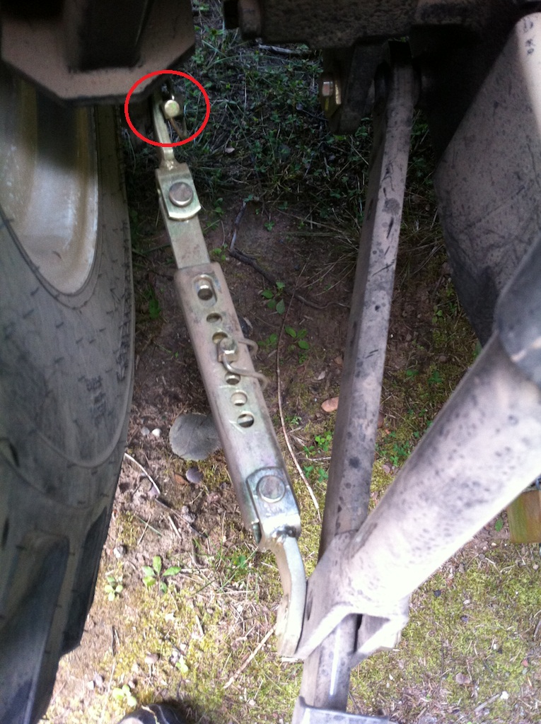

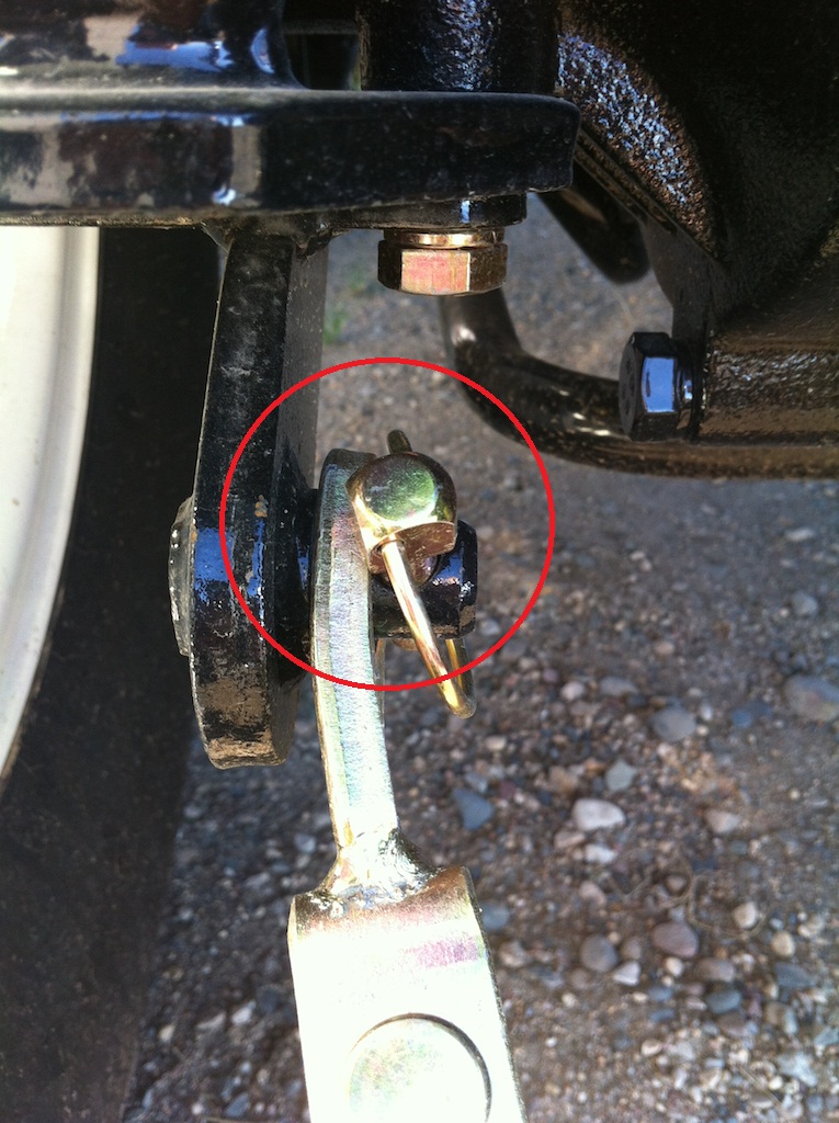

Tonight, I talked them into giving me the correct part from the tractor on their lot while they sort out their supply issue. While I was there picking up the part, I wandered around their lot looking at their older used tractors to look at how they did their mounts. When I got to the donor tractor, I realized exactly why mine failed. The squared off top of the lynch pin was riding up on top of the stabilizer arm and looked like it would bind because the stabilizer arm has a curve in the plate that goes over the pin. If you only moved it up and down a few inches, it was fine. If you try to move the stabilizer bar part up and down, the lynch pin essentially becomes a wedge which pushes out the pin snaps the mount. If it doesn't snap the mount, it is likely to bend the stabilizer bar.
So, has anyone moved the 3pt hitch bars from the bottom hole to the top hole and bent a stabilizer or broken the mount?

So far it is looking like the solution costs about 50 cents. The factory puts lynch pins that have a big mushroom head on them, which catches or binds and either bends the stabilizer bar or becomes a wedge and snaps the mount in two.
If you take the factory pins out and replace them with pins that have a smooth side, there are no issues.

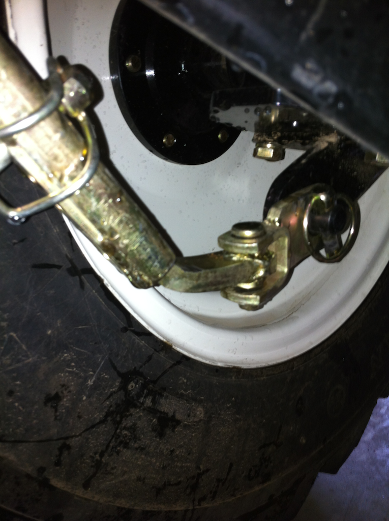

On the left side, the stabilizer bar could not slide by the pin and it completely bent it ($80 assembly, bent part not available for order separately).

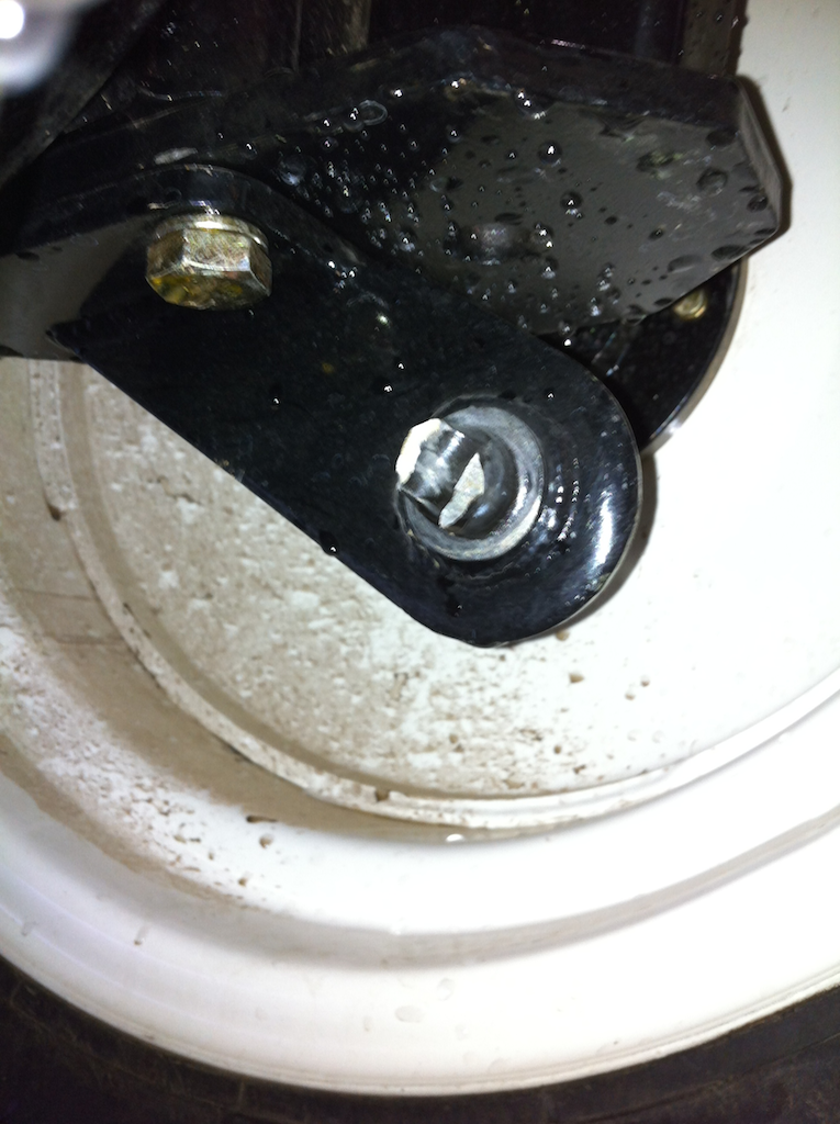

On the right side, the stabilizer bar was able to slide by the pin and it became a wedge and blew the end off the stabilizer arm pin ($120 part)
The ultimate problem is the wrong pin was used. Here are close up pics of both my tractor and the one sitting on the dealers lot. Having one at the dealer with the same problem made it very simple to get the replacement stabilizer and the mount covered under the New Holland warranty. Notice when the pin twists, that the bar cannot slide past it.

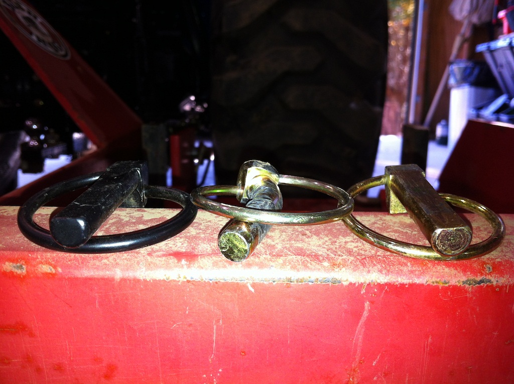

The solution I have found so far is to simply use a different style lynch pin. In this pic, the center one is the one delivered with the tractor. Notice the fat head that overlaps the round part on all sides (the center pin is flipped over compared to the other two, but it overlaps on all sides). The overlap is what is catching on the bar and causing the problem. You can clearly see where it is rubbing, grinding, and catching. I was checking everything else on the 3pt system for binding, but never thought I needed to check this part. Not to mention when the pins are straight they don't necessarily catch. When they vibrate and rotate is when they catch the corner the most.
The solution is the 25 cent pin I picked up at tractor supply (right--I dug through the bulk bin to find the smoothest ones) or the heavy duty pin the dealer shipped me on the (left). Notice how both of these are ground down and flat on one side.
