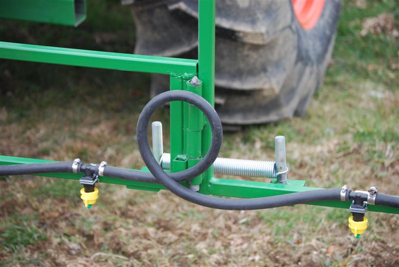

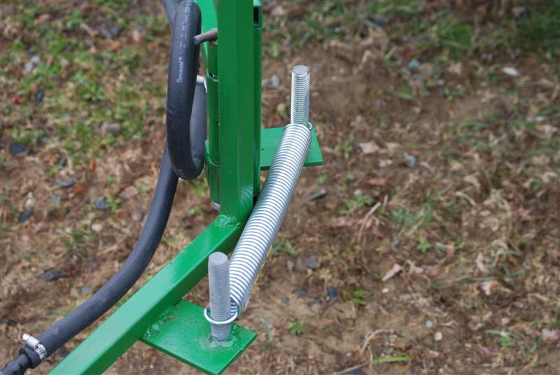

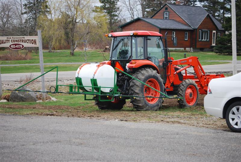

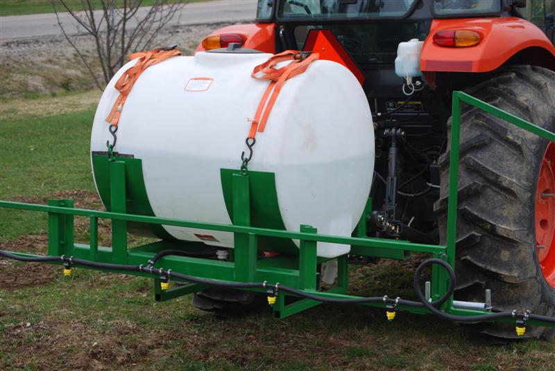

He's a 150 gallon sprayer I just built. It has 24' booms that fold for transport.
there's also couple of shots of the hinges on the booms. Frame is made out of 3" tube, booms are 1" square tube 1/8" in the middle section 10 gauge on the outer sections.

Nice job ! The Green looks pretty good on the orange too.
