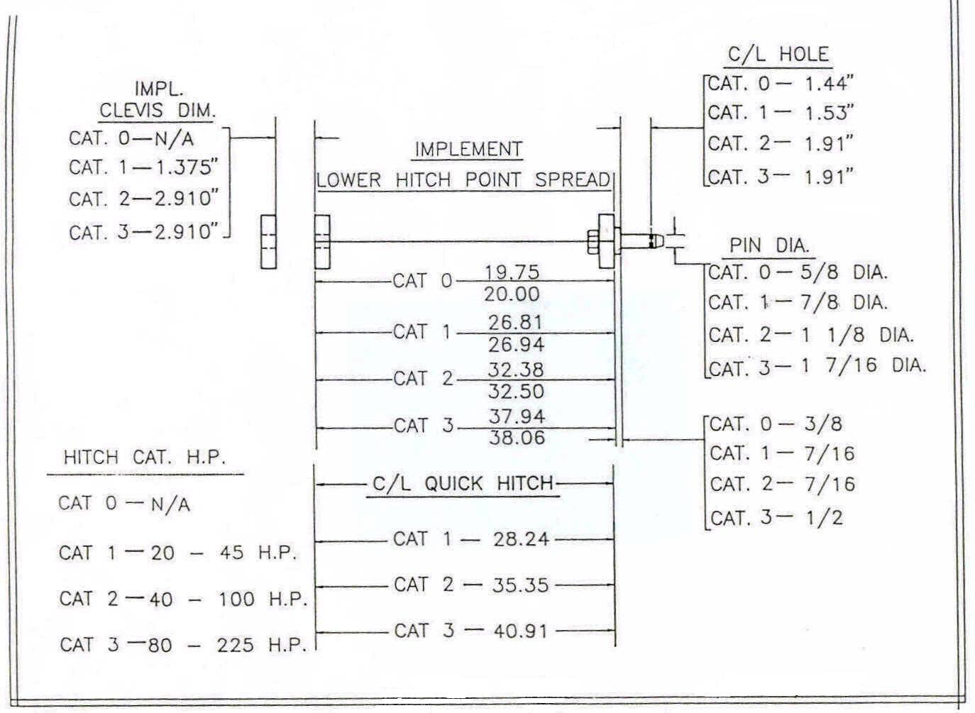

Can someone give me some measurements for a boom pole for a JD 5083E. That would be the width at 2 pin hookup and the riser height where the third pin goes. I may make up one out of 2x4 wood just to get an idea. I plan on building this out of 3" schedule 80 pipe with the 2 side braces made from oil field drill stem pipe.
I would appreciate any help.

Mike, please accept my apology. I was in a rush to get off to work and thought maybe you were overlooking the obvious (as I do myself sometimes). I looked up your tractor and it listed the hitch as "2/1". My tractor has a Cat 1 hitch, and I'm not familiar with a combo hitch. I measured mine tonight and can tell you that on my tractor the lower arms need spread roughly 27" to the inside. I have different attachments and they do vary slightly. The toplink connection on mine is about 17-1/2" above the lower pins. These measurements were taken on the 6 foot rear scraper blade (that unfortunately seen no snow this year). Hope that helps.

with jbooths diagram chart and chim's height measurement, you should have what info you need. If not, one of us will start measuring for you.

When I went to the dealer to pick up my tractor, I asked the dealer does it come with a drawbar, and he said yes. It should be on the tractor, No, I said. We went to look and he pointed to the square bar that comes out just below the PTO shaft. I told him that I meant the flat draw bar with the holes in it that goes onto the lower lift arms. He said you mean the [something]. I forget the name, but I said yes. I bought one, and it was a little over $70.
Anyway, I just measured the drawbar [?]. I guess I need to know the names of these tractor parts in order to communicate with you guys.
This bar measures 31 3/4 from pin to pin hole and 26 where the inside of the lift arms go.
Jmc, this measurement of 26 inches wide confirms what I have found on the width for a category 2.
Yes, that is it jbooth. This diagram shows a 32 cat 2 spread. Thanks!
