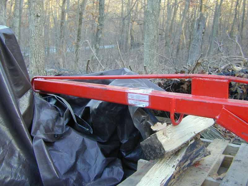

/ Boom Pole #9
I recently purchased this boom pole - but since I still have my snow blower on my tractor I have not tried it yet. It looks real heavy duty and is rated at 2000 lbs. capacity.

The price I paid was $120 new and $25 shipping. This is another photo. I ordered it from Ringo Hills Farm in Pennsylvania. I also have a carry-all from them that is well constructed.

All boom poles magnify the movement of the three point hitch and, if you have a hydro. top link, you get even more bang for your buck. I use mine to put seasonal implements into a storage container. The extra reach works very well.
One warning, most poles will move more weight than a small tractor can safely handle. Tractor tipping anyone?/w3tcompact/icons/shocked.gif
