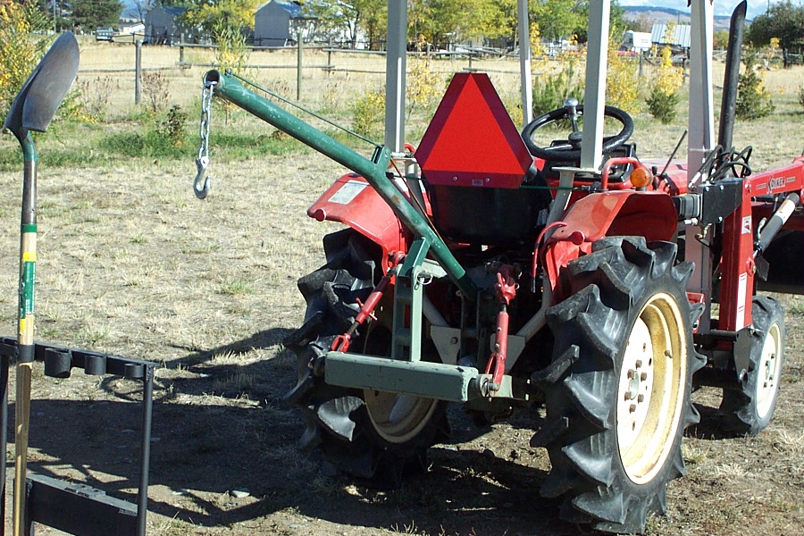

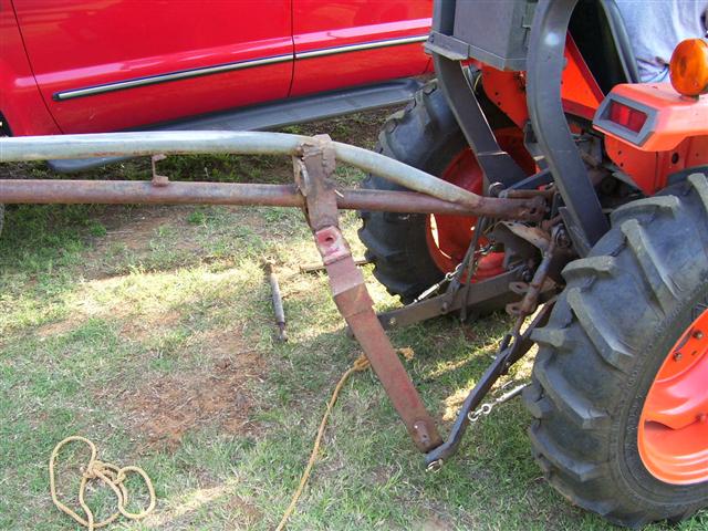

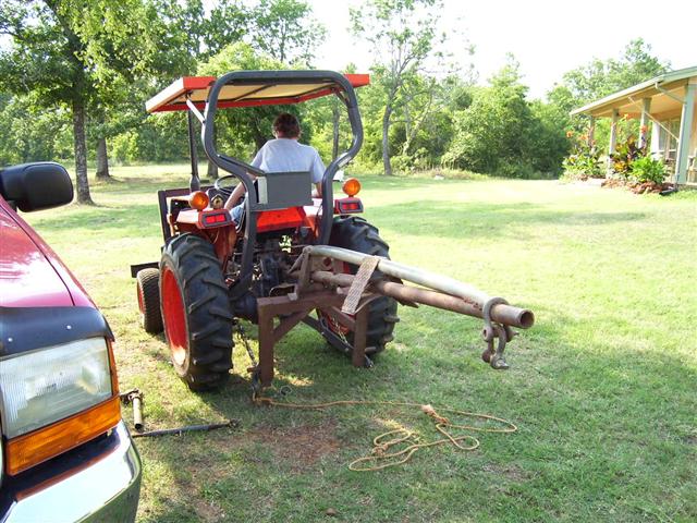

Looking for some thought and such regarding boom poles. I need to make or buy one and it's main purpose will be to lift my boxblade, BH or other item into the back of my pickup. I need this because my trailer will only hold the tractor and one implement (99% of the time).
By brother in law had this homemade sucker. huge, heavy and I had to have help to put it on. But I noticed the geometry is different that the new ones. On this one the main pole attaches to the top link position. The pivots as the lift arms move up and down. The one I saw at TSC ($90) attaches to the lift arms and the upper link rod.
Is there more lever action with the pivot arm or is it really just the same thing. I haven't graphed it out but wonder of one is better than the other. Both about the same to make it seems.
Show me some pics of you homemade boom.
Attached are some pics of this one. The lift arms would actually go higher but the upper arm would hit my toolbox on my ROPS.

The main difference I see with the one pictured is that you loose a lot of flexibility by not having an adjustable top link. There might be times when you could hook to a load much closer to the ground, thus lifting your load higher. The bulk in the reinforced boom at the top link attachment point is not of much use because the load is in tension at that point.

You will get more movement out of the first one pictured due to the geometry of the set up.

The only real difference is that the one shown in the black and white photo will apply some compression load(forward push) to the main 3PH lift arms. Since the arms are most likley already spread out(narrower where attached to the tractor, wider where attached to the base of the boom pole structure) this will probably actually be seen by the arms as a bending load. Since the arms are usually flat material, with a rectangular cross section, you would be applying force in their weakest(thinest) axis, kind of like pushing backwards with a box blade. The one shown in the attached pictures of the first post will only apply a vertical force to the lift arms as the top of the arch or "A" frame pivots where it meets the boom pole. The truss design pictured converts the side loads felt by the boom when lifting a load into compression and tension loads. The top portion of the boom truss dosn't need to be as big as the main boom pole as it is in tension only. It could be a piece of flat strap as long as it's cross section is large enough to handle the tension loads involved(look at some pics of engine hoists or the top material used in the black and white boom pole pic). The design in the first pics is similar to the one used by Leinbach on it's post hole diggers.
As for lifting the front of the tractor off the ground, you would need to have the same weight/moment arm behind the axle as is in front of it. I think you would far exceed the hydraulic safety valve setting on the 3PH hydraulics(the one that vents fluid if you bounce a heavy impliment and limits your 3PH lift weight) or the strength of the 3PH lift arms, or the structural integrity of the boom before that happened.

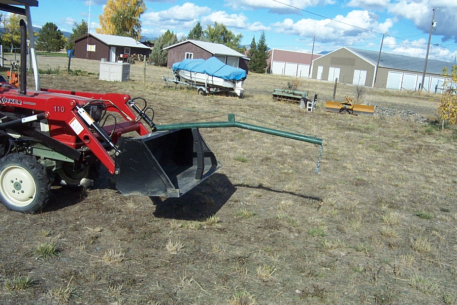

Rob J
I hope to attach pix of my home made boom pole. I also attach it to my FEL
bucket. I use it to lift my Miller Bobcat welder onto its stand
