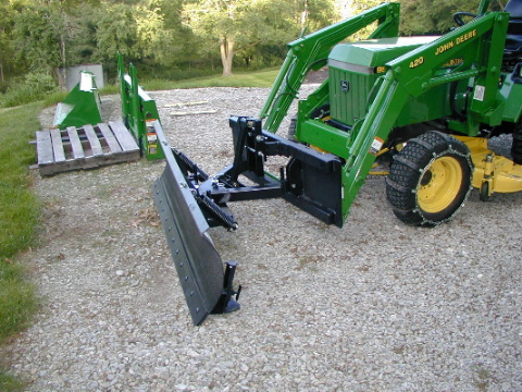

I own a 420 loader and have the blade you are considering. See the attached photo showing the bucket, pallet fork, and blade.
The blade is well built and would be suitable for clearing snow. I do not have the hydraulic angle kit. If you look in the PARTS manual for the 420 loader it shows all of the details of the blade and the hydraulics.
I have only used the blade a small amount since we didn't have much snow last year. When the blade is angled, it wants to push the front of the tractor sideways so you have steer the opposite way to keep a straight heading. In addition you have to use the foot brakes on the left to assist in steering. Steering is not a problem unless you have a big blade load.
I have not used the blade to move gravel or soil.

That's a really nice looking installation. Did you consider mounting the blade to the FEL in place of the bucket? Would the extra distance the blade would be in front of the tractor make it harder to use that way?
/ Boom Mounted Blade #10
I gave some thought to the bucket blade, but didn't want that blade further out in front of the tractor than absolutely necessary. It makes controlling the direction of travel that much harder. Even with the blade close to the front wheels, there are a few times when on a slope (in and close to the ditch line) that it is hard to control the direction of travel. Steering with the rear wheel brakes helps some, but all would be much harder with the blade on the loader arms. I also had a similar plow on my old 2-cyl JD 420, and liked it so much that changing to something else wasn't much of a decision. I have never found it a problem pushing snow up on a pile. I also don't find it impossible to keep the snow pushed back from the side of the drive. Albeit I don't have a house, bushes, or other structure that restricts me from pushing the snow back when it is time to do so.
