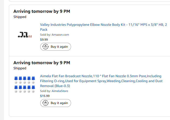

I ended up ordering this yesterday. I figure I'll be able to find some scrap, or worst case scenario some old 2x4s for the "boom" itself in the short run.
