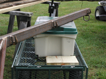

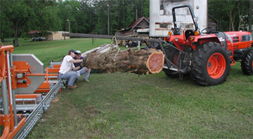

Well after a few long hrs. of welding this boom is better than any I found for sale at farm stores near me. I tested it monday loading a heavy cedar log on my sawmill.

   / boom design works good
here is a photo of the boom at work.

What type of saw rig are you running? Come on now take some more pics and show us that nice looking tractor and saw rig in operation please. /forums/images/graemlins/wink.gif
Re: boom design ifo specs
Ok Clint sharpen up your lead. The overall length came in around 10'+ a few inches starting at the pin center points.
8' of 2 x 3 x 3/16 tube & 36" on sloped part I think. Braces
are 1 x 1 x 1/8th x 52"(could be a little longer say 55"). Weld rods were 6013 & was done by stick. 6 5/16 Grab hooks were purchased thru AV(tow industry retailer) D ring on end was a 10K lb rated weld/bolt on from Agri supply co. Lower link steel was 3 x 3 x 1/4 angle steel with pins welded on.
The worst task was cutting the conpound angles on the braces to match the 2 x 3 & the 3 x 3 horz. piece. THL flange pieces were 1/2 x 3 x 16" unwelded with 3/4 galv. bolt. My tractor is the Kioti DK-50.

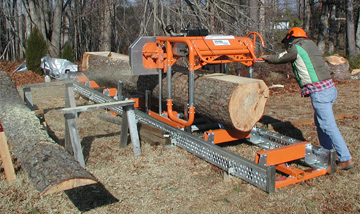

#9
here is some saw photos guys.

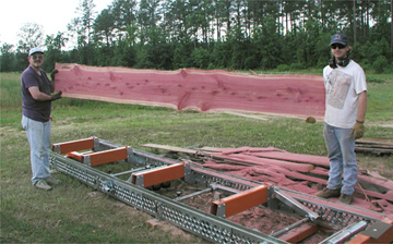

this was a giant pine I worked on.
