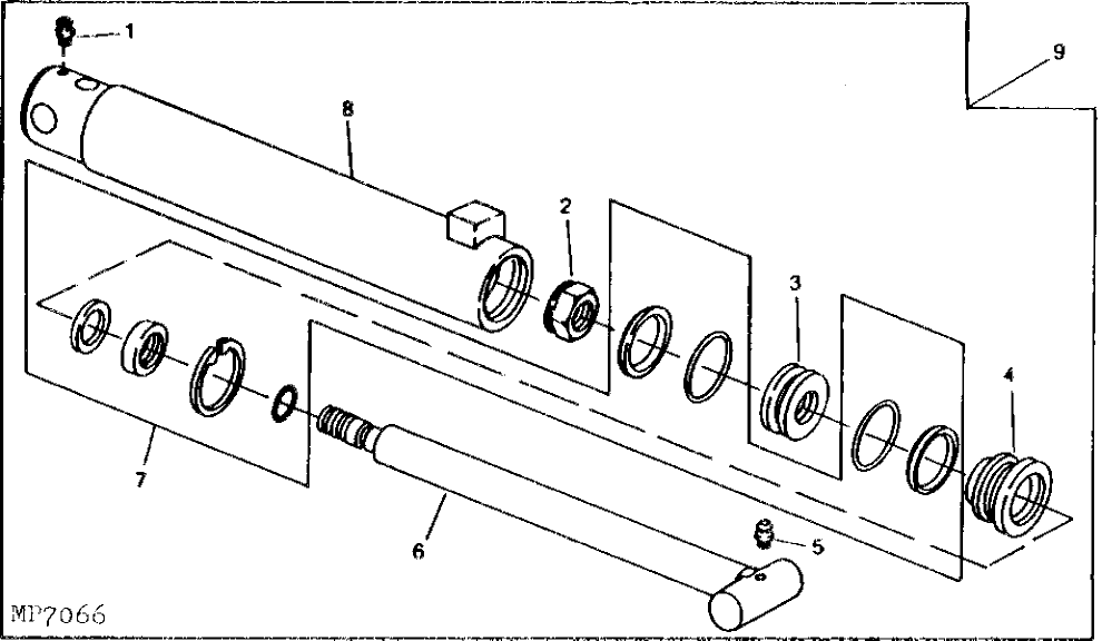

I have a 1997 John Deere model 70 loader on my JD770 tractor. One of the boom cylinders (right side) drips hydraulic fluid where the rod enters the cylinder. As far as I can tell, it doesn't drip or leak when I am using the loader (the rod is dry). After I shut the tractor off it drips about 3-12 drops over a day or two then stops. Sometimes it doesn't drip at all. The cylinder has done this since I bought the tractor about 6 months ago.
I suspect that when the cylinder is pressurized that the seals are sealing fine but after the pressure is removed when I turn off the tractor that a seal may relax just enough to cause some minor dripping. Is this serious enough a leak where I should buy the seal kit and replace the seals in the boom cylinder or should I wait till the leak gets worse? The other boom cylinder (left side) doesn't leak. The loader seems to work fine as is.

To fix or not to fix...it's really your call. You are probably correct about why it does not leak under pressure, so if it was me-I might get the kits to have on hand and rebuild them at my leisure-maybe over the winter or another time when you don't need the loader for a while. You should do both cylinders at the same time also.

I decided to rebuild the boom cylinders on my model 70 loader, but I have a few questions before I get started:
1. Only one of my boom cylinders is leaking (right side). The left side is fine. What is the reasoning that it is recommended to rebuild both cylinders at the same time? I plan on rebuilding both - just curious of the reason.
2. On the schematic I originally posted for the boom cylinder, how does the gland assemply (#4) come out? There is a snap ring. Will it come out with a good tug on the cylinder rod after the snap ring is removed or does it also screw out?

   / Boom Cylinder Dripping - Need Advise. #6
They both have the same wear&tear on them-and both have been in there same amount of time. And if your luck is like mine the other would start leaking a week after the first one was fixed. If it wasn't for bad luck sometimes, I'd have none at all:D
Same thing goes for tires, brakes, shocks, headlights, windshield wipers, shoes, socks, gloves....they should always be replaced in "pairs".
Yes, after the snap ring is pulled, the rod should come out.

   / Boom Cylinder Dripping - Need Advise. #8
I left my loader on the tractor and completely removed the cylinders. Just be careful the it does not move.
There are lots of different way's to close cylinders, from retaining wires, threads, internal locking rings, internal snap rings, external snap rings...
Notice that they include a new snap ring in the seal kit also.
   / Boom Cylinder Dripping - Need Advise. #9
Disconnect the hoses and use the rod as a slide hammer to remove the gland.
