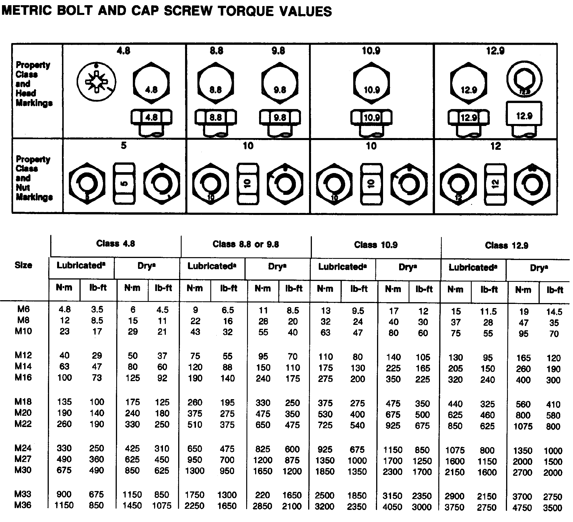

I have a 2018 ck2610 Hst and notice that the bucket bracket that attaches to the frame are lose. I cannot find a bolt torque for the M14X1.5 bolts. I also have one that is stripped out and need to put in a Helicoil.
Looks like some bolts could be 5 mm longer and get better engagement.
So, where do I find a torque for this 14 mm bolt?

Torque values are usually listed in your owners manual, I know Kubota has a full page of them. Look in there.
   / Bolt Torques #3
If it’s not in the manual just use a generic torque chart.

Thanks for the information. Kioti does not provide all the torque information in the owner's manual. I think buying a service manual is the best idea.
   / Bolt Torques #5
Another idea is to apply a bolt marker once they are properly torqued. I applied it on the undercarriage and lug bolts. Easier to apply this so you can check visually instead of crawling under with a torque wrench
