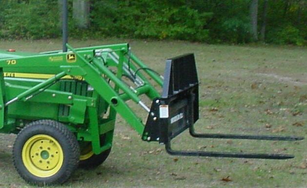

Yes there are bolt on pallet forks, they clip to the lower jaw of your loader,
then you ether tighten a bolt or wrap a chain around the bucket.
Check around you local tractor or equipment dealers. Just about everyone
I talked with had or could get ether type of forks.
I personally didn't like the bolt on type an chose to go with a unit
that replaced the loader bucket. It was about the same price as
the clip/bolt type. I chose to go with the Woods model 20 A forks
but there are other brands but becareful make sure the forks are
solid not hollow...
See attachment:

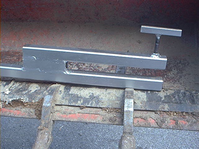

Here's some pics of some forks I made out of some scrap steel I had laying around. Total cost about $15 in materials and strong enough to use with the capacity of my loader (800 lbs)
   / Bolt on Forks? #8
closeup view -
   / Bolt on Forks? #10
My skills don't extend quite THAT far! My next project though is to build a bolt on extension to my loader bucket. Plan on adding about 18 inches more to the bottom with sides. Should about double my volume capacity and will work well for moving my piles of mulch, leaves, and horse manure. and hay bales. The stuff is light enough that I won't exceed my lifting capacity and I should be able to do it all out of some scrap 1/4 inch plate steel my brother in law has laying around. (Gonna take some torch time to cut though......)
