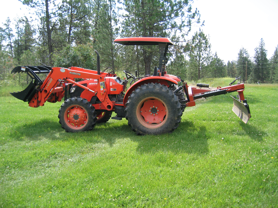

I have a mile long gravel driveway. I use my Rhino 950 rear blade on my Kubota M6040 to clear snow.
Reversed if the ground is still soft - normal if it's nice and hard. At 1100# the Rhino never bothers the gravel if I follow this method.
