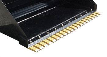

Anyone know the bolt hole spacing on the TL7 bucket..I think its a 54" bucket??
I'm looking at this toothbar for the bucket, the holes are 6" spaced.

Generally a tooth bar is only held on with 2 bolts through the side wall.
Looking at that picture of the toothbar I would never sell or use one of them, the way that is designed it looks as you would be able to bend you cutting edge eaisly.
Get the one that slodes over your cutting edge.

Take a look on E-bay.You can get a custom one there for about $200 + shipping. I got one from Bobcat but it list for about $500.
   / Bolt hole spacing on bucket #4
I have a CT225 with TL7 Laoder, The bucket width is 68" and the holes are spaced at 9-1/4".
   / Bolt hole spacing on bucket #5
What he said!
I have had one like that and it is easy to take off when you don't need it.
