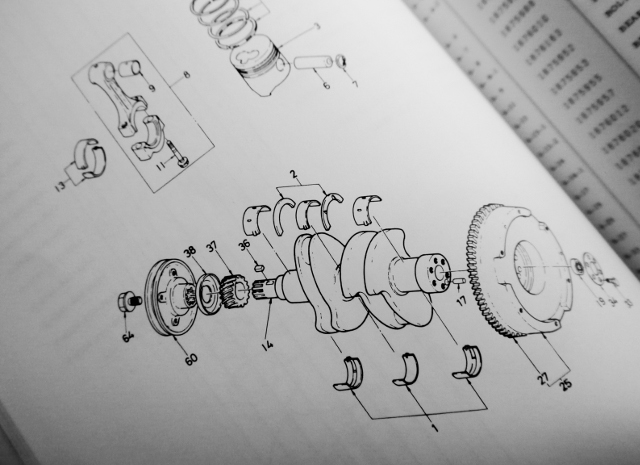

Incidentally, two cylinder diesels are usually "odd firing" which means they don't fire every 360 degrees of crankshaft rotation (although from a practical perspective one firing per 360 degrees can be considered.) One cylinder actually fires 180 degrees after the other. For a four stroke engine, this allows the pistons to travel in opposite directions as opposed to them traveling in unison (if they were to actually fire 360 degrees apart). I am guessing this is done for balance purposes, but I always wondered how an "even firing" two cylinder diesel would run - I would think a little more smoothly. Seems like all the balancing should be able to be handled by the crankshaft, but I suppose there are issues associated with the manufacturing of a crankshaft with all the balance weights on one side.

You are right about the 180 degree crank. I was thinking of my old triumph 650 vertical twin. I should have looked in my book.
