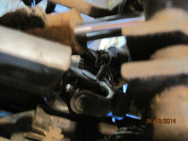

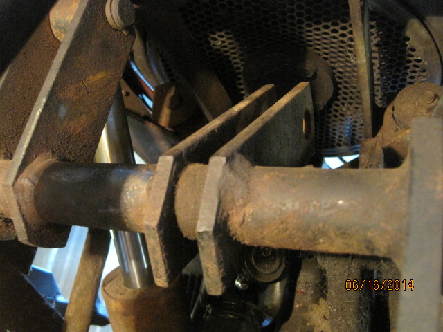

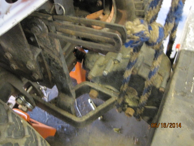

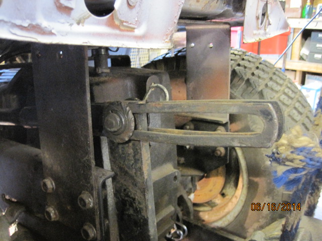

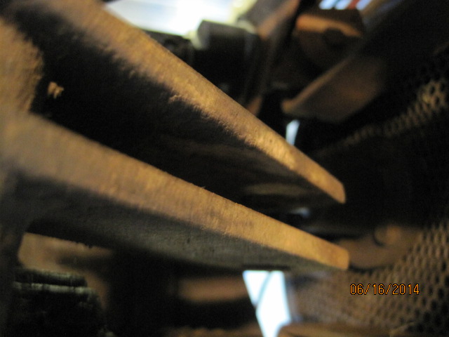

With the help of oologahan (TBN member) I was able to obtain the lift arm that connects to the tiller lift arm and the hydraulic lift of the tractor. It is a hunk of solid steel. I have purchased a BOLENS TILLER ATTACHMENT manual and have obtained the QT SERVICE MANUAL but no where is there instruction as to how to mount the "LIFT KIT" arm as the manual calls it. I tried the 3 positions that the "ATTACHMENT LIFT" allows but I am not certain where or how to connect the connector rod to the hydraulic lift mechamism. Some pictures are attached. Oh, I have purchased a QT16 owners manual, but I am not too sure it will have all the information I need.
Pictures 1 & 2: rear attachment of lift kit to tiller lift arm.
Picture 3 lift kit arm under tractor chassis.
Picture 4 yoke of hydraulic lift.
Picture 5 yoke of hydraulic lift in down position. ( I am concerned about how toward the engine is the yoke. Also my concers is that the lift kit arm is near in contact with some of the tranny hydraulic lines.
Need help before I do irreparable damage.

your pictures look just like my qt 16. should be ok just move move it slowly and watch it closely

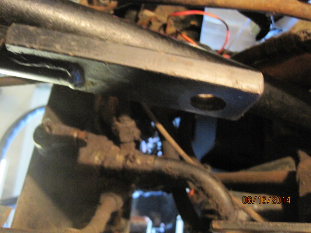

DOCROCKY: sry to hear about your engine. my engine was replaced with a Linamar lx 790 right before I bought it. so that's a good thing. after market engine maby cheaper than fixing old one about the tranny fluid mine has atf fluid in it that's what was in it when I got it. I will have to change out the same u joint soon so maby some of your threads u wrote earlier will will help me like spraying rust buster on the splines now will maby loosen it up for when I do have to change it. I also have the snow plow for mine but I have to unhook the tiller box to hook on the blade. I don't have any manuals so im kind of in the dark on that. I think I might be able to chain up the tiller so I don't have to drop to use the blade. if u have any info on that please let me know. I also seen on your picture that your missing the 2 pieces of u shaped strap iron that locks the two bottom arms of the tiller box on the pins im a new member but as soon as I learn how to ill post a picture of them thank you for the info on the u joint
