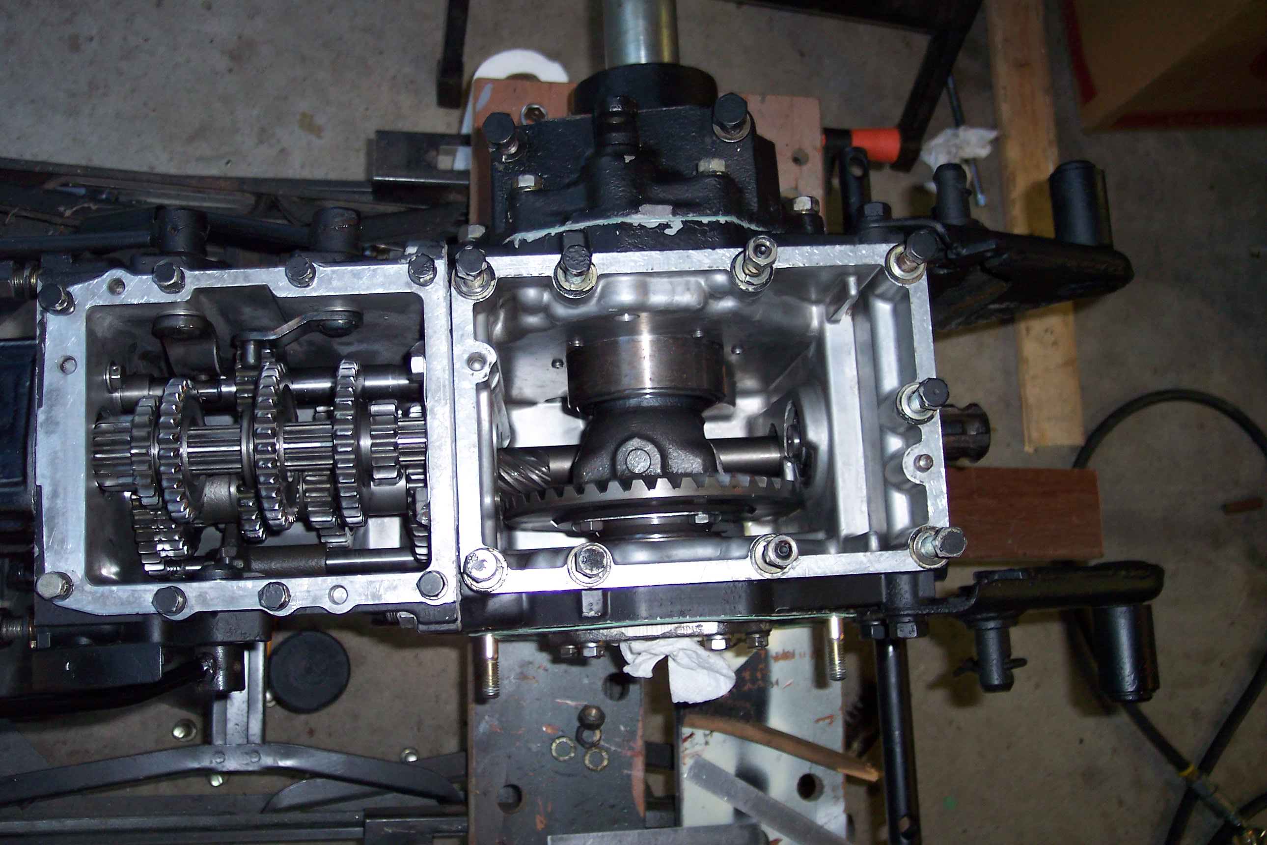

Failing that, the transmission is easy to see with lid off, but quite a lot to remove before you can see it.

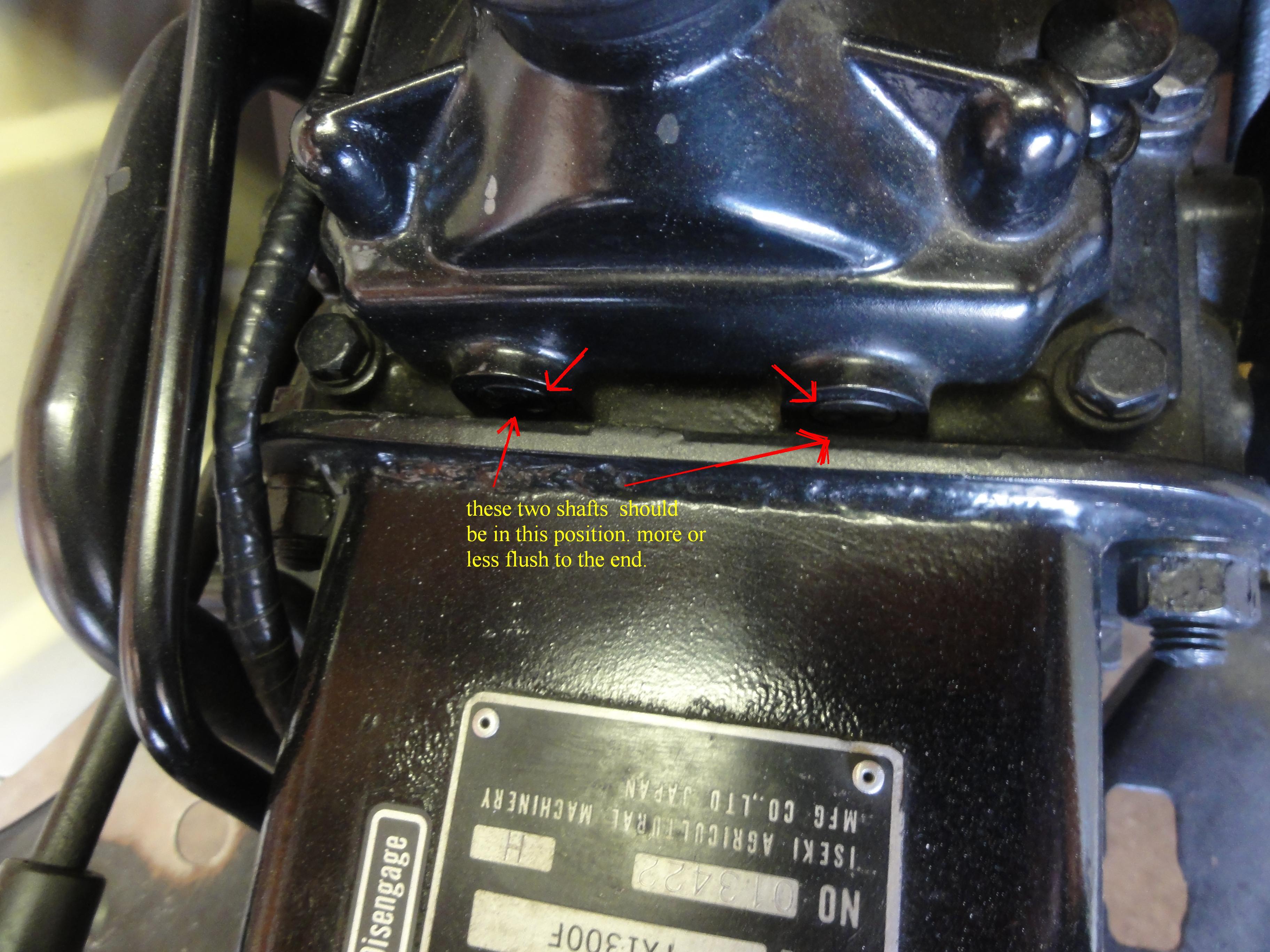

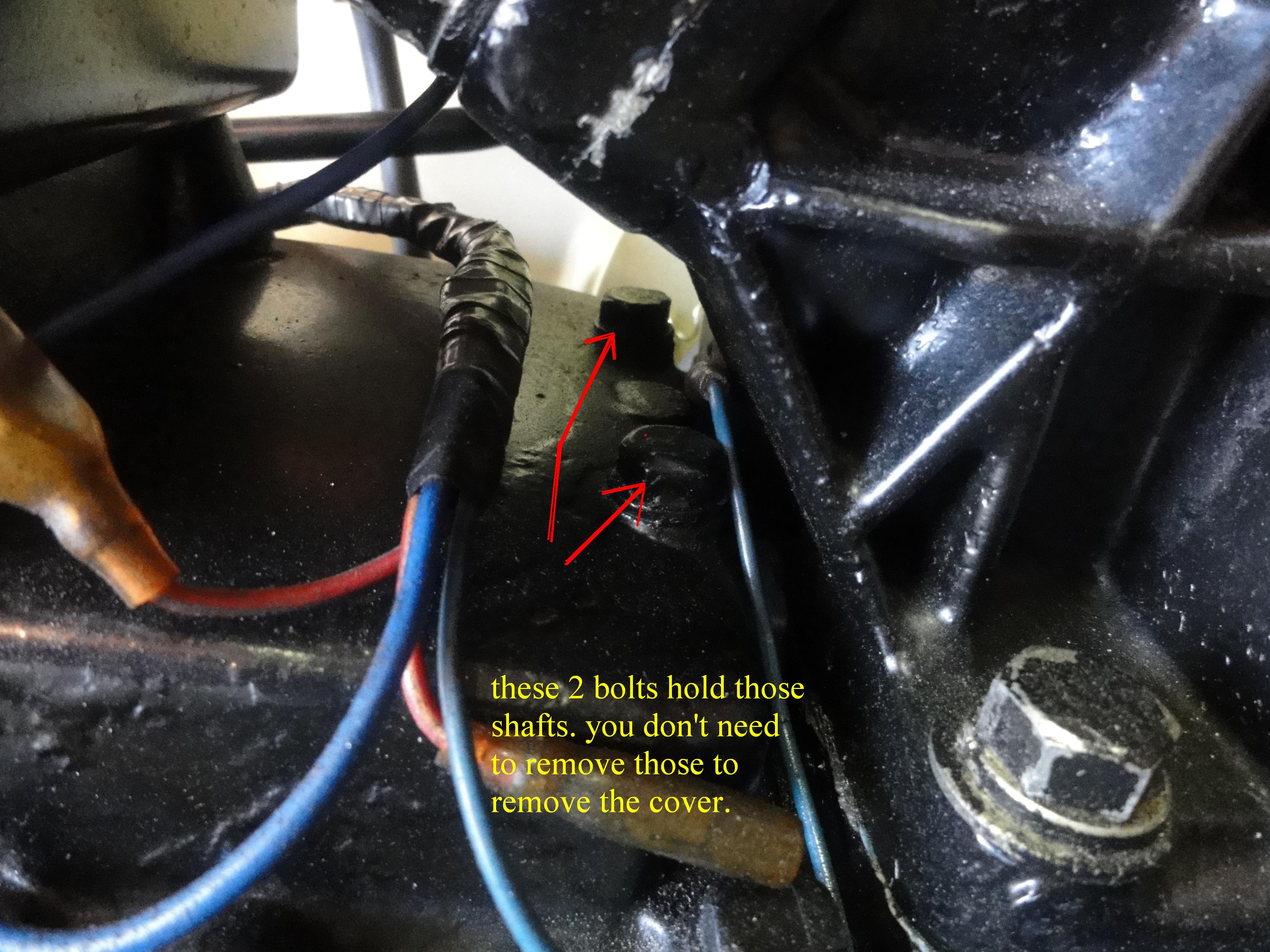

   / Bolens Iseki G174 Aux High noise #9
Out of all the pictures I have I do not have one of
the under side of of the shifter cover. The shift
forks for high/low and 1st thru 3rd are mounted
under there. They are on shafts that the forks slide on.
Check to be sure the 1st thru 3rd shafts have not moved.
pictures below.
Try putting tractor in high range and while driving
push down on the lever like you were going to
put it in low range but don't push that far.
just to see if the high/low gear is rubbing something.
push down a little at a time. also put the high/low
lever between gears and let the clutch out and
listen for noise.
Also, there is a gasket but try to remove while
using a putty knife to loosen gasket. But RTV works.
