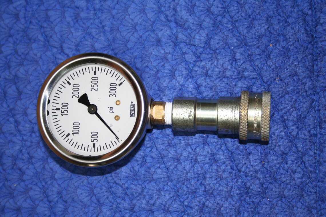

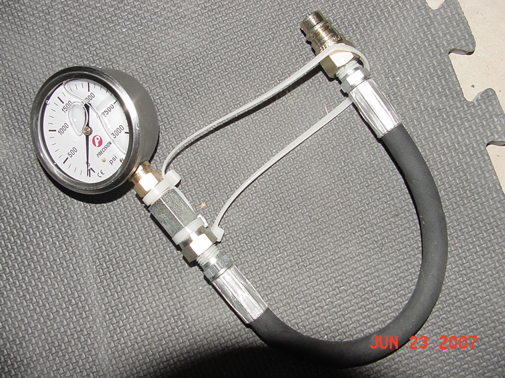

If you don't have a FEL that you could install a hyd gage, then you have to make up a tee fitting in the pressure line just after the pump, and add a male QD/Quick Disconnect. Just plug in the gage to test the pressure.

But it needs to be attached to a tee - right? You cant just send the pump into the gauge alone - like a dead end. I would have to remove and cut into the steel line and fabricate something - right?
   / Bolens H1502 with out 3 point power #4
If all you have is the 3pt, you have to cut and install a tee with a male QD.
The relief for your hyd system is at the 3pt valve.

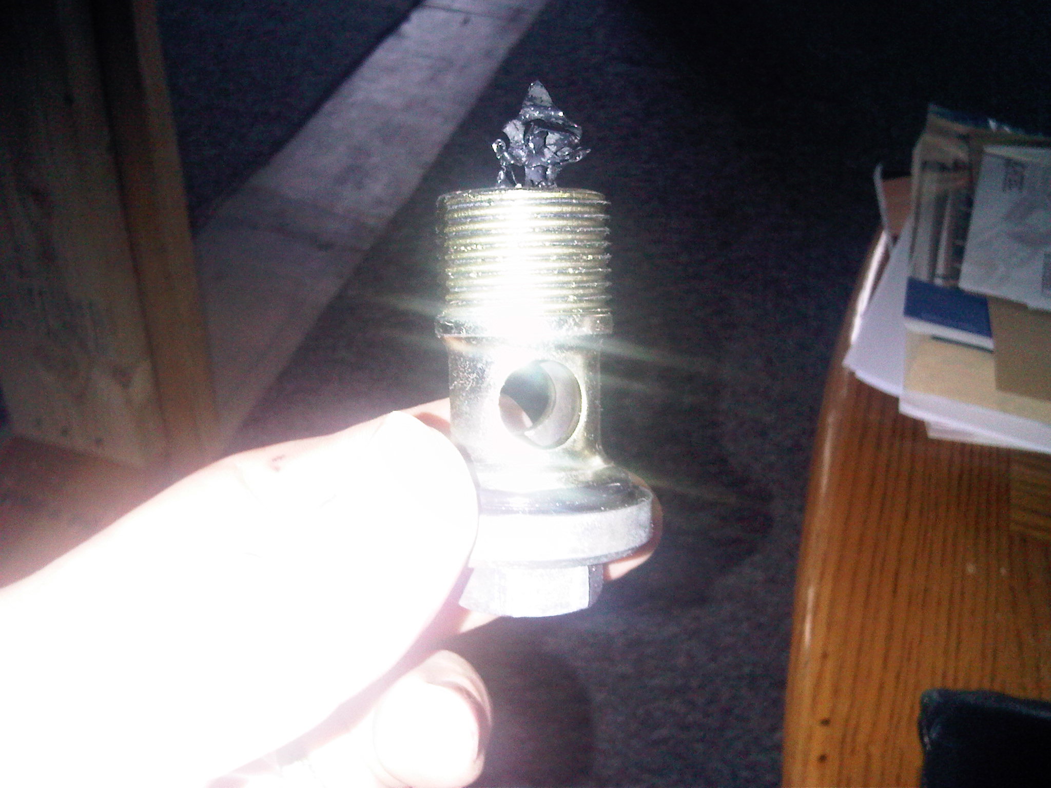

I disconnected the inlet to the three point lift gear pump - attached is the picture of what I found. The plug was ment to be a screen I think - but in the bottom, where it looked like screen was glued on, there was a big chunk of chewed up metal from something, and the screen is gone - probably sucked into the pump line.
On my tractor the three point fluid is also used as gear case oil so this might have been something from the transmission - or something that has gone through the transmission most likely. I fished around in the gear case but didnt find any more pieces.
Obviously I need a new screen - and will keep trying to fish around in the gear case with a magnet to see if I can get any more pieces out.
