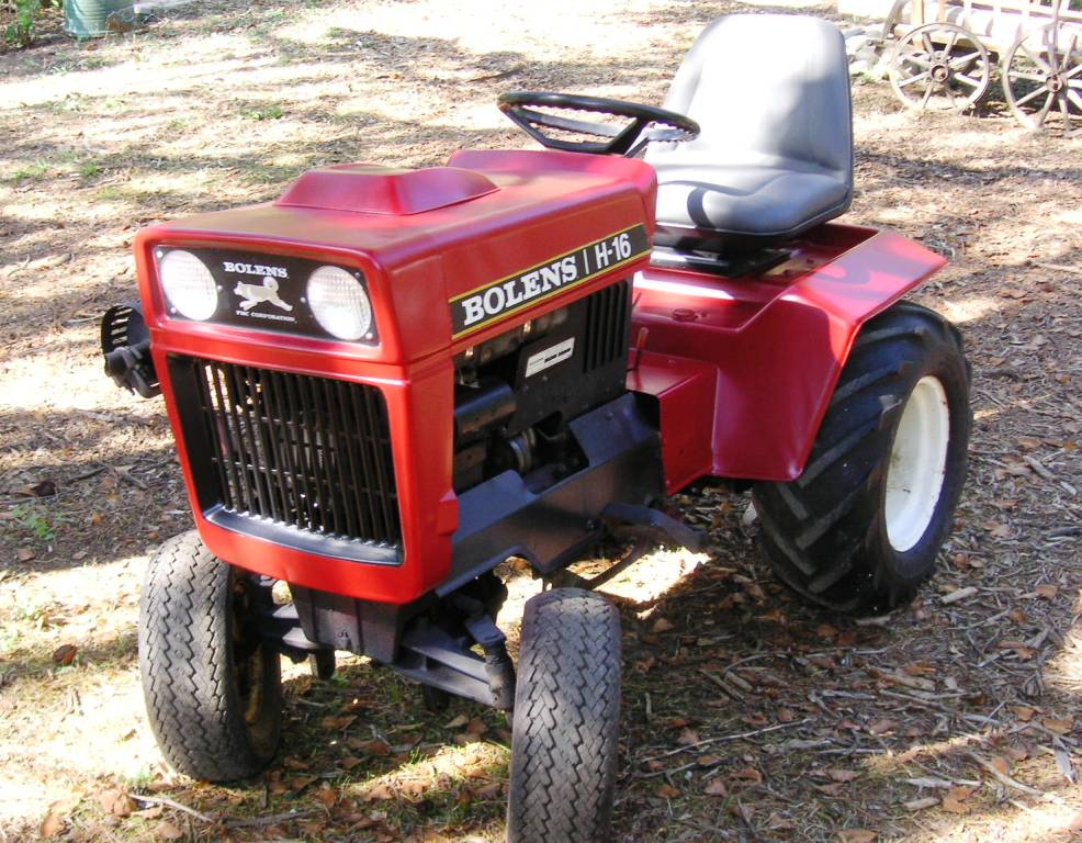

Hey guys I just picked up a G 14 with a disc and rototiller attachment for $125.00, is that a decent price? It needs some work but the seller said it was running when they parked it. The steering was frozen at the lower steering shaft bearing, I got that free today and need to buy a battery, and probably rebuild the carburetor or replace it. I could also use a detailed picture or schematic/parts list for the implement lift. Also need front tires and the dash panel is dry rotted & brittle.
   / BOLENS G14 1453 #2
Nice buy - I have one as well but not with the attachments. Strong little tractor and I love the ag tires on mine - makes it think it's a big boy. Painted it a few years ago - not white though.
   / BOLENS G14 1453
Mine's not a hydrostatic drive. I think I'm gonna try to fire it tomorrow. I sent you a PM. The left side of the lift assembly came apart at some point & I don't see an obvious way to put it back together. Maybe I'm just missing something.
I would love any info you have, Thank you in advance, Jeff
   / BOLENS G14 1453
Didn't get it to fire today, the battery had a headache so I gave it 6 aspirin tablets and put it to bed on a slow charge, maybe tomorrow the battery will feel better but I'm not gonna hold my breath, afterall its punchouts say June 2000! I did get the starter to spin on my old 6 amp charger but don't think it packs enough punch to operate the bendix, and the engine does turn, I think it will start with some gas.
   / BOLENS G14 1453
Finally fired it up today, had to put a fuel pump on it, still gotta clean up the carb, it fired right up and sounds great
