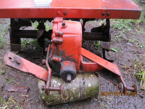

I have a yanmar 1300D 16hp diesel tractor. And I'm looking at buying a used Bolens PTO rototiller, model 19230. The tiller has a small hook up of some kind but won't fit the standard cat 1, 3 point hitch on my tractor. It looks like there is a "mini" 3 point hitch on the tiller. bottom hooks are about 10" apart, with another piece of steel at the top about 1 foot high.
Can anyone please help with these questions? Anyone got pictures on this?
Is there an adaptor for this?
Can one be fabricated?
Will the PTO shaft hook up to my tractor fine?
or do I need an adaptor, or different drive shaft for it?
Any help is greatly appreciated.
   / Bolens 19230 Tiller - to 3 point hitch #2
I think it's going to spin in the wrong direction. It's a small 15 spline shaft, about an inch in diameter. It would be difficult to find an adapter.
Your probably better of to keep searching.
   / Bolens 19230 Tiller - to 3 point hitch #3
look like this? I am looking at one.. do not know the model yet.. would this work on Kubota B7100? tiller bolens.jpg
   / Bolens 19230 Tiller - to 3 point hitch #4
Bolens used a 2000 rpm pto. At least the one I have does.
That tiller may not be worth the effort for your use.
