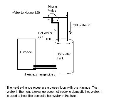

Folks,
I have a question about the topic. I have always had a gas furnace and a stand-alone hot wat heater in my prior houses. The house I live in now came with a boiler for baseboard hot water heat and a tankless coil for domestic hot water.
Well the boiler went and yesterday I had it replaced. I opted for an indirect water tank. There is a storafe tank and a pipe goes from the boiler into the tank to heat the domestic hot water.
The boiler guy set the tank for 160F which seems extremely high to me. There is a tempering valve as the hot water pipe leaves the tank. This mixes in cold water so the water at the tap is not 160F.
My question is: Do I need to leave the tank at 160F? The boiler guy said "Yes" to prevent legionaires disease from growing. Well I certainly don't have an answer for that. But in my prior houses we set the water heater to 120F and that always worked well for me. Seems like a waste of energy to heat the tank to 160F for storage and then immediately temper it down for usage.
Oh - the boiler guy is NOT my oil dealer so this is not a gimmick to sell me more oil. (Boy that sounds like I am paranoid).
As always, thanks for any thoughts or advice.
Phil

The storage tank is set at 160F but the household hot water is tempered down to 120F.
Since I am confusing everyone I will try and attach a drawing.
Phil

   / Boiler and domestic hot water tank #7
Phil,
I can't remember if it is a code requirement but most hot water boiler/tank systems are designed to run at temperatures in the 160 - 190 degree range. To set them lower casues the system to run inefficiently. The boiler will be cycling on an off to often. With an oil fired boiler, this will end up costing you much more $$ than heating the tank. You should leave it as is, this is the reason for using the tempering valve to set temperature at the tap. The disease issue is also real though not very common.
If you have a "stone" lined tank which it apppears you probably have, it is very efficient and will not be very expensive to mainttain at temperature.
Sounds like you got a good plumber

   / Boiler and domestic hot water tank #9
The other reason to do this is because it lets you purchase a smaller indirect tank. The 160 deg water mixing with cold to get you 120 (or 140) buys you about 20% more hot water from the same size tank storing water at the desired output temp.
I have an outdoor wood boiler with a heat exchanger built into the water jacket. The output water temp will exceed 160 degrees sometimes--the tempering valve is a must (and I actually have been toying with putting a second one in series as a backup--I don't want 160+ degree water coming up my DHW system!!!) FWIW, my first tempering valve failed, but it failed "cold", I couldn't get better than about 105 degree water from it.
