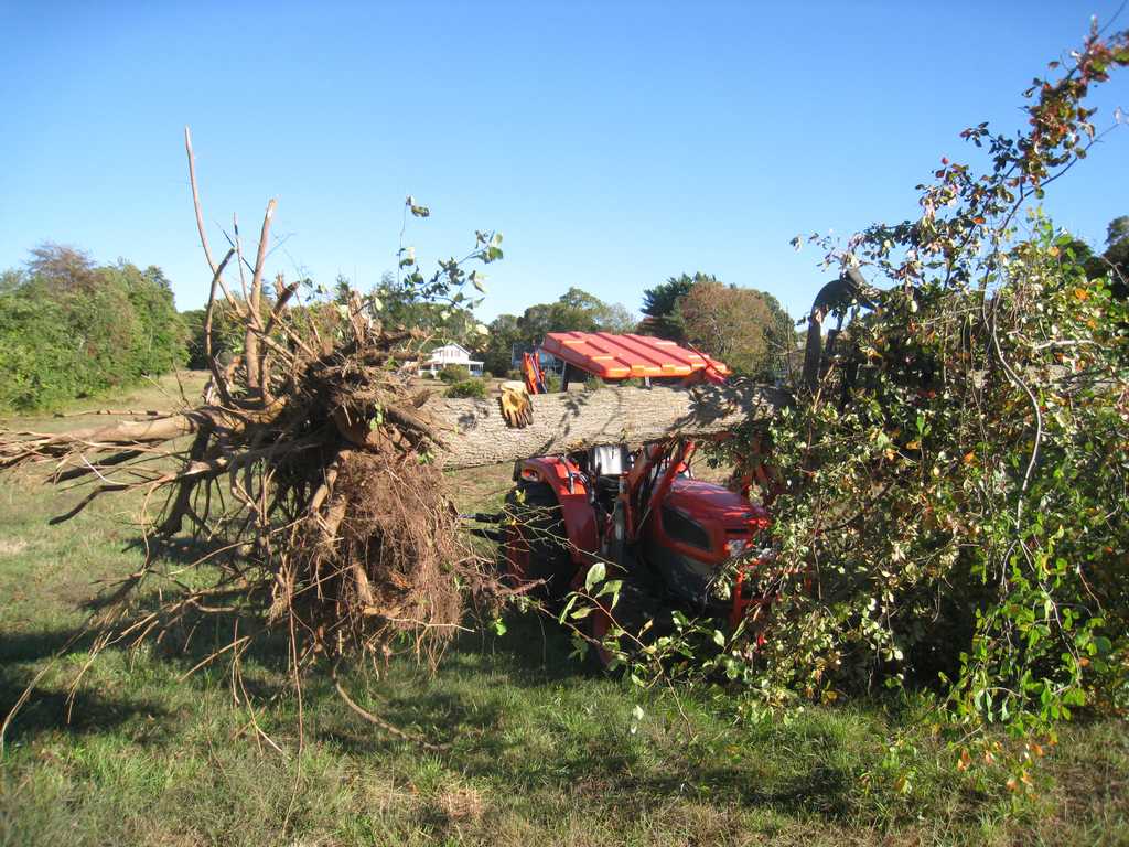

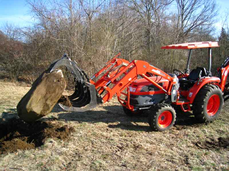

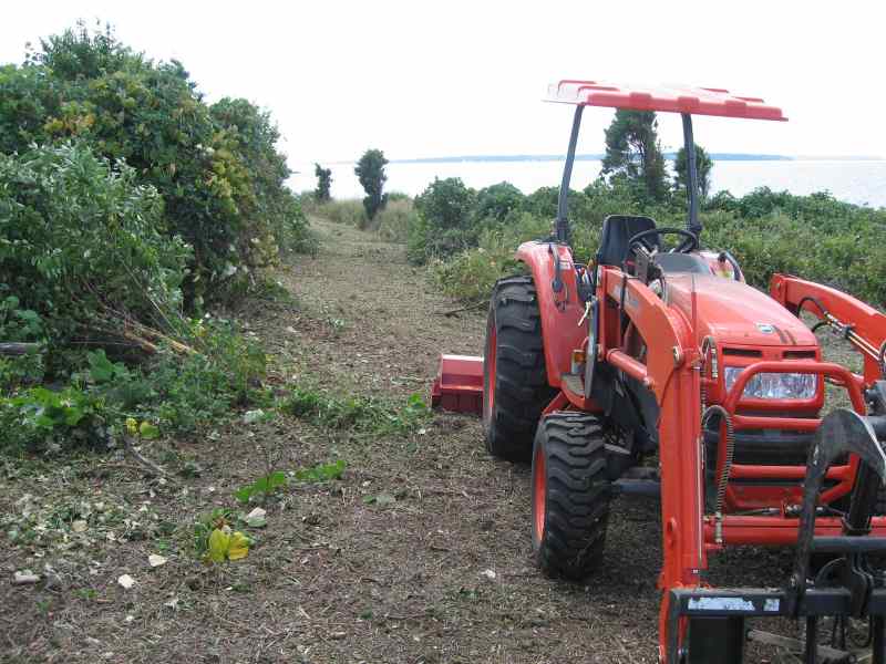

Bobcat tractors are the same as Kioti. The CT335 is a clone of the DK35se with different color paint and different loader. Bobcat uses USA made loaders from Rhino. Kioti uses Korean loaders. The tractors are as tough as any on the market and very reliable. I have 300 hours on mine and it has never been back to the shop. Two warranty items: 1) seat belt retractor blew up on the first day, 2) fuel bowl cracked after a couple of years. Starts with first crank and loves to work.
The DK35se (CT335) is a smaller version of the DK40se I have. Before you commit to the CT335 check out the CT440. Not sure what the price differential is with Bobcat but it is a couple of grand with Kioti. For that you get massively bigger front and rear axles/tires and a four cylinder 41hp engine instead of three cylinder 38hp. The operator station is identical as are the other main features. Biggest difference though is in the loader: because of the bigger axles, the loader capacity on the Kioti version virtually doubles to 2700lbs lift. I believe the CT440 loader is pretty close to that.
IMO the DK35se is perfect for mowing with six foot implements and running other six foot impliments like tiller, boxblade, etc. The bigger brother DK40se runs the same implements, it just takes the loader work to a different level.
They are excellent tractors. Tough and reliable and well designed. Many deluxe features such as standard rear remotes, 3PT controls at back of tractor, flexible 3PT linkage, draft control, electric over hydraulic PTO and 4wd etc. Not sure of the JD equivalent but more like the Grand L Kubota. Not as light as a Kubota or JD so better for field work than lawn work. Excellent bang for the buck, savings of $5000-7000 compared to equivalent Kubota/JD models.
