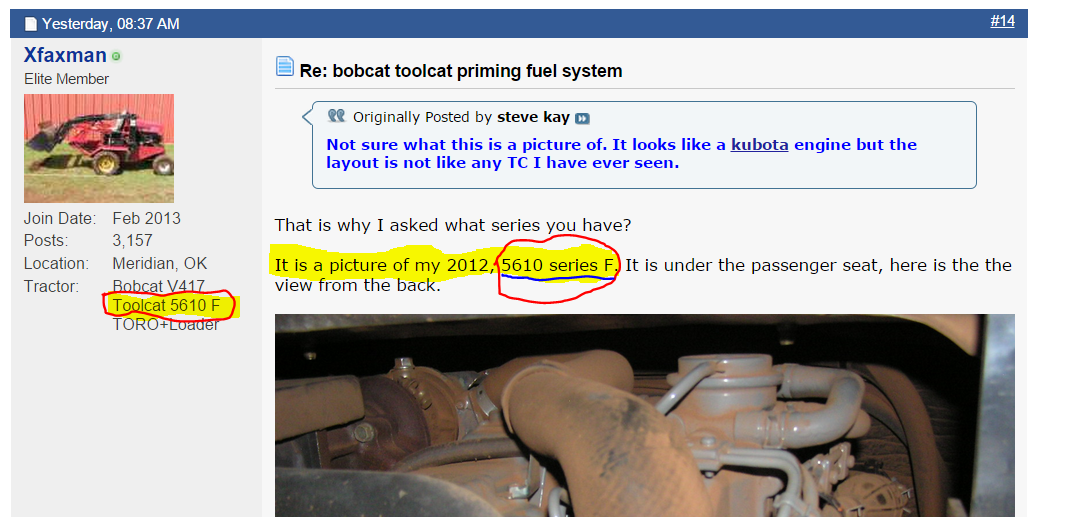

What series is your Toolcat?
Mine is series F, haven't run out of fuel, never used the primer bulb, visible at the top in this picture.

Not sure what this is a picture of. It looks like a Kubota engine but the layout is not like any TC I have ever seen.

That is why I asked what series you have?
It is a picture of my 2012, 5610 series F. It is under the passenger seat, here is the the view from the back.
/\ That is the muffler. /\
And the Toolcat moving dirt to fill a low spot.

I GUESS I HAVE AN ANTIQUE TOOLCAT. I DO NOT BELIEVE THERE WAS A SERIES IN 2006. ONLY OPTIONS ON THE SINGLE CHASSIS/BODY STYLE. I'm GUESSING THE MECHANICAL LAYOUT IS QUITE DIFFERENT IN SUBSEQUENT VARIANT SERIES. BTW YOU HAVE A VERY USEFUL LOOKING IMPLEMENT.
/ bobcat toolcat priming fuel system #16
... AND IT APPEARS YOU HAVE A 5610, NOT A 5600
