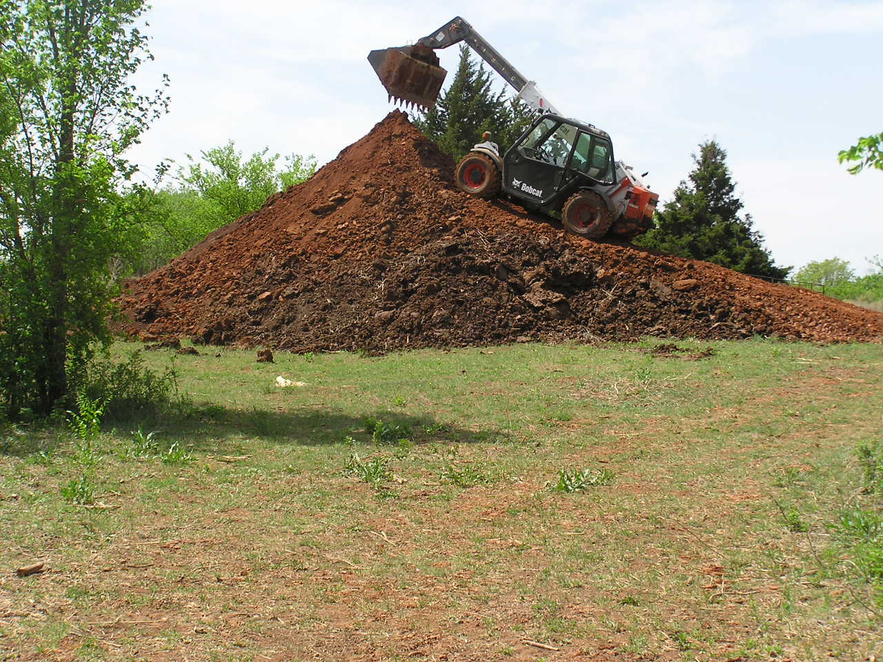

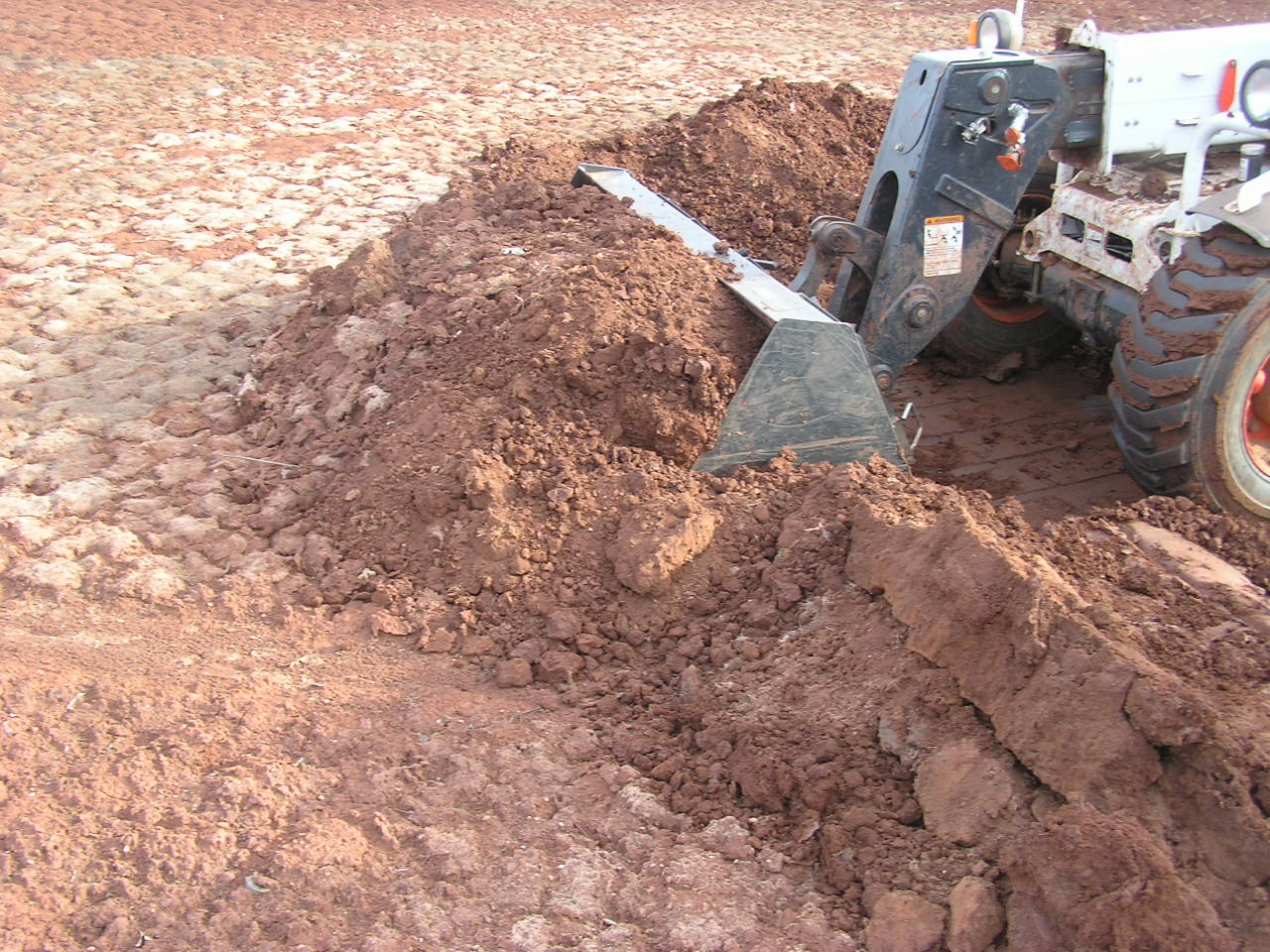

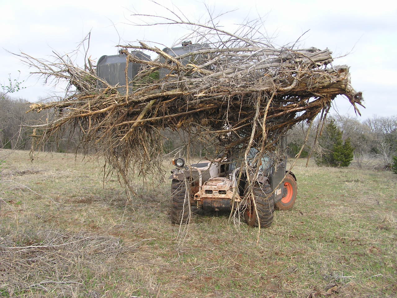

My compact telehandler will out work a skid steer for digging and everything else!

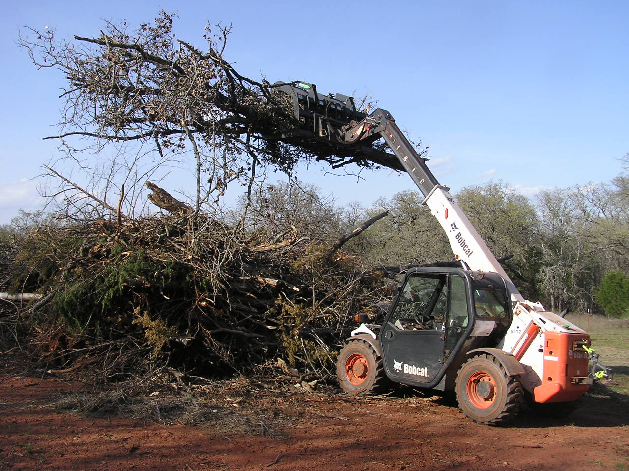

With a grapple.

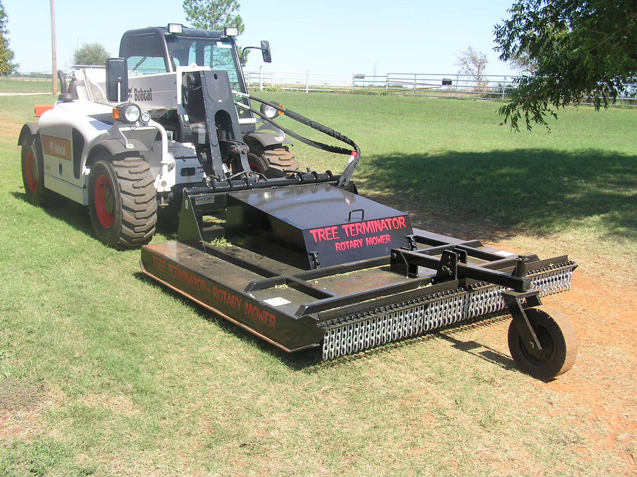

With a 7' brush hog.

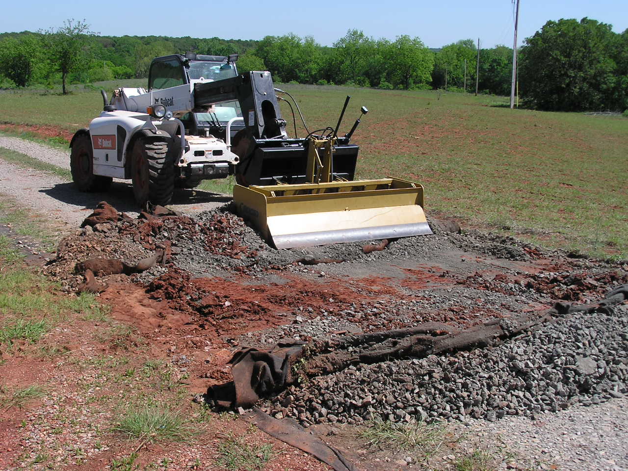

With a 6' boxblade on a three point adapter on a tilt-tach
Check this thread: http://www.tractorbynet.com/forums/...t/160568-compact-telehandler.html#post3243370
   / Bobcat S150 skid steer vs. bobcat or kukota tractor...
Wow.. That is one amazing rig you have there! Wish I could afford half of what I see there. Really "versatile" as the name implies. Thanks for the idea. It does widen my horizon.
